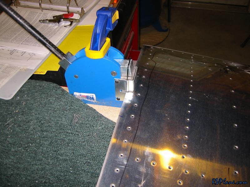

I took care of the gaps on the forward edge of the canopy skin with a metal shrinker. Worked PERFECTLY.

Mail that thing to me so I can use it! Mr. Green

I wish I could! I ended up borrowing it from a local -7 builder who bought it for the same reason! Those suckers are EXPENSIVE! Maybe you could find a place that rents them?
