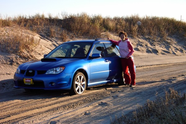

4) If you shop around you can buy a brand new 2007 Subaru car, WRX, turbo-charged 238 hp, 4 wheel drive for about $23,5k and still have money left over to buy a Lycoming core, and rebuild it, before you match the price of and Egg conversion.
5) Your wife will be happier with a newer car :mrgreen:

Sweet pic of the WRX!!

The Subaru is a blast to drive especially on small twisty roads, but it's the acceleration and handling that are it's strength. It's not a constant speed work-horse, especially with the turbo spool up.
