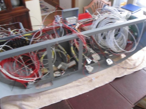

I can't stress enough what Mike mentioned about service loops. I thought I put adequate service loops in place when I wired my panel. I did it on the dining room table. I thought a few inches in front of the panel would be adequate. It should have be at least a foot. I have a RV-10, so YMMV on a two seater panel. I also swapped out all the little slotted DB set screws with thumb screws from SteinAir. It makes removing the DB connectors much simpler.
The photo looks a little messy, but those are the pigtails that go to other places on the aircraft.
