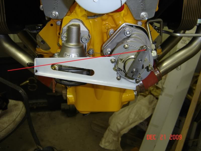

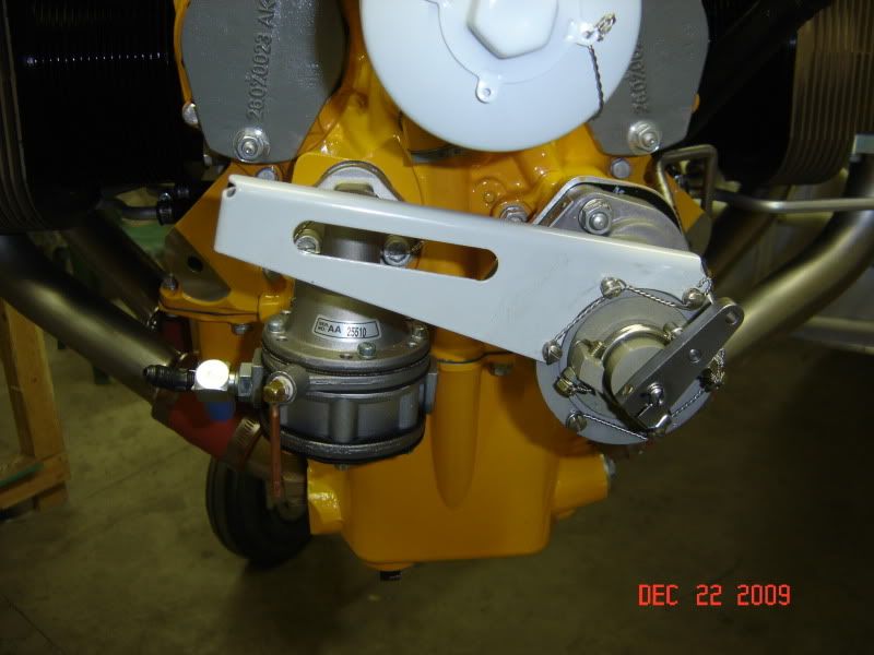

Prepping the engine today and got to the governor bracket. I think this bracket was designed for a Woodward governor, so had to hog out the holes and grind the ID of the bracket to fit the PCU 5000. Also had to loosen the screws and rotate the arm to clock it properly for cable attach.
Couldn't find any pics of the bracket installed, so hoping someone else will see this and tell me if it looks right.

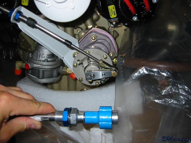

Brian,
My prop governor looks a little different:
Here is my builders log entry for the day I installed it:
http://rvplane.com/?categoryid=6&dayid=619
mike, yours was the only picture I found. My bracket is the other style and seems to work, but not sure the angles are correct.

I looked at my FWF and the location of your bracket shouldn't present you with any interference issues. The only things it would get close to (at least on my setup) is the breather tube and the fuel return line. But like I said, you should be fine.
Here's what I'm worried about. The angle of the cable to arm is shown with the red line.
it looks as if the bracket is set up for the arm to be in the 4 o'clock position and move towards 8 o'clock. But this would be reverse acting.
Something is goofy.

Do you have your mixture cable? Oh thats right you are going with a custom quadrant on the left side right?? The only way to be 100% sure is to have a cable handy to test with. I agree it looks a little bit like it should be actuating the arm 180 degrees from where the arm really is. But that could be fixed by bending the portion of the bracket where the prop cable comes through it. You might need to just hang your engine and worry about it later. Getting the prop governor off and on shouldn't be too too bad.
bullojm1 wrote:........ But that could be fixed by bending the portion of the bracket where the prop cable comes through it. You might need to just hang your engine and worry about it later. Getting the prop governor off and on shouldn't be too too bad.
Well that's the plan. We're hanging the engine tomorrow.... unless I don't wake up.

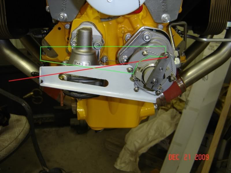

Update: found a reference which showed the bracket should be installed like the green lines on the below drawing. Then the cable is routed thru the slot in the bracket. This will work but then put the rod end and arm at a funny angle. Oh well I'll deal with it later

Here is the proper orientation for the prop governor bracket.
