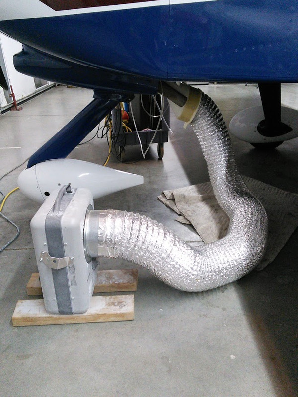

I made a heater from a camp stove. I've used it a couple times in a pinch. Once on a fishing trip to Michigan and another time that I can't remember where I was. I later printed a base with a wide flange for the propane tank and duct capture to better stabilize. it is relatively light and compact as the ducting compresses and the stove and tank fits inside. you don't want to have any fuel leaking around because there is a fire underneath the aircraft. :o it is only able to take the edge off the cold, but I don't believe I would have been able to start the engine without it as I have no primer system. on that day, the Money beside me had ice in his tanks and was stuck there. hey, ice is not nice!
this is my standard hangar air pre-heat for the past 10 years.

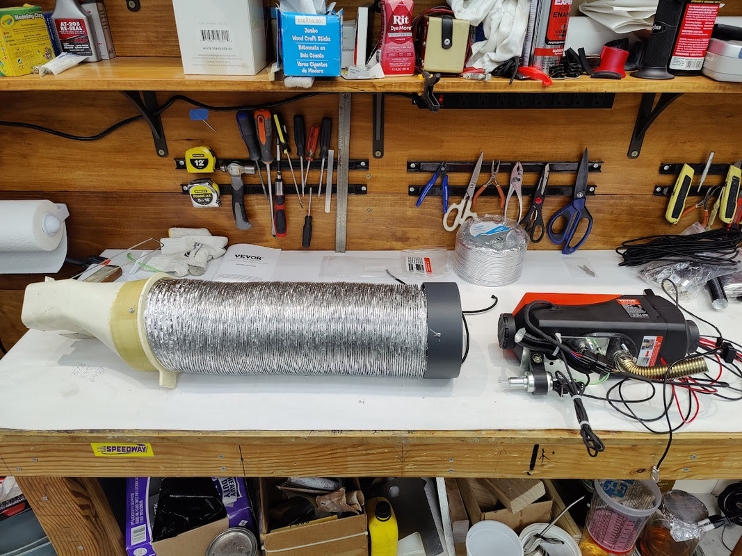

well, apparently the 5KW is sold out. so, I purchased the 2KW version. a smaller heater operating at maximum may work better for AVgas. the spec weight is 11# but has a smaller overall dimension (4.5 x 5.5 x 13.5 inch) than the 5KW. I am looking at a printed duct to adapt the diesel heater to my current 6-inch ducting that works with my cowl adapter that is very secure. I plan to use AVgas from the aircraft for fuel and electrical power from the panel cigarette lighter. the duct adapter (6.5-inch overall length) will be printed using nylon/carbon fiber.
one thing I discovered using my previous propane camping stove preheater version is that there can be a wind and that should not be an issue with this setup as the diesel heater is 11 lb. as I understand at this time, these preheaters can operate side mounted. I plan to lay it on the ground.
for a 30 minute preheat, I should not use more than 2 amp-hr from the aircraft battery. my battery specification is 24 amp-hr. a warmer battery results in increased cranking amps. warming the battery could result in increased electrical power for starting vs a cold battery.
my goal for this preheater is to be able to remove it from the aircraft and be setup for start within three minutes at a relaxed pace. preheat time estimated to be 30 minutes.

2634 grams = 5.8 lbs, it's light weight and I like that. an engine preheater when you are on the go.
plan for a 3-minute setup: drop it on the ground on its side, drop a fuel bung in the aircraft gas tank, plug it into the aircraft cigarette lighter, connect the duct and press start.

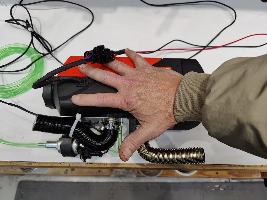

Re: Reiff Hotstrip sump heater

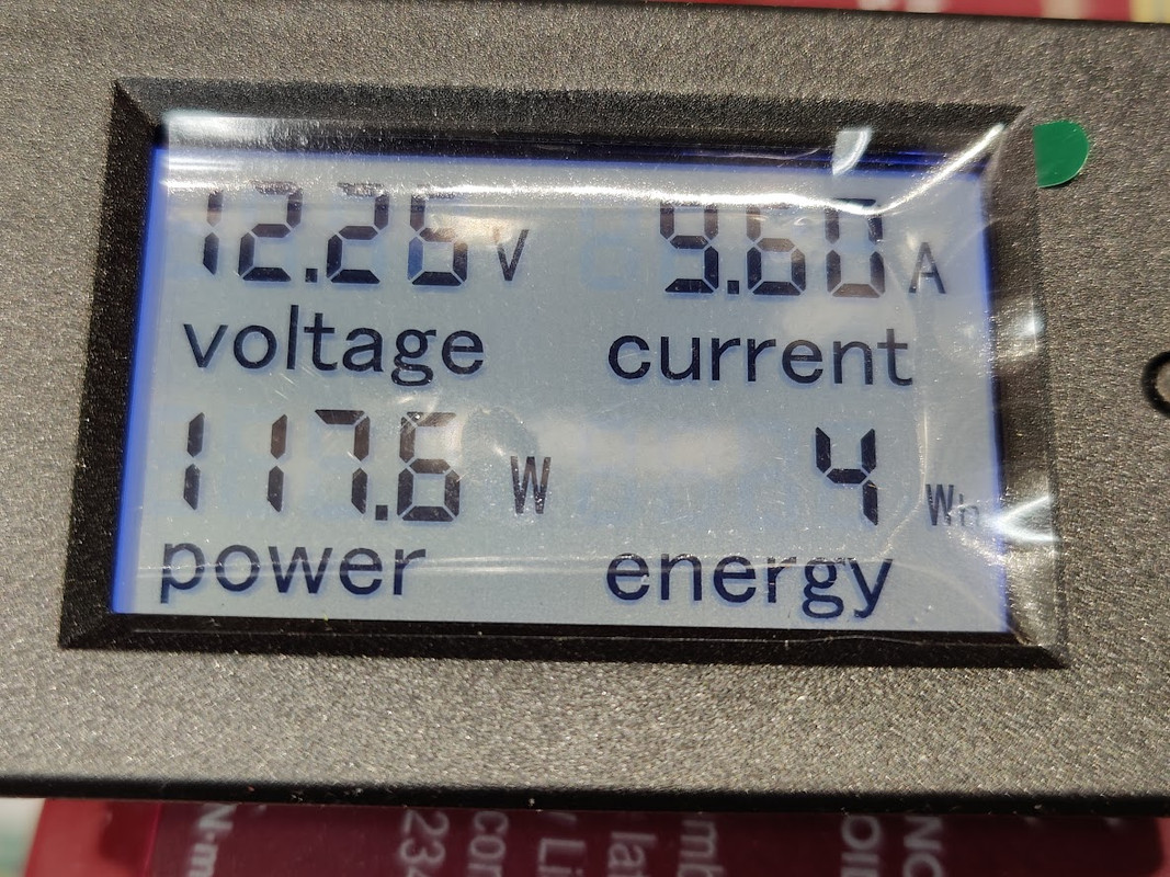

configured to be compact and portable. I am really happy with this. good heat, efficient, 800 cc per hour or so. max current draw at start = 10 amps (glow plug), running = 2 amps, total Wh for 30 minutes = 18Wh on 12V, so that's 1.5 Amp-h, not much! my Concorde battery = 24 Amp-h capacity. now we have easy preheat on the go at remote sites using aircraft fuel and electrical power in a compact unit. unit weight = 6 lb. on track for a 3-minute setup time (or less) for preheat!
I opened the cowl to measure how much wire I will need to connect directly to the battery = 5 ft. I will use a 15 Amp fuse. The 3D printed spark plug wire baffle seals look good and are tight. I will use the same material to print a duct adapter for the preheater.

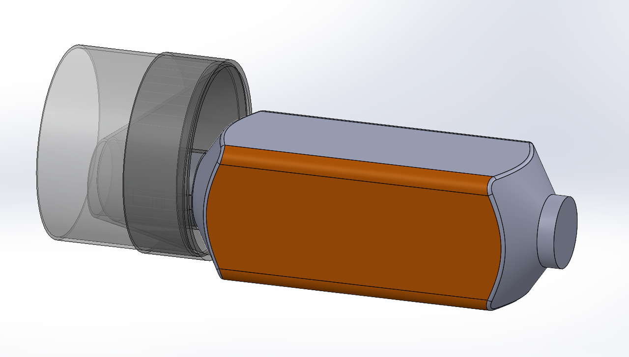

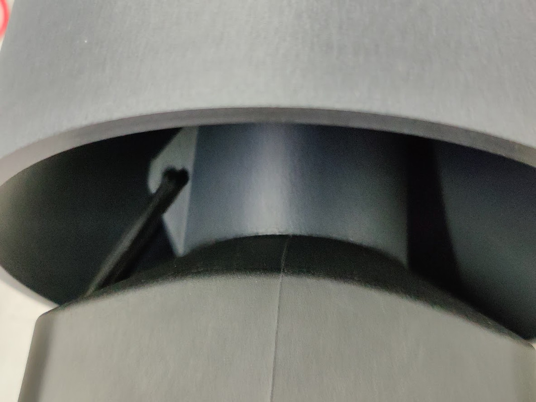

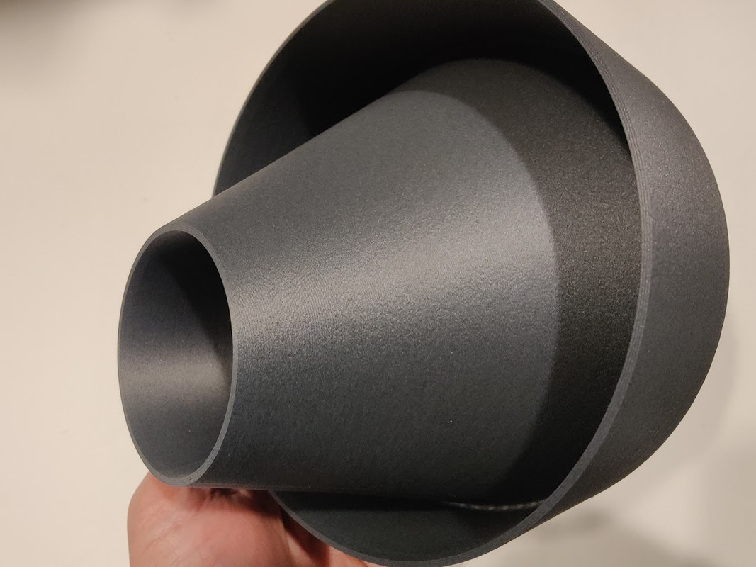

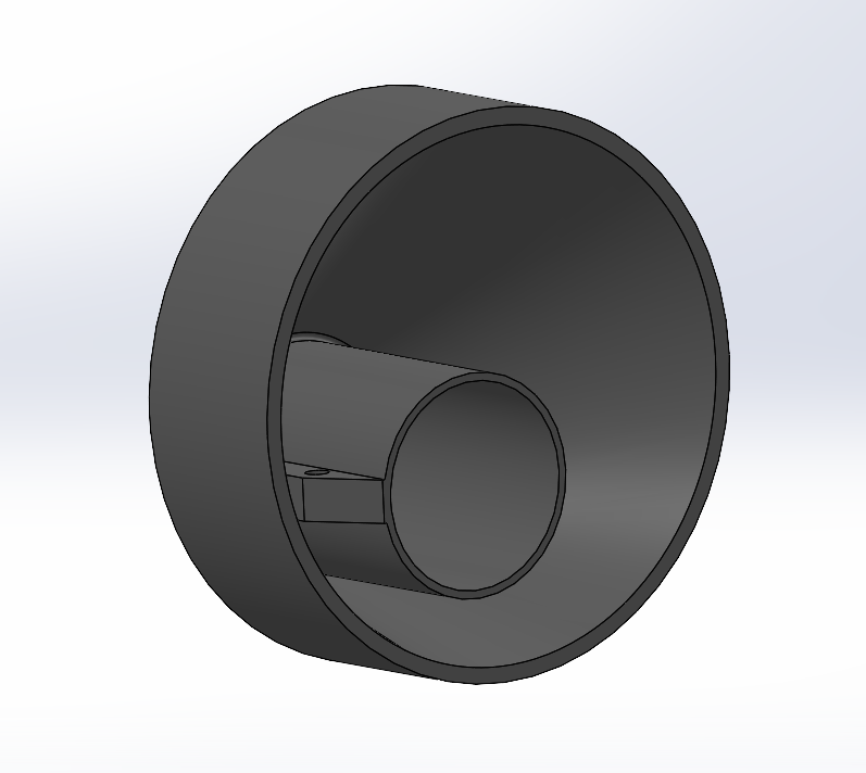

well, I took 2.5 inches off this duct adapter. it's beefy because I'll probably be banging it around. I hope it works. I plan to use a simple bungee to hold it in place because when it's cold you don't want to mess with small clamps.
and yes, I thought about a flat plate to connect the cylinders, but when you have a flat plate with a temperature gradient, it will fail. better to use a cone shape.
the previous duct adapter considered...
the current duct adapter that is being printed.... nylon/carbon fiber because it will get hot.
Posts: 2082
well, that was too easy. perfect clearances and fit everywhere for the duct adapter. it's probably too robust but hey, I only want to do this one time. the duct adapter max temp = 300F. the bungee idea to quickly connect the duct adapter to heater is going to work even better than I thought. it will make for a quick setup. this entire project is almost done and has been quick and fun. remaining is to run a wire from the aircraft battery to the oil door for quick connect. relatively light weight and compact on-the-go preheat anywhere, using aircraft Avgas from the tank and electrical power from the aircraft battery. total weight for everything should be less than 10 lb, and setup, ready for preheat start in less than 3 minutes at a relaxed pace.
note: after printing this piece, I reduced the weight by 1/3 in a revised design.

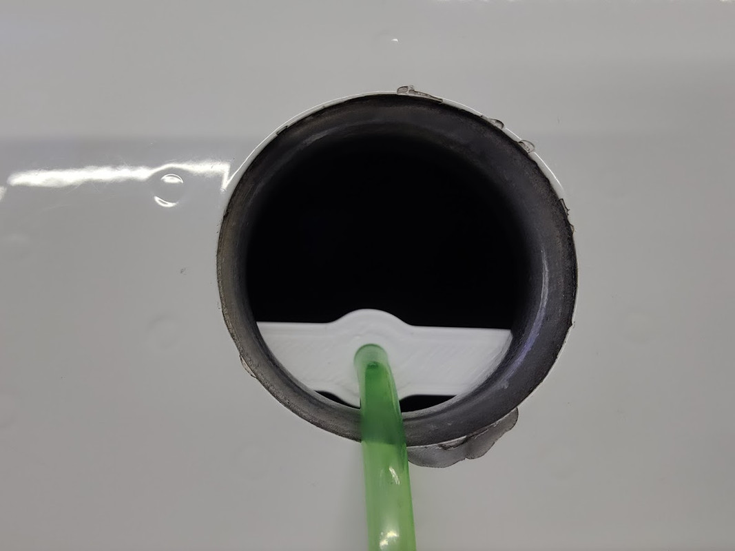

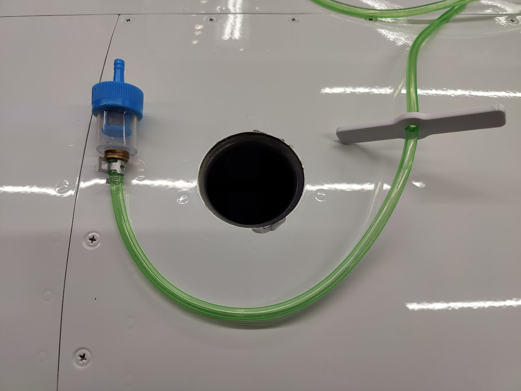

engine preheat from the aircraft fuel tank test 1.
the paint chips around the fuel cap are from the line boys digging the cap out with their pocketknife's. I've seen them do it.

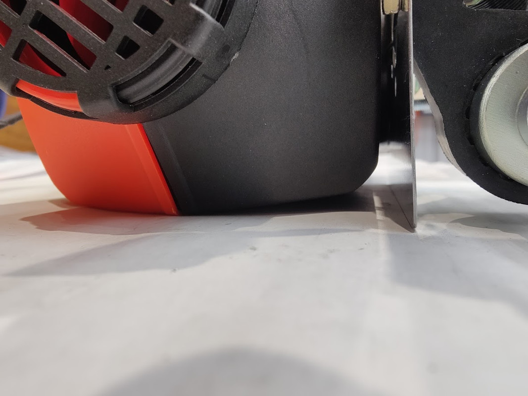

2KW diesel heat fuel line retainer.... a risk with this setup is a fire. the highest fire risk is the 1/4" silicone fuel line getting blown by the wind against the exhaust pipe. the exhaust pipe is hot enough to burn through the silicone fuel line and auto ignite the fuel. upon a line burn through, the fuel would be continuously gravity fed to enlarge the fire. a simple swing arm fuel line retainer may be beneficial. when you need preheat you may also have wind.
