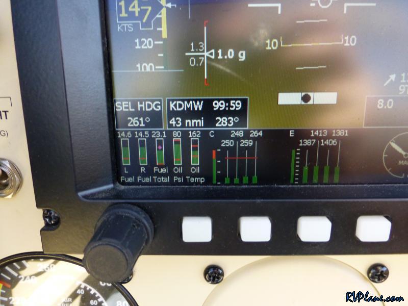

I recently moved my oil cooler shutter from the rear of my oil cooler to the front (Thanks Bruce and CJ for the detailed pics!). I did a recent flight in and noticed my CHT's were cooler than normal - 250, 248, 259, 264 (OAT was 25 degrees F).
Is this something to be concerned about, or am I worrying about nuttin'?

Lycoming documentation says minimum CHT's are 150F.
Was this with the oil cooler open or closed?
I think you are fine with CHT's at 250F. More margin against any detonation!

Nope... Nothing to worry about. Eci says the cooler, the better!

These temps are with the oil cooler shutter closed. For for affirming that these temps are still within a reasonable range. Too often I hear of people running in the mid 300's as their normal CHT's. I suppose I've been lucky to never have high CHT's once I sealed off my baffles and plenum.

I see that OAT was 25 degrees f. Chilly!
Those are great numbers!

24 squared (75%) and leaned back to 8 GPH. I'm pretty happy with my numbers! Now all I need to do is get off my lazy arse and fix my heavy wing. I have a feeling it's costing me 10 kts in cruise.
