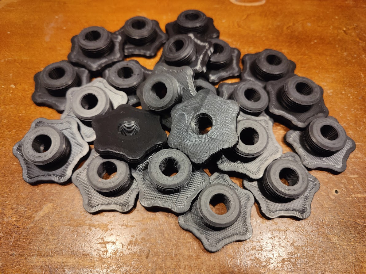

Re: A couple printed widgets
It’s that time of year again—engine oil filler caps for the dehydrator attachment. I printed these yesterday after running out of stock. They feature 1.25-inch OD threads and 3/8 NPT (pipe) thread ID, and are mid-process, ready for cleanup and o-ring installation.
