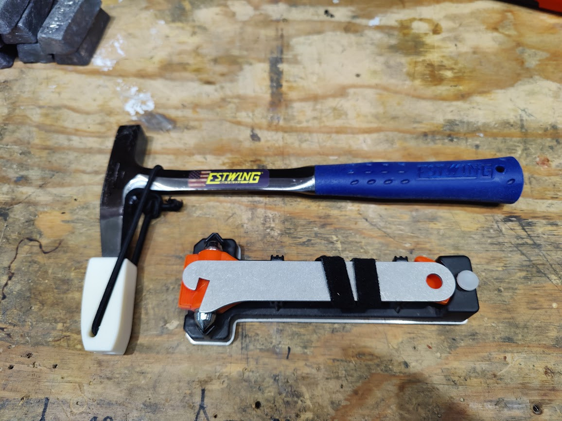

OUDEW canopy breaker mount successfully tested to 40g in all orientations in sequential testing except upwards, as that orientation was difficult to set up. Testing to 24g was straightforward, but achieving 40g required mount design and print-style adjustments. The 40g test involved a 10-foot (120-inch) drop onto 3 inches of foam. 120 drop distance/3 stopping distance = 40g. Guides were used at the top to ensure a straight drop, and a lanyard string helped contain any subsequent bounces. I can only estimate the upwards g capability at this time, but I believe it could meet 24g.

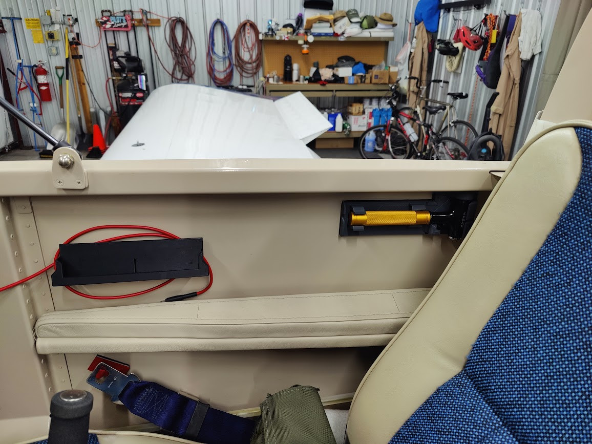

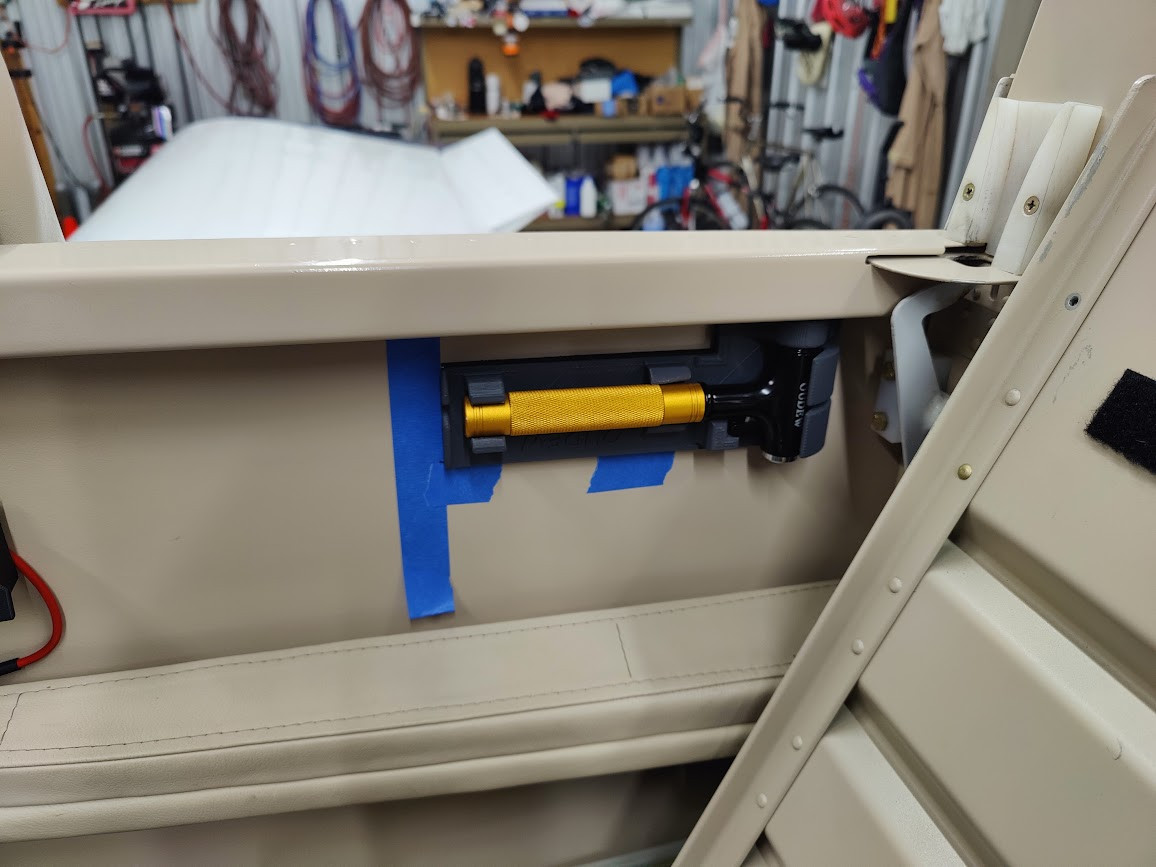

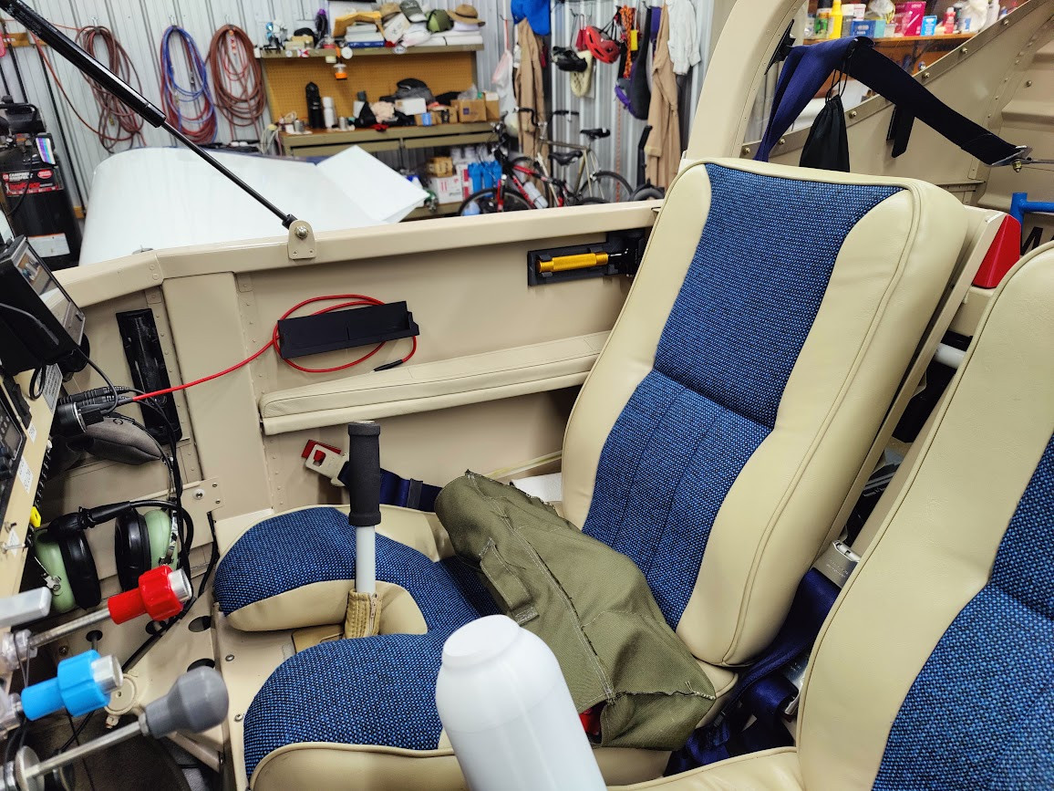

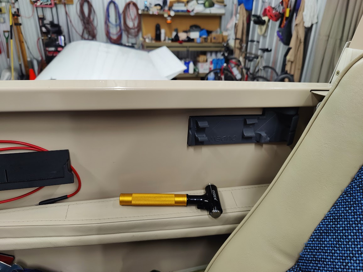

After considering canopy breaker placement, I located it near where canopy breakage would likely be needed. Given the likely orientation of being upside down, I oriented the removal direction downwards, so it will be upwards when upside down. I removed two other canopy breakers from the aircraft for a net weight savings.
The canopy breaker mount I used was the same 40g test specimen because it was in excellent condition.

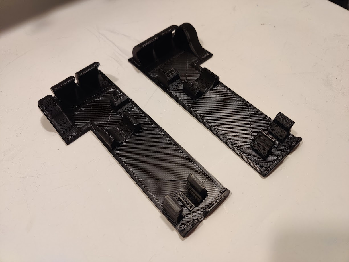

OUDEW canopy breaker mount, black, mirrored options for placement. Left or Right Hand.
