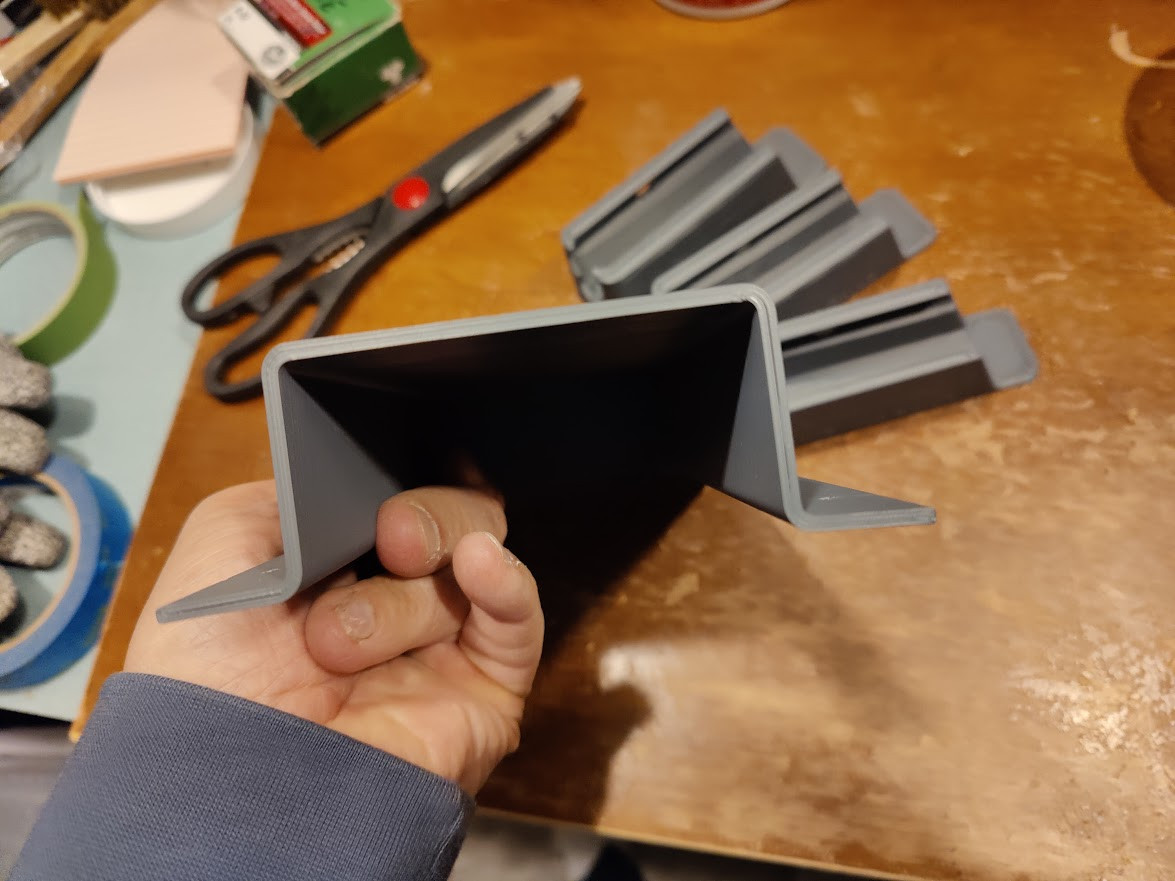

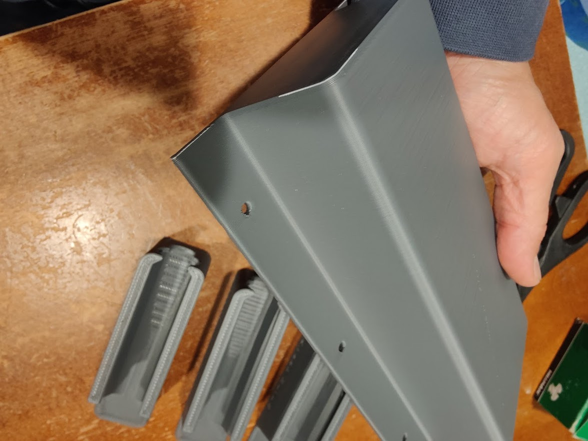

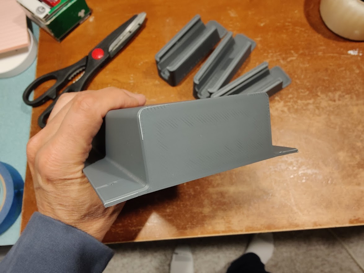

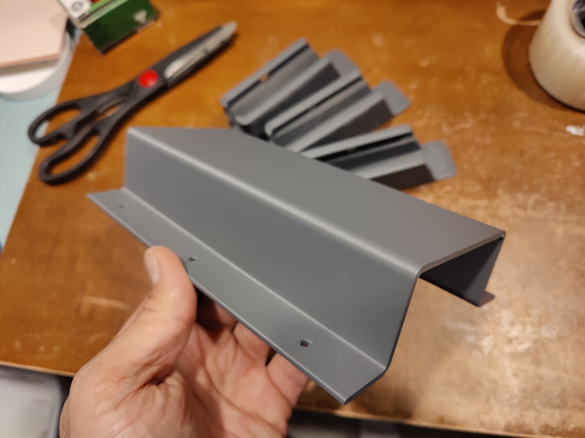

I am currently in the process of designing a fuel filter cover for the floor tunnel on a carbureted model, following a specific request. While I previously fabricated a similar cover for my own aircraft using aluminum sheet stock, the process was quite time-consuming. Utilizing 3D printing for this component would certainly have expedited the manufacturing process. I have incorporated a slight angle into the flanges, consistent with the design that resulted from the slot-cutting process on my original version. This one is one inch longer than mine, which I believe will be beneficial.
not too bad but could be better...
