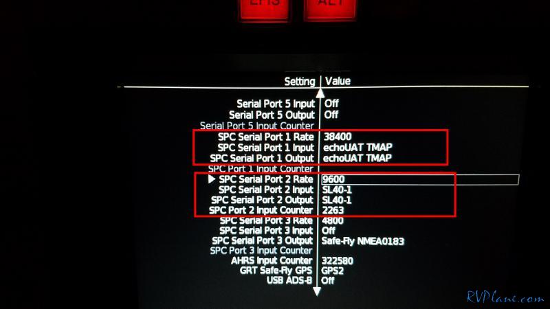

The current hurtle I am experiencing is that my Safefly GPS that is coupled with the Echo is not playing nice with the EFIS. I’ve configured it to communicate on serial port 3 and have the baud rate configured per consult with GRT. The setup instructions say to set the baud rate at 115200, but after emailing GRT, the apparent correct rate is 38400.
Still, after correcting the baud rate, no joy. The serial in data counter for serial port 3 is ticking over, but the data isn’t making it to the display. I’ve checked all other settings to the best of my feeble ability, but I can’t figure it out. There are 3 wires coming from the Safefly/EchoUAT (other than power and ground). One is for Ads-b data, which I have going to port 5 at 115200 baud, and two are for GPS in and out, which I have on port 3.
Not that I’ve ever done anything stupid or anything like that, but I’m wondering if I could have switched the in/out wires. Out from the Safefly/EchoUAT going to the out from the Sport SX.
I have an email, again, into GRT and should hear back tomorrow to see if that is a possibility before I take things apart. They’re probably going to say, “Oh jeeze. Not THIS guy again!”

Painless,
Here are the settings I used:
115,200bps was the correct speed for my setup
On the serial port combiner (SBC)setting, 38400 is the correct baud to talk to the uAvionix box.

Yeah, I saw that Mike. Can’t figure why GRT is having me use 38400 baud. Talked to them today and apparently since I have an internal GPS that is designated at serial port 3, I can’t use that port for Rx/Tx of my Safefly. Who knew??! Also confirmed with them that I am to use 38400 vs 115200. I’m going to do as the Mother Ship instructs and see how it goes. If 38400 doesn’t do it, I’ll do as Bullock does and switch back to 115200.
So I’m off to the airport tomorrow to switch the Safefly from port 3 to port 4.

Houston, we have GPS! Switching the GPS to serial port 4 (getting it off serial 3) did the trick. I set the baud rate to 38400 as instructed by GRT, but no joy. So I did the Bullock and went back to 115200 and voila!
Long Live Mikey! Now I suppose I'm going to have to buy him beer for life.
