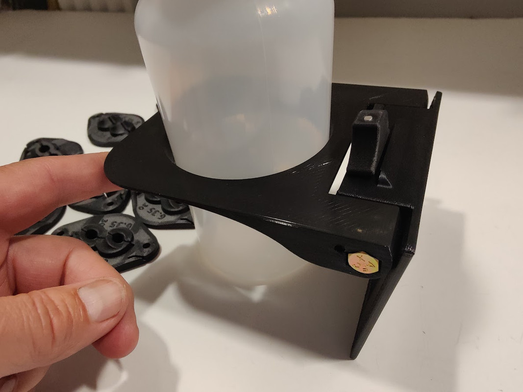

Forward spar cover cup holder... positioned between the legs. Getting closer to hitting the print button on this one. I've thoroughly enjoyed working on this design project, though I'm unsure how well it will perform. It's designed to be robust and fully serviceable, attaching with either 3M Dual Lock or screws. :)
Posts: 2131
Re: a couple printed widgets
Forward spar cover cup holder... positioned between the legs. Custom cup hole sizes to be available. I printed this yesterday while I was out on a bike ride and assembled it this morning. I like it. It is very smooth and precise. It's ready for a load test, perhaps 20 lbs. Made to last the life of the aircraft. Assembled part weight = 142 grams. Next, how about one in all black?

a foldable cup holder in all black color, to be located at the forward spar cover between the legs. it has a smooth trigger motion and is very nice. I'll load these in the aircraft tomorrow for a test fit. It would be nice for me to have a total of 4 cup holders at times. I printed some more 30-degree wire seal, 6.35mm. as these seem to be selling. I suppose people want smooth ignition wire flow with unnecessary bending.

Tit check. Forward spar cover cup holder... positioned between the legs. I will take a quarter inch off the overall length of future versions but these are fine. I will permanently install these pieces in the aircraft with 3M Dual Lock.

folding cup holder load test. bolted cup holder to a beam and applied 20 lb load. after test the part is fully functional and I will install it in the aircraft. see the post test movie.
da 20 lb load test, post test action movie.... note: this was the first print I made of this part and was conducted after the 20 lb load test. it can take some punishment.
the test and post test inspection....
Posts: 2131
folding cup holder, 3M Dual Lock load test. the 3M Dual Lock I use failed at 15 lb load. that is with the rope and weight load placed at the outer lip. multiply that by 1.6 to determine the equivalent load at the center of the coffee cup hole and that equals 24 lb. a relatively large cup of coffee weights 1 lb. during a 6g loop that coffee cup will weigh 6 lbs. 24 divided by 6 = 400% margin of safety so as not to spill the coffee. :) I would be comfortable using 3M Dual Lock to support this cup holder. the foldable cup holder survived the test fine. so far, they seem to be able to take a beating.
