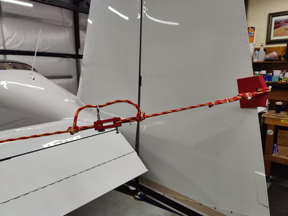

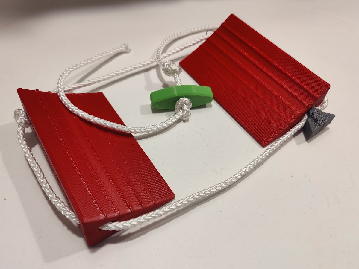

Mechanized Right Hand Main Tire Wheel Chock - adjust the rope length and knot placement where you like it. These chocks will last the life of the aircraft and provide unsurpassed functionality. Use it as a regular chock or latch it for added security. The right hand nav light color = green.

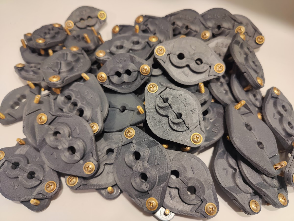

I printed more spark plug baffle wire seals... different angles, hole count and sizes.

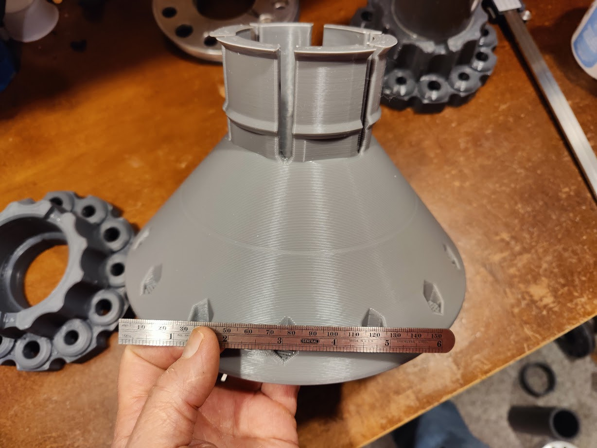

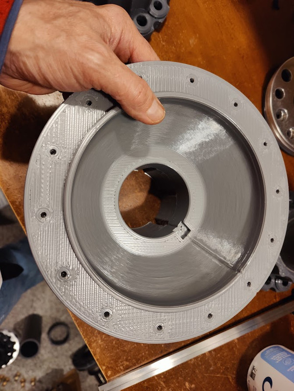

I’m still fine-tuning the details of this design. I adjusted the spacing, so the gray spacer sets the spinner aft edge offset from the ring gear support forward flange precisely. This makes it easy to determine the exact forward spinner offset and verify it using the spacer’s marking. In the photo, the cowl outer plate is configured for a 360 cowl with a 390 engine. It will probably turn out that only a couple of different spacers are needed to cover most of the available products and if a custom spinner spacing is needed it is a quick print for a new spacer length.
The outer aluminum plate can be tailored to compensate for engine rubber bushing sag, .125 or .25 inch, whatever is needed.

The design is complete, and manufacturing development along with the first article inspection is now in progress.
Note: If the starter ring gear support (flywheel) isn’t installed, use the optional 0.25-inch spacer at the propeller flange to ensure proper fit. The tool base won’t mount directly to the propeller flange without this 0.25-inch spacer.
The tool is somewhat Murphy Proofed as all that is needed to ensure the cowl fwd face axial position from the flywheel is to read the number on the internal spacer and that is what you will get.

I’m working on the first print of this part, and it’s always exciting to start on a 1.5 lb piece. All the parts have fit together well so far. I still need to print the base and bond it to the pipe. The locating surfaces are printed in fine height detail for accuracy. This is a rigid tool than you could really lean on, .25-inch alum plate. From a geometry perspective, cones are stiff in both the axial and radial directions, compared to a flat plate and cylinder. Read the number on the spacer and that is the offset from flywheel (ring gear support flange). If the flywheel is not installed, use the flywheel spacer.

Cowl Support Tool... making some progress here. The plate’s flatness from the Zero-Zero contact surfaces measures within 0.010 inch, which isn’t bad for a first print. The plate is very rigid—I could probably stand on the end of the center pipe. This is definitely a tool you can lean on. The hose clamp should be one size smaller so it doesn’t stick out, since people will be working around it. Not too bad for a first part.

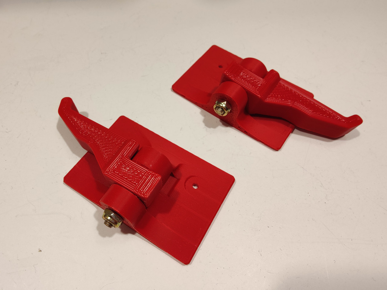

Re: A couple printed widgets

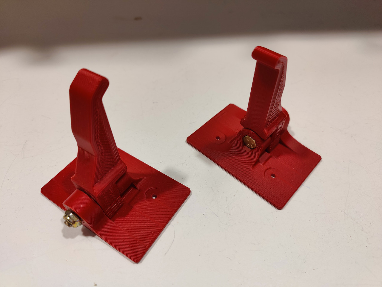

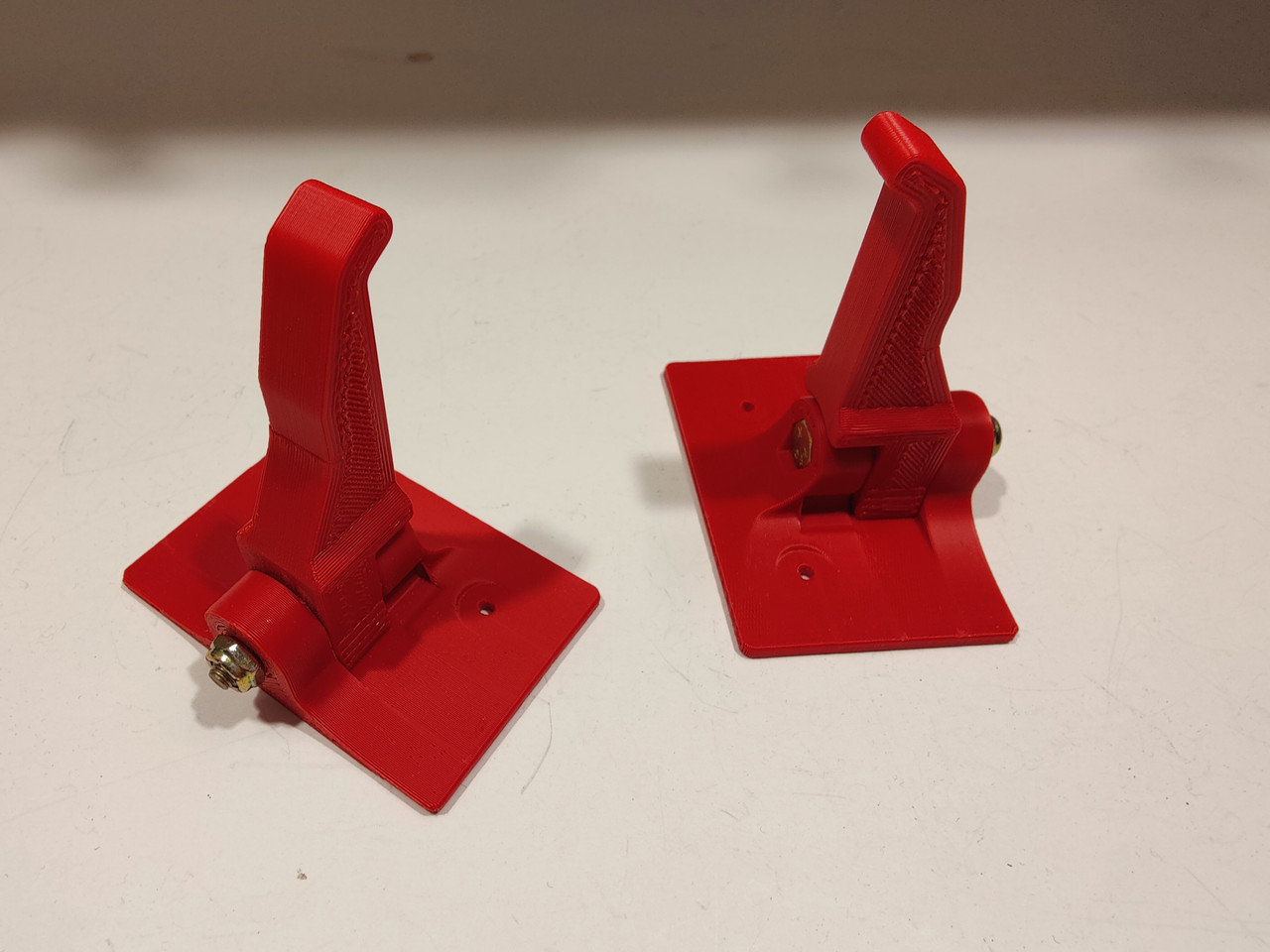

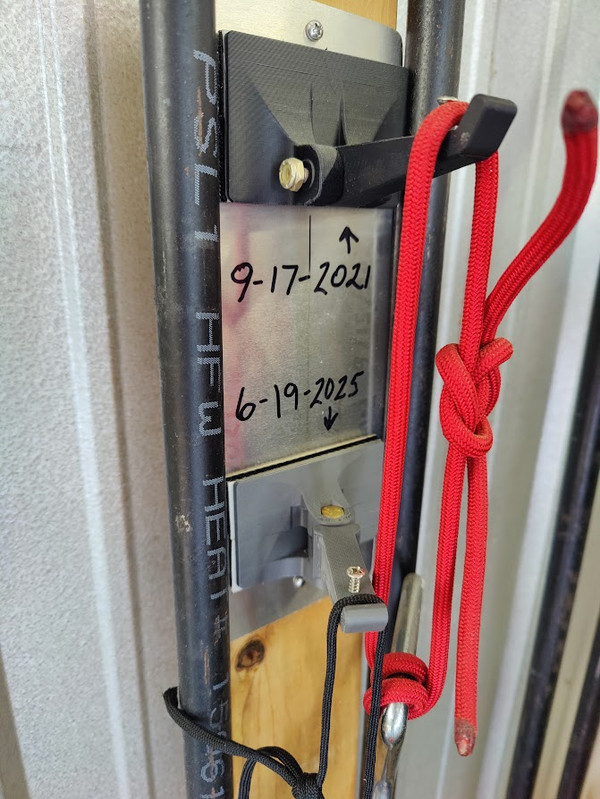

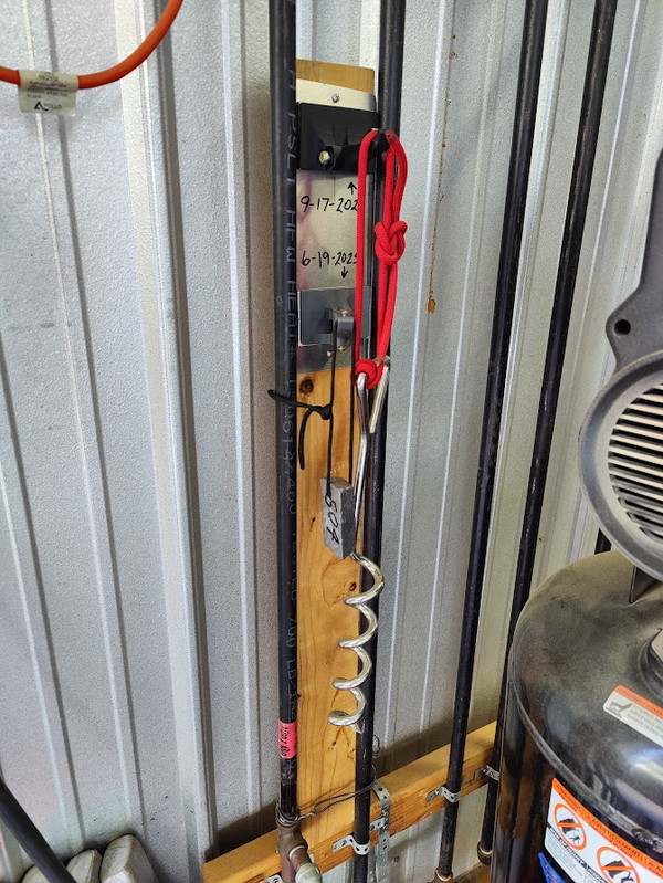

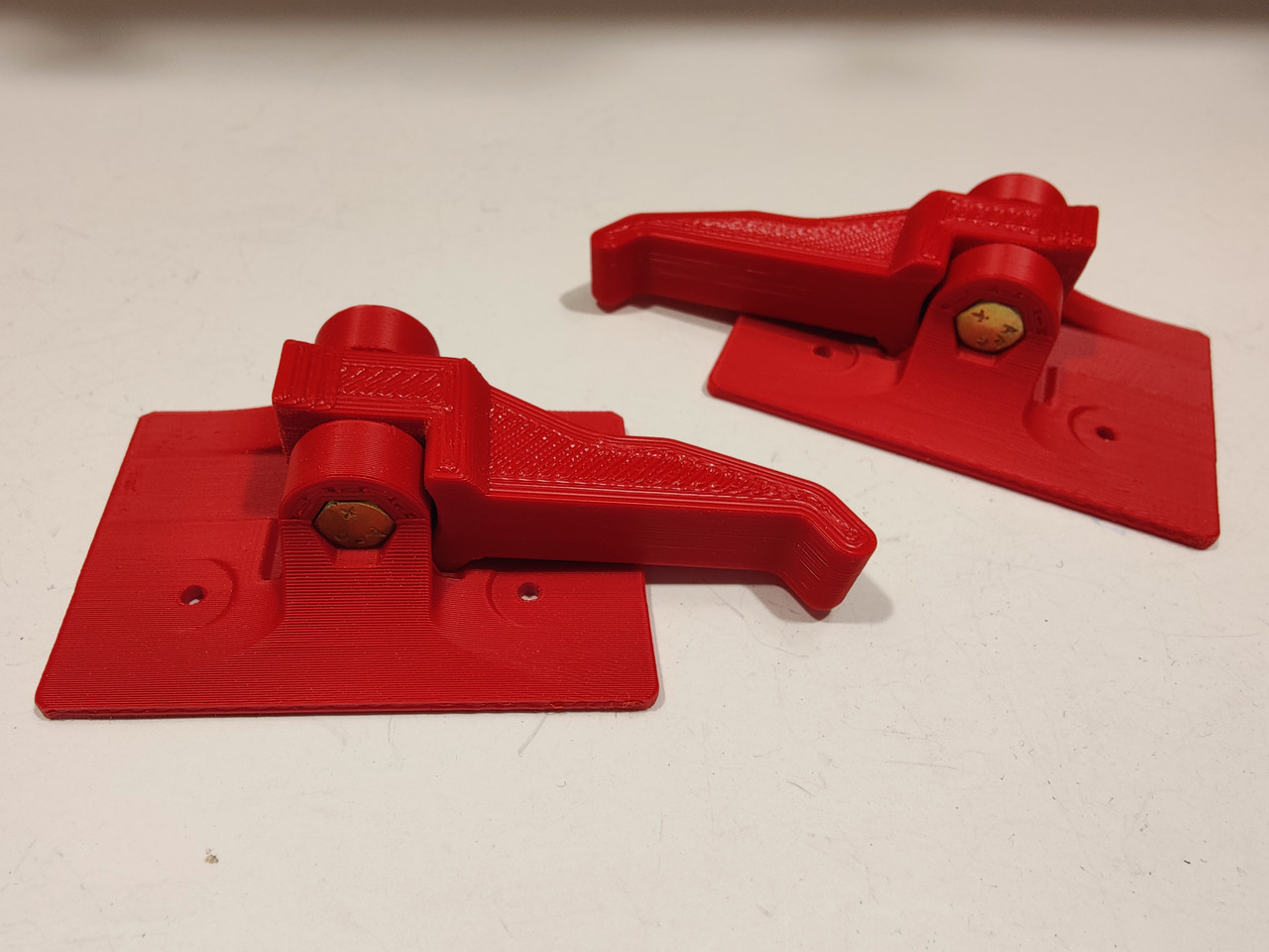

This is my first time printing these 90-degree headset holders in red, and I really like them. The 3M Dual Lock test specimens are still going. A photo from last week. Both weighted with 1.1 lb.

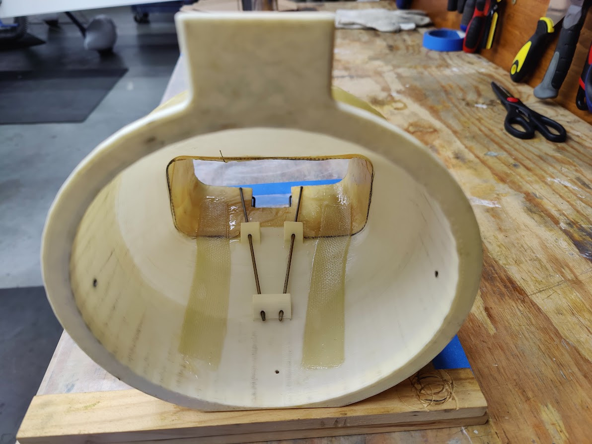

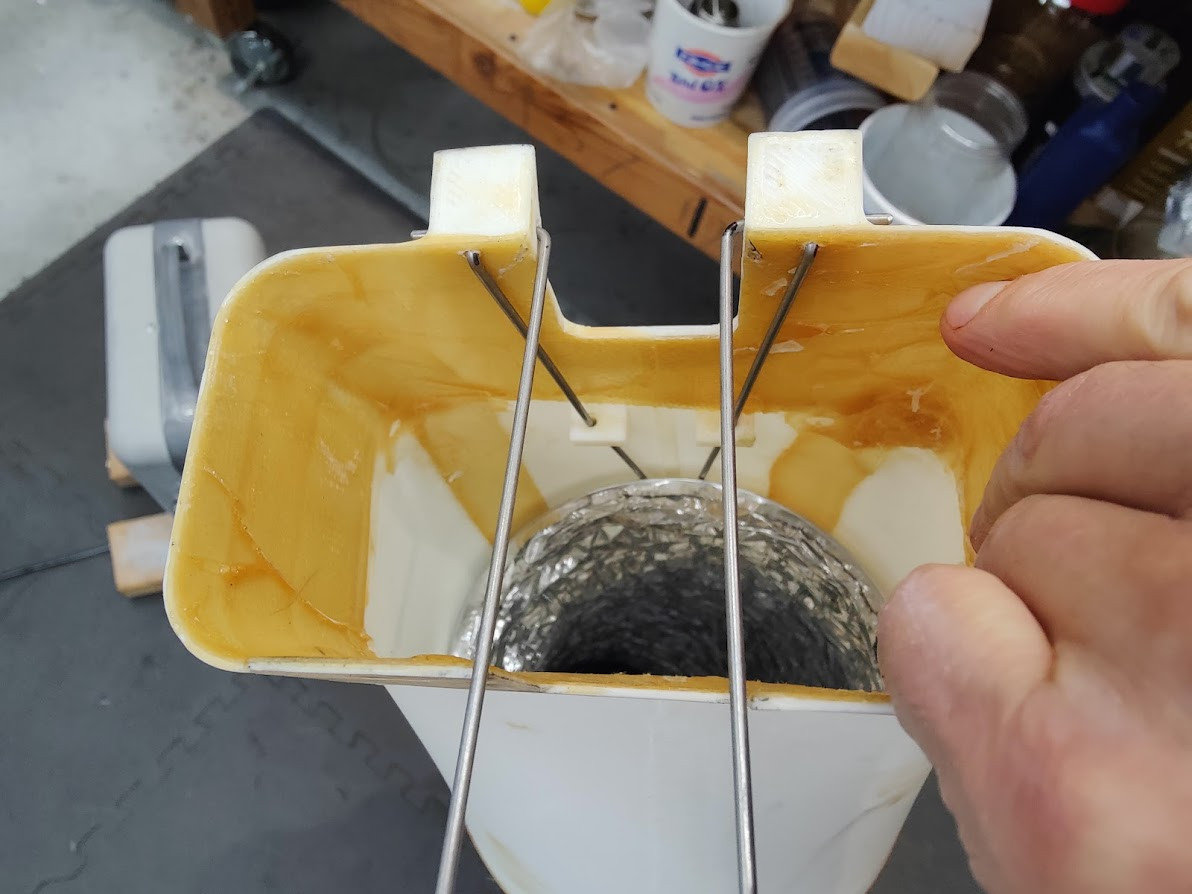

Two years ago, I noticed a small crack on the top of my preheater duct. I wasn’t too disappointed since I’d been using it for eight years and hadn’t exactly treated it gently. When I built a second one last year, I added some fiberglass tape on the inside for extra support. I made the same upgrade to the cracked duct, and hopefully, it will last another ten years.
