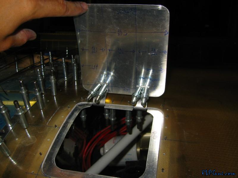

I am waiting on some concealed hinges before I mount it to the cowl perminantly. I will put a single Hartwell H-5000-2 latch (the only thing I bought at Osh!) on the bottom and call it done. I think I might polish the hatch and leave it unpainted. It looks awesome!

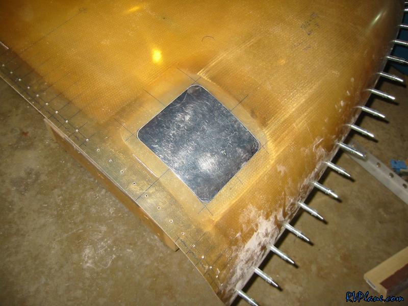

I banged out a metal oil door tonight. Since I have the Sam James cowl, I didn't get an extra oil door like the Van's cowl comes with. Instead of trying to fab something out of fiberglass, I thought the metal hatch would be a perfect solution. Mine turned out really great:

The main thing you need to do is make the first cut of the sheet WAY larger than the oil door (mine was 3" larger in every direction) to give you more leverage in all directions for the bend. If you make the metal door the final size right off the bat, you won't have a good curve on the edges. Dick Martin gets the credit for that idea. I spoke with him extensively at Osh about all the neat mods he had on his RV-8.

I will put a Hartwell latch on it eventually. I need to wait for an order of concealed hinges before I can mount it permanently to the cowl. Once it is hinged, then I will cutout the hole for the latch. Here is the latch I am going to use:

Another thing - Guden made me order a $25 minimum of concealed aluminum latches (3.99 ea). Since I bought 8 of them, I will probably sell off two or three sets at cost once I get them and make sure they work. You interested in a set?
Checkoway mentioned he liked these hinges, although I haven't seen anyone else who has used them:
Guden NHAL9290
They should work fine with a remote release. Obviously I will let you know how well they worked once I get them drilled. Or maybe I will lie so you can still buy them off me

I used the same hinges and latch. Both work great and should make the door you made look and work great Mike!

Keith-papakeith wrote:nice job. I'm curious, did you use anything to help make the bend or did you just keep bowing it until it was correct?
The oil door is 5.5" by 6", however, the original sheet I used to bend was 11.5" by 12" to give me more me more leverage to make the bend as well as have the bend continue on the cut line. If I made the door 5.5"x6" right off the bat, it would of been much harder to bend and the bend wouldn't of continued to the edges. To make the bend I did it all by hand. Took a lot more force than I thought to bend the 050! Since it is a somewhat compound shape, I needed to clamp one side down to the table to cause one side to have a tighter radius bend than the other. All in all, it took about an hour to bend the door. Once the door is in for good, I am going to put a stiffener on the bottom of it to keep it in place.

The verdict is in!
I received the aluminum hinges from Guden on Wednesday and got around to installing them tonight. They are PERFECT for this application. My whole builders log entry for all of the details is at:
http://rvplane.com/?categoryid=6&dayid=644
Last I checked Carl, Chad and Brian (hydroguy2) called dibs on the 6 hinges I have left over. 8 hinges after shipping ran me $37.68 - or $4.71 each. My thought is email me your addresses (I know I can send Carls and Chads in the same box) to mike@rvplane.com and I will send them out and email you guys back with the total cost after the actual shipping. Send me a check for whatever that amount is and call it done! Sound fair?
