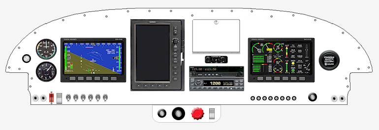

Here's what I'm thinking as far as the layout. Opinions are welcome!
I'm including a small 2 1/4" airspeed indicator and an altimeter just for overkill. Will I need the thicker panel for all this? Except for the switches, knobs and fuses, here's my grocery list (top to bottom, left to right).
2 1/4 inch Airspeed Indicator - http://www.aircraftspruce.com/catalog/i ... so_asi.php
2 1/4 inch Altimeter - http://www.aircraftspruce.com/catalog/i ... eters2.php
Dynon EFIS-D60 Electronic Flight Information System - http://www.dynonavionics.com/docs/D60_intro.html
Garmin GPSMAP 695 - https://buy.garmin.com/shop/shop.do?cID=156&pID=14860
AirGizmos Panel Dock for the GPS - http://www.airgizmos.com/prod/pd13/index.asp
Glove "Map" Box kit from Van's - http://vansaircraft.com/cgi-bin/catalog ... oduct=mbox
Flightcom Stereo Intercom - AV FC-403 - http://vansaircraft.com/cgi-bin/catalog ... -intercoms
Garmin SL40 VHF Comm Transceiver - http://vansaircraft.com/cgi-bin/catalog ... oduct=sl40
Garmin GTX-327 Digital Transponder - http://vansaircraft.com/cgi-bin/catalog ... uct=gtx327
Dynon EMS-D120 Engine Monitoring System - http://www.dynonavionics.com/docs/D120_intro.html
Honeywell Hobbs Hour Meter - http://aircraftspruce.com/catalog/inpages/hobbs.php

With the Dynon system you can eliminate the need for the separate Hobbs meter.

smittysrv wrote:Here's what I'm thinking as far as the layout. Opinions are welcome!
I think the fastener that secures the door; the slot should be in the horizontal position instead of the vertical position when the door secured.
Thanks Bret! I didn't know that. I'll put my beer bottle opener there instead.
Posts: 1033
You do understand you will loose a ton of the D100 features if you go with a D60????
http://www.dynonavionics.com/docs/EFIS_ ... rison.html
One that I would love with that panel would be the ability to share the EMS data on the Pilot's screen and vice versa. Can't do that with the D60.
It is clearly a VMC panel. Why the steam gauges at all? You already have a usable panel page in the 695 for backup.

Holy crap! I really should read more. Time to upgrade the picture for the D100! Thanks!

Smitty, ditto Brantel's comments. I would opt for the beer opener on the key ring and install a cigarette lighter power port in place of the Hobbs. It is really convenient if a friend wants to plug in a cellphone, IPod or even a second GPS.

This is just my opinion/observation and not a criticism: Why do you have your map box closer to your line of sight than your engine monitor? If it were me, I would swap positions between the engine monitor and the map box, maybe move the EFIS up a tad to be at the same level as the engine monitor after you stack it over your radio/transponder. That way you will have everything you need to monitor within a glance of each other. Move your intercom to just under the mapbox
Just a thought. I like all the equipment you are including. Has everything you need IMHO.
