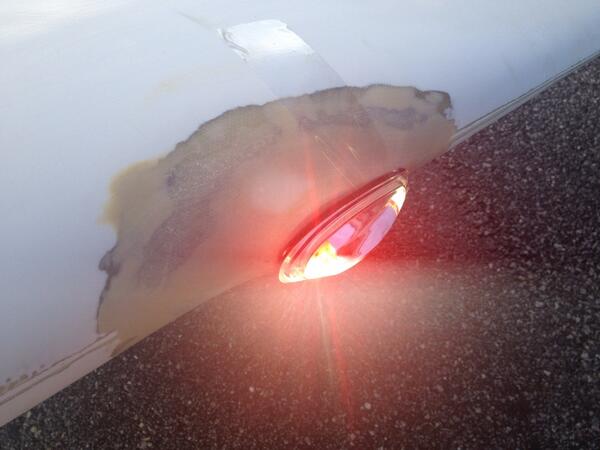

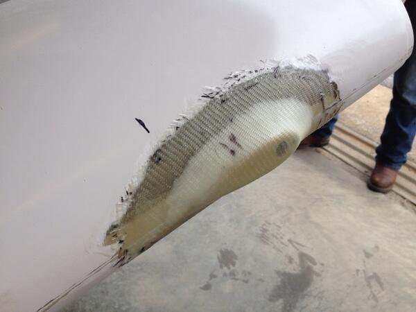

I ended up getting the Aveo powerbursts and mounting them on the outside of the wingtip.
I made a faired platform for them to mount to on the tip:
I was hoping that with the white position light on the back side of these lights, I wouldn't need a tail light, but I think the outward sweep of the wingtip means I really ought to have a tail light. I went ahead and bought the posistrobe XP to go with them, but I haven't installed it yet.

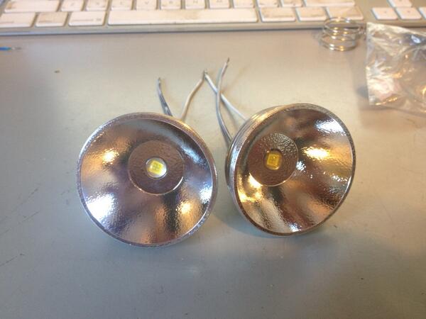

Now I'm working on landing lights. I've pretty much decided on LEDs. I'm using flashlight modder parts from dx.com.
Right now I have these two SST P7 leds in reflectors. They're 900lumen apiece. These two together have about the same pattern as the wingtip lights on my cherokee, but they're considerably brighter and whiter.
I have some more LEDs coming from DX, some Cree XM-Ls, which are rated the same lumen but folks say they are perceived brighter than the P7s. I ordered different reflectors too, but they're all backorder. Right now reflectors are my sticking spot... I want something under 2", that focuses a fairly tight beam. Some 6 degree reflectors for landing lights would be ideal, and wider for taxi lights.

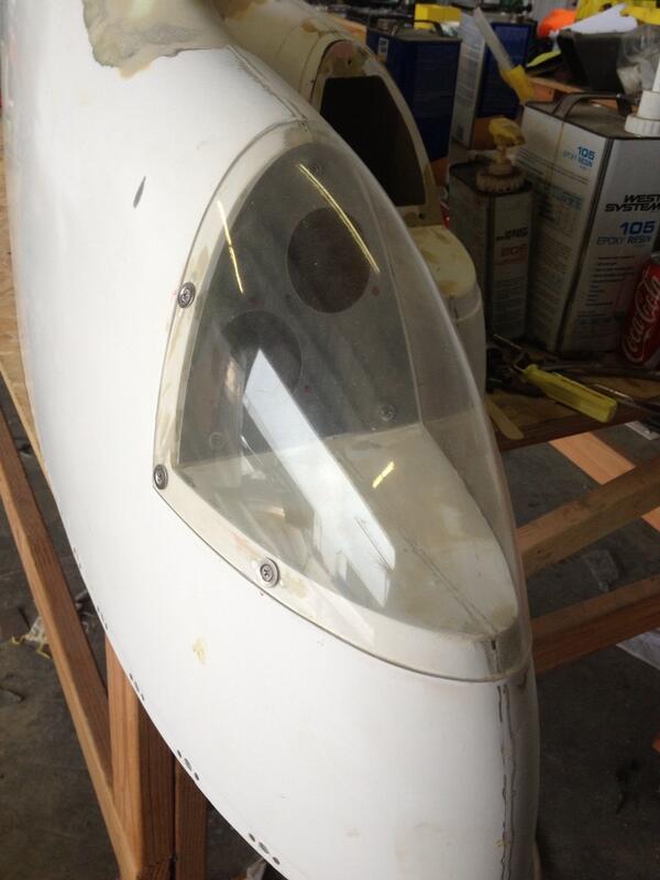

I plan to put two in each wingtip... one aimed for landing, one for taxi. I did some work on the tip cutouts last weekend:
