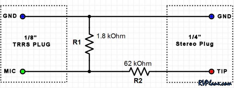

When I flew to Oshkosh two years ago, my friend Peter brought with him a cockpit voice recorded audio cable made by NFlightcam which connected inline with the headset cable, and had a pigtail wire which you could connect to your phone to record audio. I looked at buying one, but it was somewhere around $40 (http://www.amazon.com/Nflightcam-Smartp ... B00HQMLFWC) which seemed to be excessive considering all it consisted of were a could of cheap connectors and some resistors. So I reverse engineered the cable, ordered the connectors and resistors off of EBay from China and for under $10 made my own version.
This is the basic schematic of the cable. The parts list is simply the following:

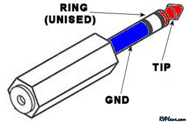

(1) Male 1/4" Stereo Plug
(1) Female 1/4" Stereo Jack

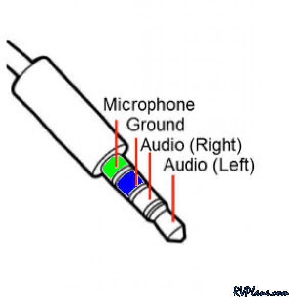

(1) 3.5mm (1/8") TRRS Cable - 6'
(1) 1.8 kOhm Resistor
(1) 62 kOhm Resistor
I was able to squeeze all of the resistors into the male jack, although it was a tight fit.
The Tip and Ground are the only contacts used for the microphone, however, you do need to pass the RING signal to the female jack for the headset to work.
The TRRS 3.5mm jack only needs the first two contacts used for the audio.

Cool project! Would this work with a GoPro? Or is it just for iPhone?

Bruce,
The signal voltage levels this circuit outputs is definitely compatible with a GoPro, you will just need use a stereo 3-conductor 3.5mm plug wired slightly differently, and a 3.5mm <-> USB Mini connector similar to the following:

I have ordered a 6.35 male/female stereo cable and plan to unscrew the socket and attach a cable, terminated with the
3.5mm four ring jack plug (which I actually had several of already)

I don't think you need to be concerned with the mic jack, as the mic audio is fed back through the headphones via the intercom. You only need the 1/4" plug and jack.
I haven't used this with the GoPro yet (I have the GoPro mounted on the tail of my airplane), but I record the audio through my phone's mic jack all of the time successfully.

I have finally got around to this - and success :)
The only thing I might change it to connect left and right audio together, as with one side not connected there was a little bit of noise on that channel, but otherwise the quality was excellent :)

Thanks for this very interesting schematic. It is very expensive to buy such cable in Europe so I will be happy to built my own one. However I am not so skilled in electronic and wonder if the values of the resistors you put will be compatible if I use a voice recorder with a 2 kohms mic input line and an headset David clarck H10 13.

I have trouble with this diagram, I´ve made the cable but still can´t get it to work on a Moto X Gen4 :|
Don´t know where the problem is, already check the wiring, but it´s like the cell won´t detect the external mic. (Already checked with a motorola wired headset and the mic works perfect)
Thank you in advance!

Can we make it without resistors will there be any issue? For Android( samsung)

I'm new to electronics why are we using resistors in this case, what will happen if we don't use it?
