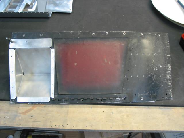

Scott,
Here's the only picture I took before the battery in my digital camera ran low and I had to bring it home to charge.
What we did was to cleco together the RV-8 footwell pieces and then position it over the removed floor area to check and see what would be a good "fore/aft" position so that it had at least a 1/2" clearance from the aileron pushrod when it was moved to its highest position. In our case (and yours may vary depending on where the builder placed the platenuts) the 2nd hole in the existing 3/4X3/4 angle on the sidewall lined up nicely to the very first front hole in the pre-punched foot well. (where the black cleco is)
In the picture you can get a rough idea of how far back from the spar the footwell needs to be. ALSO, keep in mind that once we did this, the RV-8 footwell is now too long in the back, so we had to shorten it by cutting the back of the center section piece and re-bend a rear tab. We also had to trim the side (triangular shaped) pieces and re-drill the aft holes.
It sounds complicated, but in reality it isn't that bad, and again, it's well worth it.
I'm not sure I like the other suggestion to remove the floor area and have your heels on the outer floor skin. If there happens to be any antennas or wiring in that area this type of mod may not work well.
Pictures are worth a thousand words! Thanks, that actually does help a lot. I was going to make the footwells from scratch but the -8 parts look like they turned out so well I think I'll do that as well.
