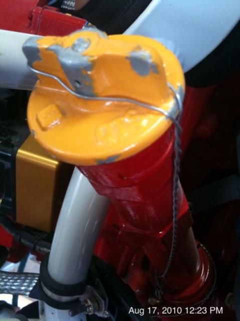

Chad, you can safety wire the dipstick...
John, I believe Jack Rosen showed us how to do it.
Chad, all ya gots to do is start by wrapping the wire into a loop around the top of the cap flats, then twist it snug while going down and secure the bottom into the small hole down on the bottom of the tube. You tighten it just enough so that you can lift off the loop from the cap, check the oil level, then put the loop back onto the top of the cap.
I'll snap off a picture this week of mine when I get to the hangar on Monday.
Here's the Picture of it. Works great.. if you don't mind the paint chipping off a bit.

That's RIGHT!
Jack DID show us how he did that!
He is a true visionary!
