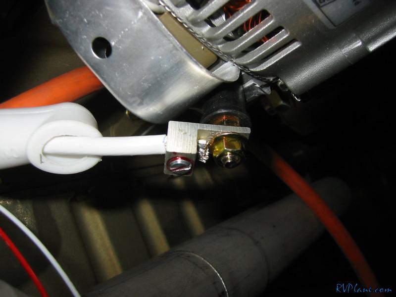

Wondering what kind of ground strap you guys have between airframe and the motor? A crack in a terminal has developed at 3K hours and I am looking for an alternative. Take a look.
Posts: 1378
Re: Ground cable to replace
Hi Vlad,
I used Welding Wire, which is composed of a number of very fine copper wires and has a lot more flex than the Tefzel wire you use, on top of better conductivity. I think the stiffness of the wire is a large contributor to your issue. PM me your address and I'll send you a couple of feet of it if you're interested.
Also, I used Aluminum Set Screw Lugs from McMaster-Carr - it's a lot beefier than the standard crimp lug. The pic below is for a smaller gauge wire (alternator). It's part number is #6920K21 - and I think I only paid $0.75 for it. You should be able to use that for a starting point to find the right size one for the ground wire.

Thanks Mike that's a great idea about lugs. It's been too long since I was building. I do have the same lug at the alternator. My coworker is an electrician by trade and has tons of lugs in his truck. I also check with him on the wire and let you know tomorrow if able to source it. BTW how is your alternator belt holding? I am still on original and wondering if the time comes to change.
Added; is that red locktite?
Posts: 1378
Vlad wrote: Added; is that red locktite?
Yup, red lock tite...good eye! I also check it's tightness every annual.

Out of curiosity, what's wrong with the screw-type lugs compared to the crimp lugs?
:? :dunno:
Mikey,
Absolutely nothing is WRONG with the ilsco lugs, I just wouldn't put them on my plane.
I have installed thousands of them and over my 30 years as a licensed electrician never seen one fail or cause a problem if it is installed correctly. That means using copper type on copper wires and aluminum type on aluminum wires.
Now, the loctite you have used wasn't part of the UL listing. If that were on a high voltage application, it would be a violation because it wasn't UL tested and listed be installed in such a manner. The possibility that you will go down in flames as a result??? Probably not... That is a violation of National Electrical Code 110.3 (b)
The reason why I don't like it is because it has a higher parts count, more weight, complexity, isn't insulated or stress relieved. Additionally, my terminals are filled with solder so that they are gas tight connections. Something that you can't do with the ilsco lug.
My two...

Lookin' good VLAD! How large is that wire...it doesn't look to be 2 gauge? I dont think the insulation material makes much difference for the engine ground -- most people use a braided uninsulated cable.
