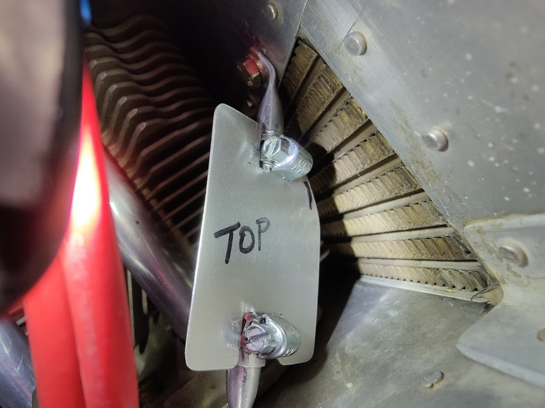

ACOC air discourager to possibly lower CHT #4.... I really have no idea if this will work but my thinking is the air has an easier "straight" route thru the ACOC so bend the air towards cylinder #4. this deflector is attached to my ACOC aluminum tube stiffener. it's been on there for 1100+ hrs. oil temp will probably increase but my oil runs cool. it would be nice if it works because I like two-fers.
6061 alum and vibration can cause tabs like that to fatigue, so probably better to have stainless, but this is just a test. I am looking for 12F lower on #4.
this was a failure. #4 CHT is up 4F and oil temp is up 4F but all the other cylinders were lower. it is blocking airflow to #4. I'll rotate the deflector 90 degrees and make one more test, but not looking good so far. however, it was a very nice day to fly.
rotated 90 degrees from previous orientation (didn't get a photo). this was also a failure. #4 was even higher. so, something NOT to do.

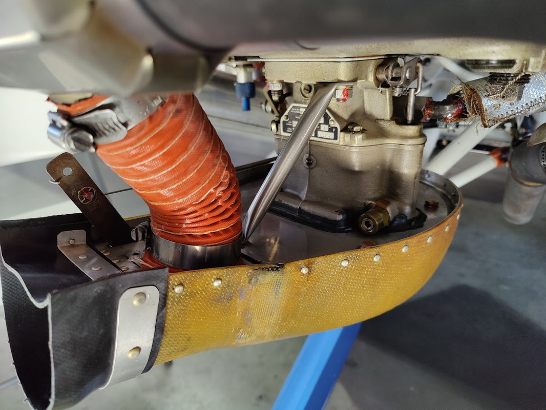

I swapped the left mag with a new one, but it didn't make ANY difference. still the same 15F delta hotter on CHT #4. so, I've tried modifying the under cowl air flow, and a different mag. what's remaining is the fuel mixture to #4. perhaps my inspection of the fuel/air inlet tube was not good enough and the intake coupling needs to be changed and or the fuel mixture from the carb is slightly different. so, those will be things for the future. I do note that #4 has slightly lower compression. shined the exhaust pipes because these have been so good. nothing done in 1100+ hrs. took some photos from under there because you don't see many from that angle. nice day to be at the hangar.
air filter box and baffling look really good. nothing required since new.
