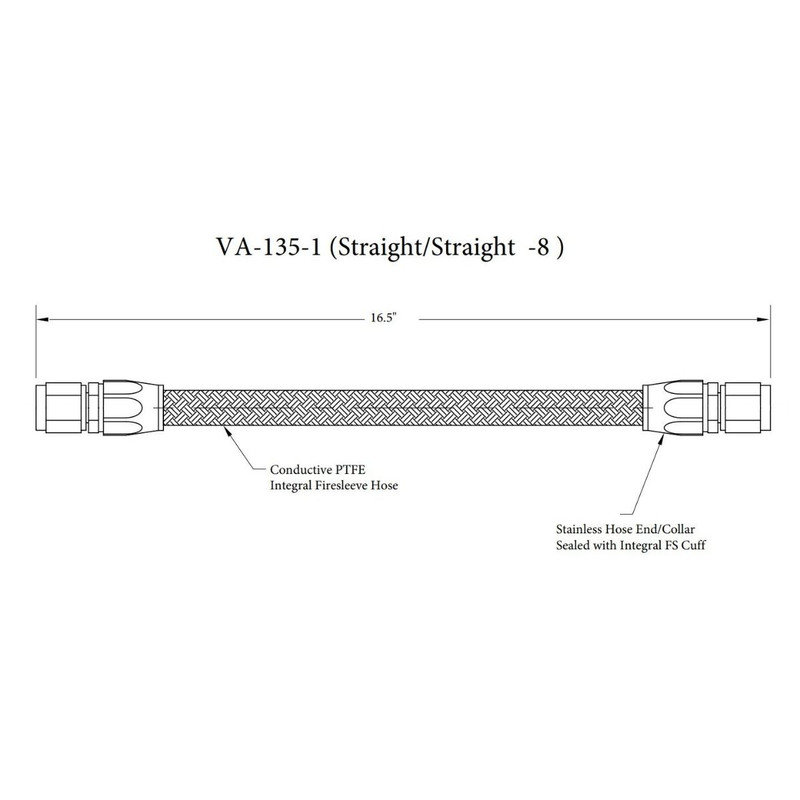

I have a VA-135 hose at the top of my ACOC. The bend diameter = 7 inches. Mil-spec Teflon min bend radius for a -8 hose = 4.62. 2 x 4.62 = 9.24 inch diameter and cannot meet. Van's new replacement hose is Teflon, how can it meet the bend radius? I think I will replace these -8 hoses with the original AE701 rubber material in order to meet the bend radius requirement.
I contacted the tech department at Aeroquip, and he said the min bend radius for the Teflon hose is independent of pressure and is truly a minimum. so, I will not violate that. for fundamentals like nuts, bolts, wires and hoses, it is best to mind the specifications. I am not sure if Van's is violating a specification or what hose they use. I'll send a note to Van's. I know Van's does not sell certified hoses.

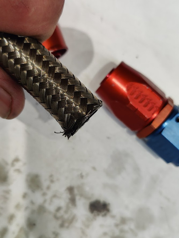

making hoses from certified materials that have a listed spec.... oil pressure sense line pressure tested to 1000 psi and installed. fuel pressure sense hose is made. they are very easy to make, and fittings are reusable so if you don't like the length, make another. using 666, Vlad hose.

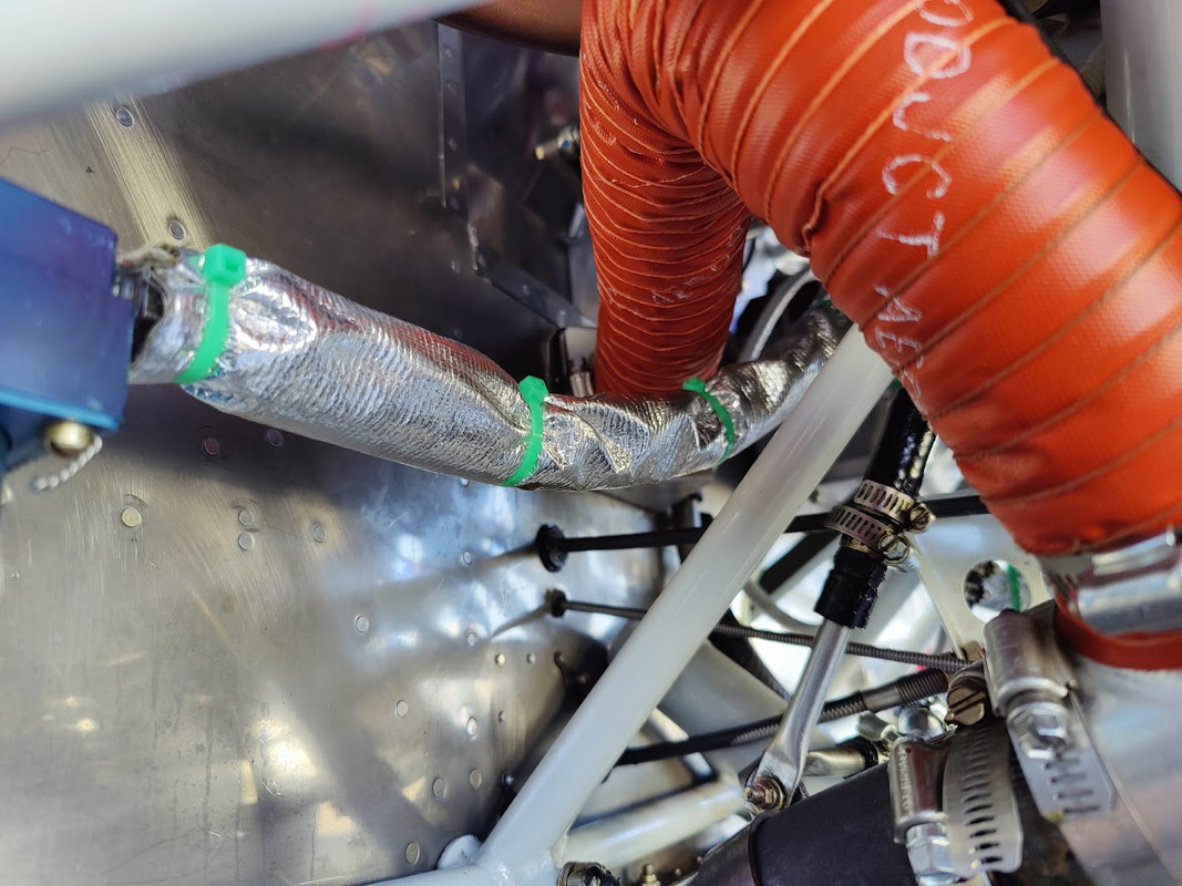

fuel lines to get fire sleeve.

all aeroquip 666 teflon hoses are made. very easy to work with super gem fittings.
one of my -8 hoses (ACOC upper hose) needs to be 701 to meet the allowable bend radius. the aeroquip -8 666 teflon hose allowable bend radius = 4.62 and I need 3.6 inches, so 701 it is. you can make some nice end cuts with a cut off saw using an abrasive wheel.

I don't use safety wire on my hoses, but I apply a flexible thread lock to the last couple of threads for secondary retention. Teflon hose is stiffer than rubber and I noticed some contact at the prop gov bracket. threading the needle to be able to secure the B-nut and minimize hose interference. so, that is a risk when changing hose material type. since the bracket and hose are moving together with the engine, and the location is the center of the engine mounts the relative motion should be minimal. I applied a strip of Teflon tape and will watch it. with some heat the Teflon hose contact should reduce over time as the hose settles in. the nice thing about the Aeroquip Teflon hoses is that I should not need to replace them over the lifetime of this aircraft. I will add some reflective heat wrap around the fuel supply lines, already with fire sleeve, for added protection as this has served me well in the past.
I could not meet the allowable bend radius for the ACOC oil return line with a Telfon hose. so, I it is still Aeroquip 701 rubber.
the only lines that are fire sleeved are the fuel supply lines that are close the exhaust pipes.
all assembled hoses were pressure tested to 1000 psi.

I like the radiation heat wrap on the fuel lines. most of the heat down there is from radiation of the exhaust pipes. most of the heat transfer on a carb'd engine is at the carburetor. not much one can do about that for a conventional setup. I suppose one could recirculate fuel from the carb bowl to the tanks if they were creative and really knew what they were doing. I've been fine running this conventional setup with 100LL.
high temp zip ties will last 10 years at that location with no problem.
