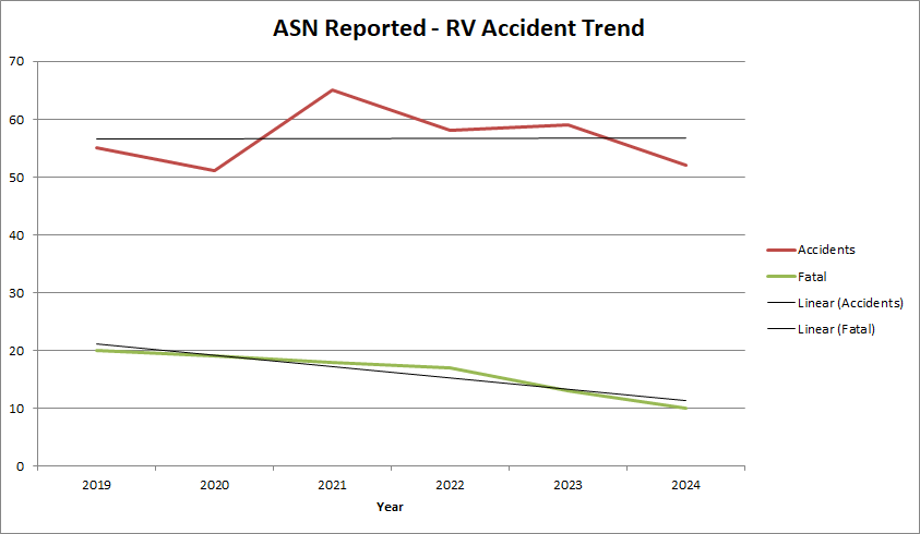

Looking at the Aviation Safety Network for Reported RV Accidents. I think this is the most worldwide reporting source, but I'm sure it doesn't cover them all. You can only get this information at RivetBangers, because we are not slackers. :)
ASN Reported RV Accident Total for the past six years... the fatality trend line is in a good direction.
Year Accidents Fatal
2019 55 20
2020 51 19
2021 65 18
2022 58 17
2023 59 13
2024 52 10
2024 Accidents by Model, the RV8-8A is the winner again this year.
In the history of Van's, ASN reported accidents = 1231
Van's Total kits completed and flown = 11403
1231/11403 = 10.8 percent have ASN reported accidents/kit, seems about right.
In the history of Van's, ASN reported deaths = 446
446/11403 = 4 percent have ASN reported deaths/kit
This means that for every 100 kits shipped and flown, 4 people will die at some point in an RV aircraft. That is the nature of the business. It is legal for aviation to kill people and always has been.
