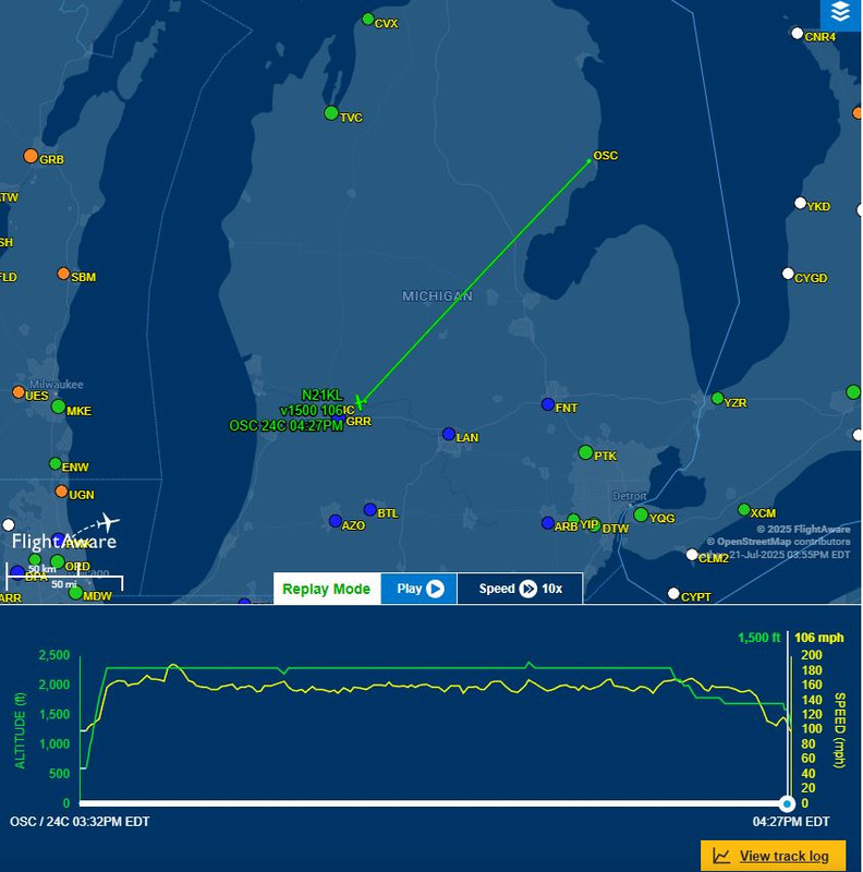

On approach, witnesses inside a vehicle reported seeing no smoke or fire and hearing no abnormal engine noises. A post-crash fire complicates the assessment. With two qualified pilots on board, this incident remains a mystery. Hopefully, investigators can uncover some answers.
It's odd that, despite good weather, they never climbed above 2500 feet during a 1-hour flight.

A preliminary review of ADS-B data showed that the pilot departed in the airplane at 1433 from his home base at the Alpena County Regional Airport (APN), Alpena, Michigan. The airplane landed at 1456 at the Oscoda/Wurtsmith Airport (OSC), Oscoda, Michigan, and the passenger boarded the airplane. The airplane departed from OSC at 1532 and flew southwest to 24C, which is a non-towered airport.
Upon approaching 24C, the airplane flew to the west of the Flat River. The ADS-B data showed that as the airplane flew over Lincoln Lake Road, it then turned to the south. Shortly after turning south, the airplane continued in a descending turn toward the east. The airplane impacted a storage unit building about 0.43 miles from the approach end of runway 12 at 24C. When the airplane impacted the storage unit building, an explosion occurred. A postimpact fire consumed the wreckage and the storage unit building. The wreckage was recovered from the accident site, and it was transported to a secure location.
