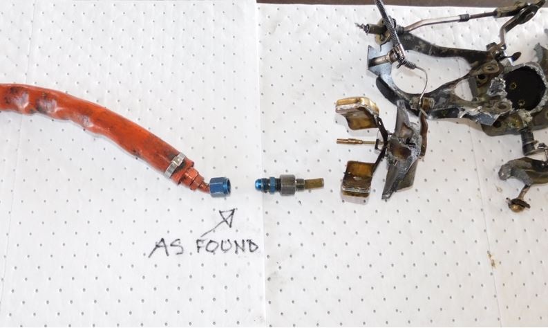

He forgot to tighten the fuel line B-nut to the carburetor, and he was using drugs, so he shouldn’t have been flying. His flying patterns indicated he was suffering from a mental condition.
https://data.ntsb.gov/carol-repgen/api/ ... 193721/pdf
The pilot was conducting touch-and-go landings and takeoffs and had completed several. After the last takeoff, the airplane climbed to about 100 ft mean sea level (msl), and the engine lost power. The airplane’s nose lowered, and engine power momentarily returned. The airplane’s nose then pitched up and, about that time, the engine lost total power. The airplane subsequently banked left and entered a near-vertical descent to the ground, consistent with an aerodynamic stall. Postaccident examination of the engine revealed that the fuel pump output line B-nut, which connects to the carburetor fuel inlet filter screen fitting, was detached. The B-nut exhibited no evidence of impact-related damage, and the threads on both the B-nut and the corresponding fitting were found to be intact and undamaged. The lack of damage on the threads and the in-flight detachment suggest that the B-nut was not properly torqued. There was no record of any recent maintenance having been done to that area of the engine, and the engine had operated only about 40 hours since its last condition inspection more than a year before the accident. Thus, it is likely the pilot may have performed airplane maintenance which was not reflected in the maintenance logbooks. Examination of the flight controls revealed no evidence of any preimpact mechanical malfunction or failure that would have precluded normal operation. The pilot’s medical history indicated that he had sustained a severe traumatic brain injury (TBI) in 2000. Severe TBIs commonly result in permanent cognitive damage, such as impairments in attention, executive functioning, and decision-making; these may include diminished reaction time and impaired reasoning and judgment. Also, the pilot’s toxicology results identified multiple potentially impairing substances, which could have adversely and unpredictably interacted with one another to worsen impairment, as well as a medication commonly used to treat moderate to severe symptoms of dementia, a potentially impairing condition.
