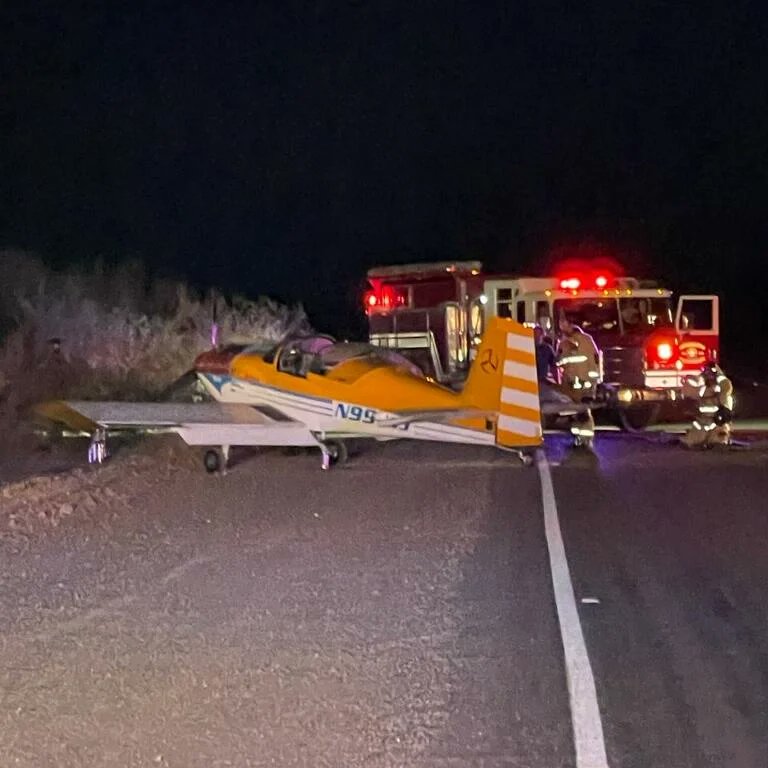

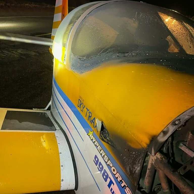

well, it's good he found a road. I am always intrigued by how the heat/flames flow into the fresh air vents for these type events. I have seen it before. It makes me wonder if it is the fire location that causes it and would it be beneficial to be able to block those vents with metal if needed.

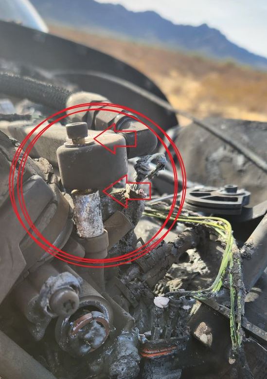

it appears a fuel rail became loose on the Yamaha. so, the fire origin is high on the engine.

if the NACA fresh air vents were metal and had a local safety shutoff valve (simple slide gate or other), that may allow more time to make a landing. fire pouring in from the sides would get your attention.

This is the Yamaha powered 9. I read he figured out the issue - a fuel fitting spraying fuel. I hope he is able to rebuild it quickly. At least it isnt a $40k Lyc. The Yamaha is about $10k if I remember correctly.

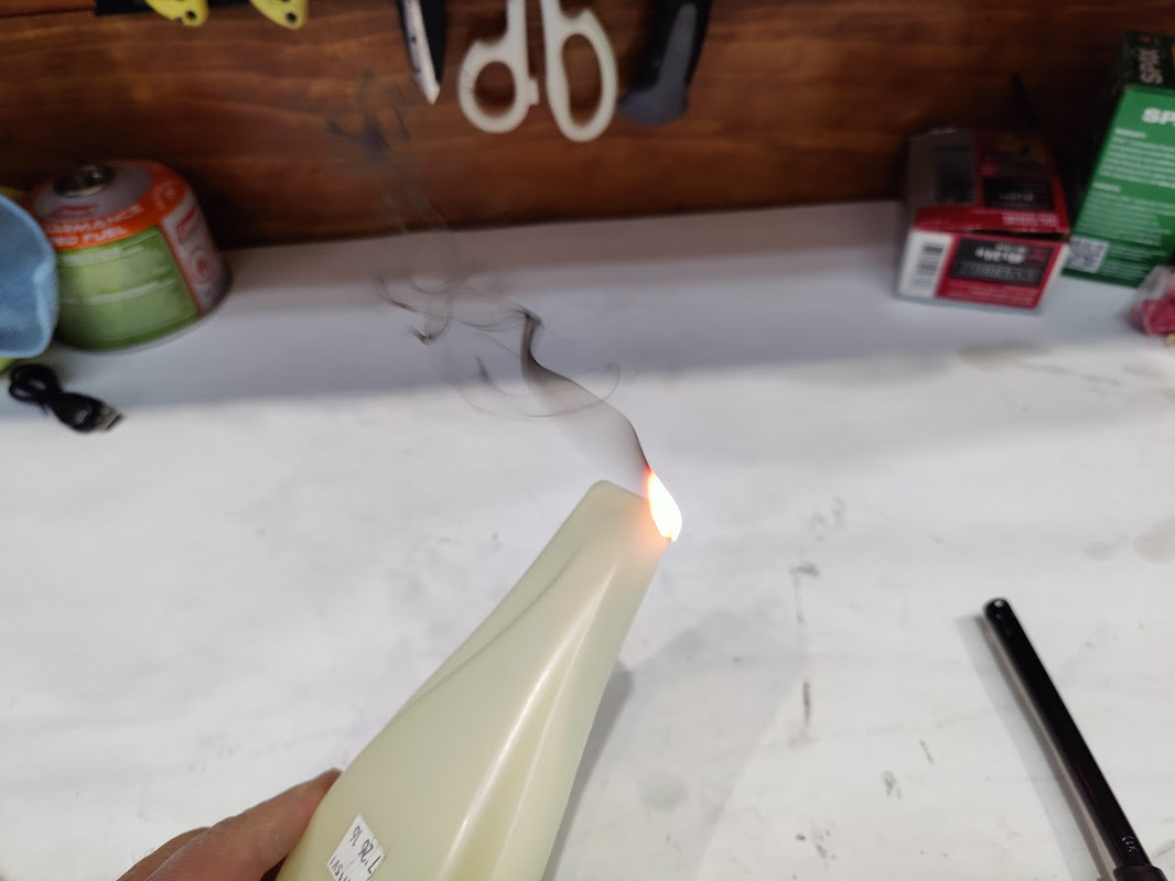

also, I have a spare NACA duct. I'll take some dimensions and then set it on fire. based on its translucency, it could be PET plastic, which is flammable. I don't believe it is Ultem, or it would be more expensive.

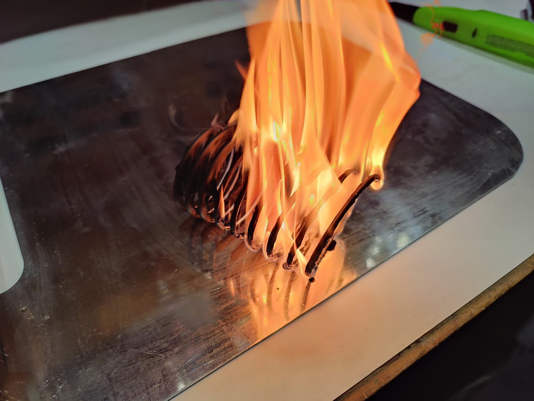

the Vans NACA duct burns very well. after about 3 seconds I had a good flame, and it was growing quickly. heavy black smoke. the fire would have consumed the part quickly.

it would be good to somehow fix the cowl to the airframe better to prevent it from deflecting outwards in flight and creating a gap at this location for the fire to travel. I think preventing smoke from getting into the cabin is high priority item. smoke can kill or cause pass out. I am sure this guy will be rethinking his life's goals.

fresh air vent duct burn test. Van's supplied black vent ducting ignited quickly and burned completely within 15 seconds. Vans supplied red silicone scat duct would not flame even after exposed to flame for 60 seconds. there is a big flammability difference between these two ducts.
