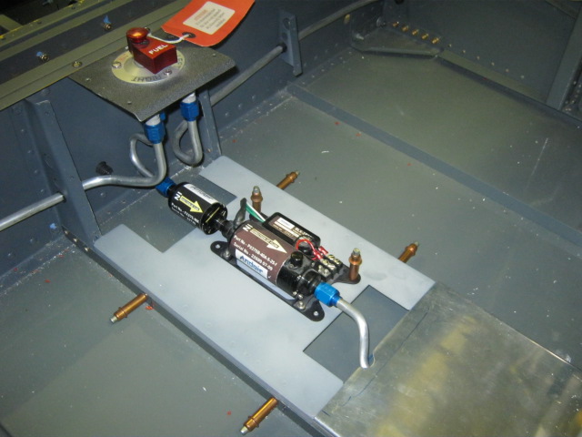

Just got home and started unpacking now. I am repacking and trailering the boat to Maine on thursday but I hope to get in some work on the fuel pump before we leave!
When I do, I will post pics of the install.

hydroguy2 wrote:LOL yep I waste more time worrying about tackling something than doing it. Also I have trouble actually making a decision about what to buy.bullojm1 wrote:Brian-
Looks great! I did mine in a similar amount of time and wasted material. Definitely one of those tasks that u spend more time worrying about than doing. Oh wait, that's all the tasks on the project!
But managed to plumb the wings to valve tonight. Turned out good enough, I won't be buying the braided lines from Bonaco....what actually saved some money!!!
OK I didn't really save any money, since I spent $300 buying knick knacks off VAF. (throttle quadrant and remote Dynon stuff)
How is the line routed to the engine? Are there any return lines to the fuel tanks? I can't see where that second line goes off the bottom of the T that's connected to the tank selector valve.
RV-8 Fuse/Finish
That pic was taken before the line was run forward for the engine supply. there is now a line which connects from the aft end of the pump and runs under the whole assembly to the firewall.
Also no return line, as I hadn't decided which FI system I was running. Silverhawks don't need one, AFP hooks back to the suction line I think.

OK, Looks like I am back from Maine now! My ANdair install came out pretty good looking if I do say so myself.captain_john wrote:Just got home and started unpacking now. I am repacking and trailering the boat to Maine on thursday but I hope to get in some work on the fuel pump before we leave!
Brad, tell us now how you are "off" of the Aveo product and how you will be keeping the Andair.
CJ
It isn't the way Andair says to mount it, but I like my setup better.
I think mine is just "leaner" materials-wise and certainly simpler. Also if you screwed up on floor stiffener spacing (like me) this is a good fix! It isn't about your mistakes! It is how you FIX THEM!!!
Lookin' good John...weather permitting, I'll be down there tonight and I want to take some detailed pictures so I can steal...er, borrow your design!
