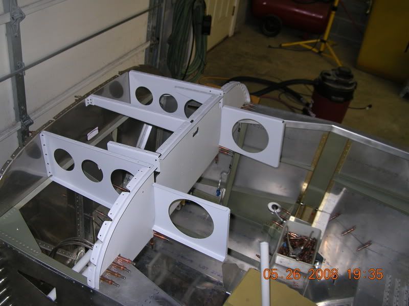

Spent a few hours over the weekend drilling, deburing, dimpling and priming the front deck structure. This took what seemed like forever. I primed it all light grey using my Stewart Systems (AFS) stuff in order to make it easier to see under their when I am upside down under the panel in the future.
I took the hint off Chad's website not to rivet the stub ribs to the center subpanel yet like the directions tell you to. Not sure when to go ahead and rivet this structure to the fuse. I thought it might be nice to wait till I paint the interior but I don't want to paint it too soon and then get in there and mess it all up while working on the canopy.
Should I rivet this all in before working on the canopy?

Looks good! The only thing I riveted together was the F-644 to the center subpanel section using two flush rivets and the F-745's to the side subpanels using two flush rivets so I could move ahead with the canopy frame install. Everything else was clecoed.
Before I mount my engine in the next few weeks, I drilled out the rivets holding the F-745 to the side subpanels. I am going to rivet just the F-745 to the firewall since it would be pretty difficult to do so once the engine is on. I am doing it this way because I know I need to cut the subpanels to accomodate long radios and a map box, but now I don't know exactly where they will go. By just riveting the F-745's to the firewall I give myself a lot of options. If you aren't going to hang an engine anytime soon, my vote is to leave it all clecoed together.

Thanks Mike,
Right now I riveted the panel ribs (never remember the numbers) to the side sub panels with the two flush, I did not rivet the stub ribs yet to the center subpanel. The rest are just clecoed at this time.
I am completely leaving out the hat section (#???) because I am going to use pins or bolts instead of the release mechanism. That stuff is just all in the way of my planed panel layout and I just don't think it is worth fooling with. I can suffer for a minute or two to reach up in there and pull a pin if I need to get the canopy off later.
I guess I will wait if you say I can move forward with the panel without riveting these in permanent just yet. I was afraid something will move around and cause problems.
I plan on adding the forward canopy stop brackets/bolts like others have been doing to prevent the struts from pushing the canopy frame forward. This seems like a really good mod.

I don't think it matters too much either way Brian, as far as riveting the sub-panel in place. I did, and haven't had any need to take anything out or had that thought of "MAN! I wish I hadn't riveted this in already!" The only thing, which you already caught, were the stub ribs. That was a mistake for me.
The stop bolts are a good mod, and very easy to do...
