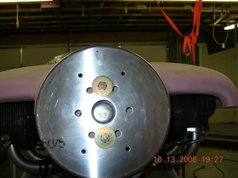

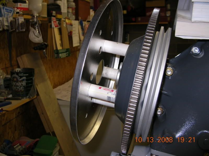

Not much info on here relating to the new Pepto Pink Cowl and its differences with the older ones so I will post pics of how one man is fitting his. I am using the tried and true hinges all around. Cheap and it works!

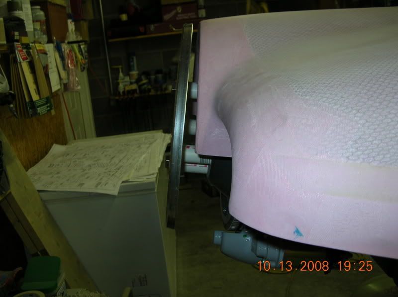

First I had to simulate the prop spacer I do not have yet so I picked up some 3" 1/2-20 fine threaded bolts from the hardware store. Along with the large spinner washers that come in the finish kit, I used these to attach the spinner backplate.
I cut some PVC pipe to make the 2-1/4" spacers. I am going to have a fixed pitch prop. It is my understanding that if your using a CS prop, you need a different length spacer.

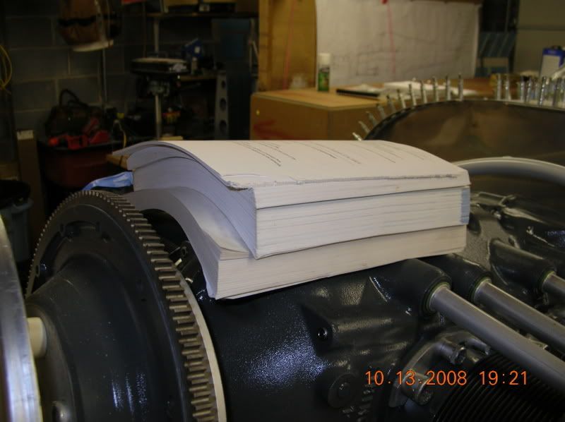

I then used a couple old paper back books as a spacer for getting the top of the cowl aligned with the spinner. I just kept taking pages from the book and fitting the top cowl till the spacing was correct.

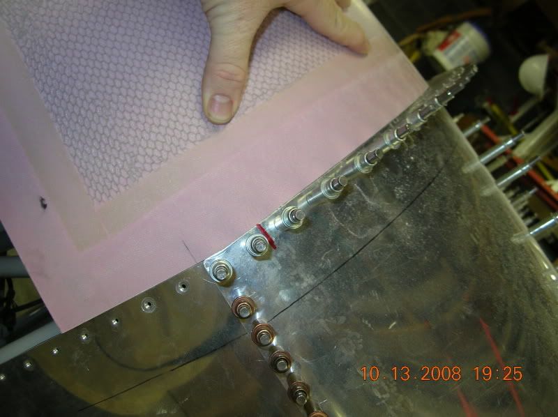

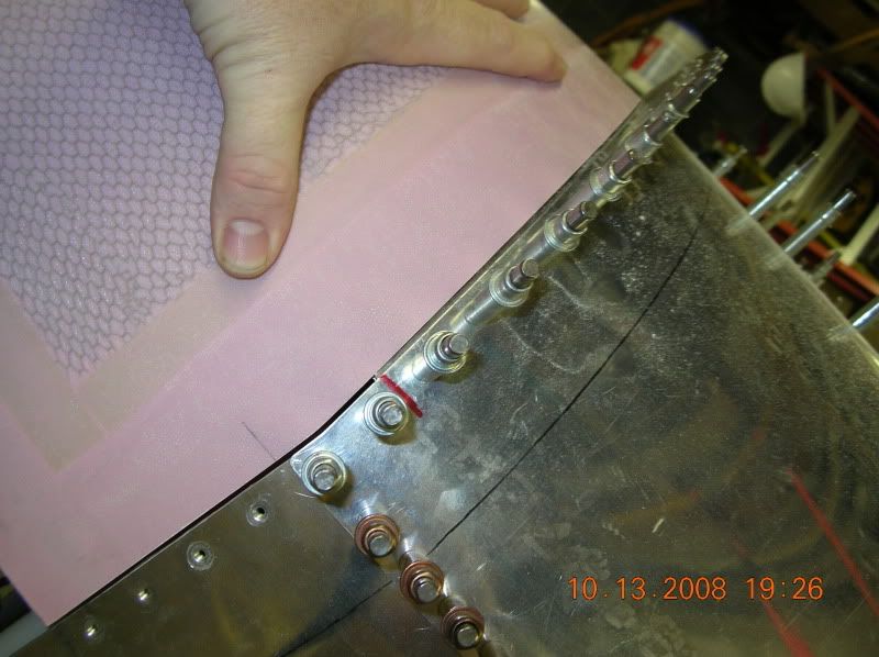

I then cut and drilled the hinges for the top. I spaced them right at the edge of the edge distance requirement for the holes in order to hide as much of the gap as possible between the cowl and the firewall area skins.
I drew a line 2" back from the front edge of the firewall skins, set my spinner to cowl gap at 1/8" and then marked the line onto the top aft side of the cowl. I then cut the top aft end to this mark.
Once this was fitting nice, I set the gap at 1/4" at the front and sanded in a 1/16" gap at the back for paint. I used a 16" long board with 60 grit glued to it for the sanding to ensure a nice straight edge.

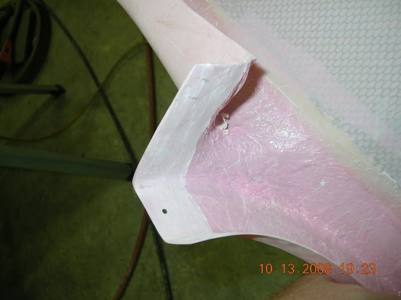

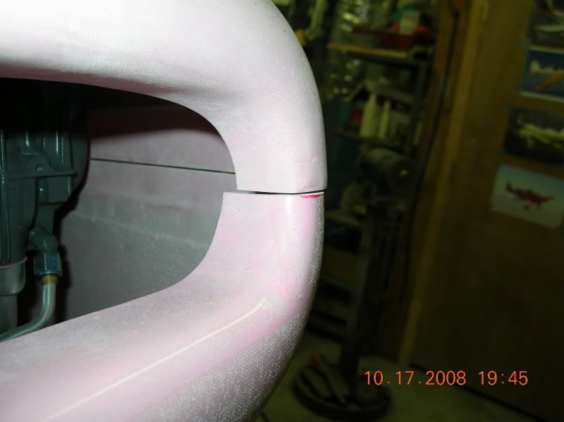

Next I moved on to getting the nose to fit together and round.
I took a Dremel and sanding drum and cleaned up the inside of the top at the overlap areas.
I also took a file and cleaned up the molded in flanges at the center of the bottom at the overlap areas.

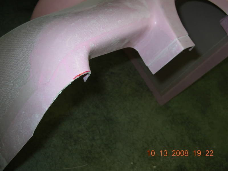

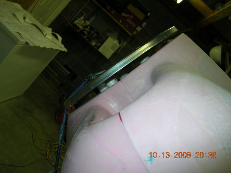

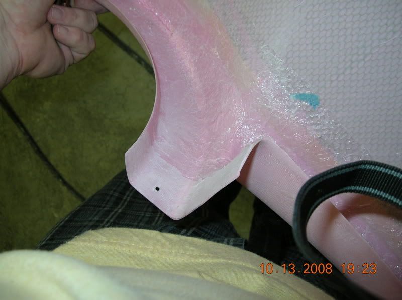

In order for the two to go together, I had to mark a line so I would know how to cut the outsides of the inlets on the bottom cowl. I put a straight edge on the molded in flanges of the center of the bottom half and extended this line out to the outside of the inlets. I cut this off at that point but just to outside of the curve because I did not want to cut any off the sides at this point.
Posts: 1033
I was then able to get the two halves together pretty nice at the front. It will require some tweaking to get the seams perfect but so far so good. I did not want to drill any side holes yet so I just joined them with a temporary hole at the front. This holds them together and pulls them into each other. Problem with this is that the clecos will hit either the spinner backplate or the starter gear/flywheel.

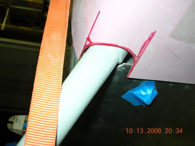

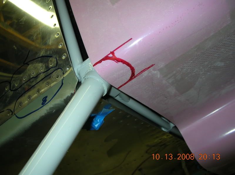

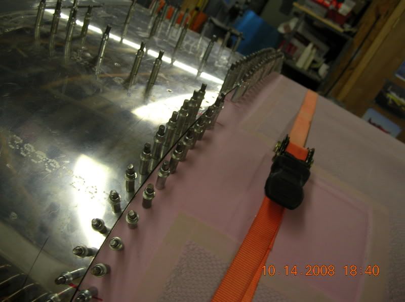

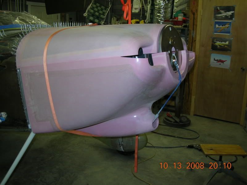

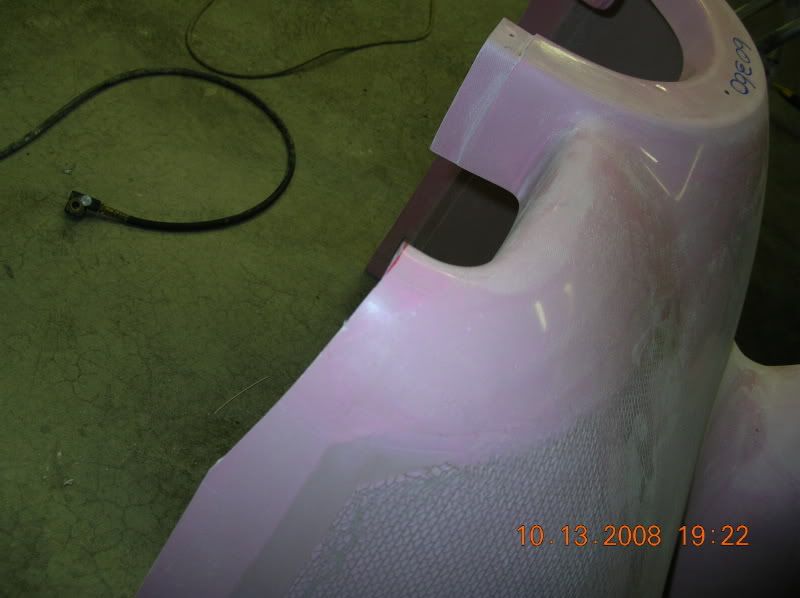

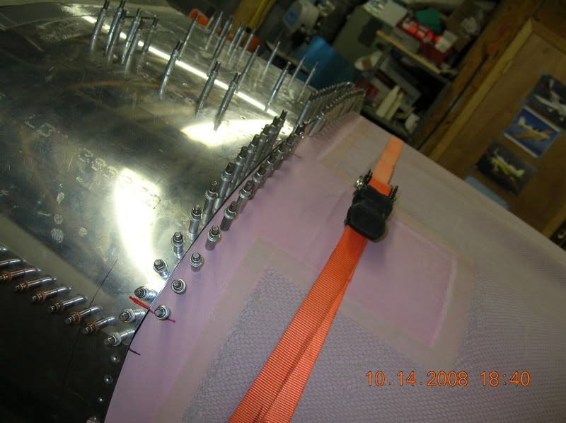

Once this was done, I hoisted the bottom up into place the best I could using a strap and a bungee cord or two. The goal was to get it close enough to know where to cut for the gear legs.

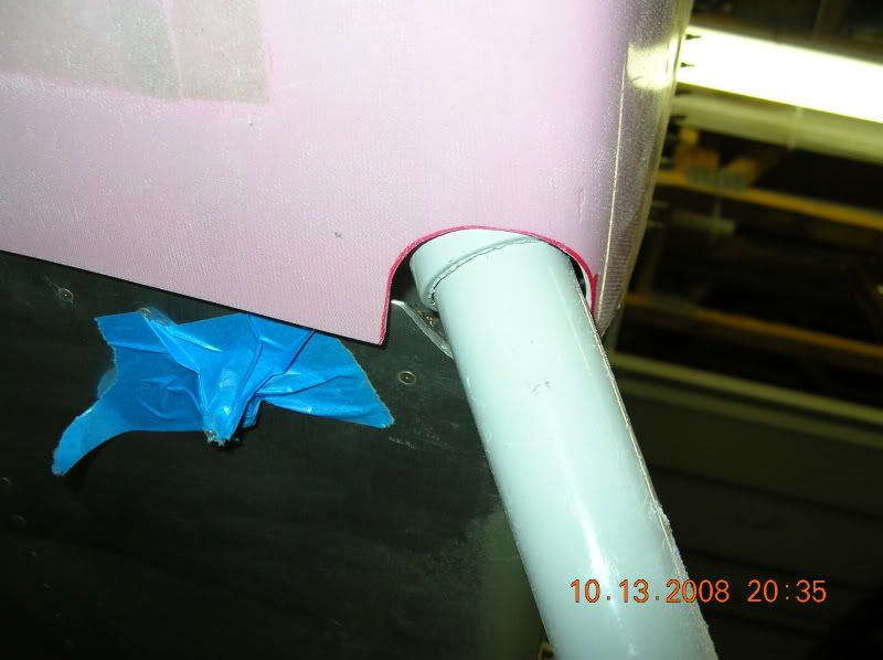

I then marked a cuttout on both sides of the bottom for the gear leg clearances...
And cut them out..They will need opened up more for brake lines etc. later.

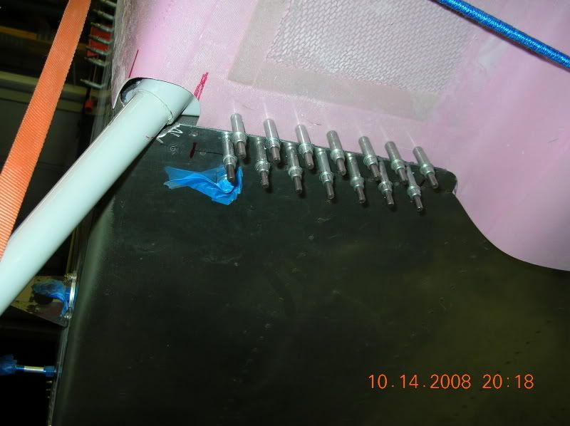

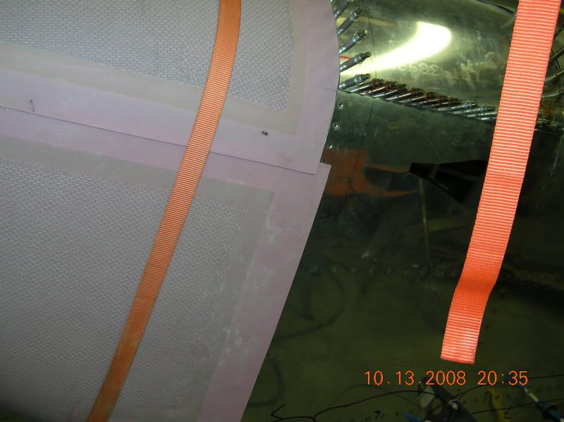

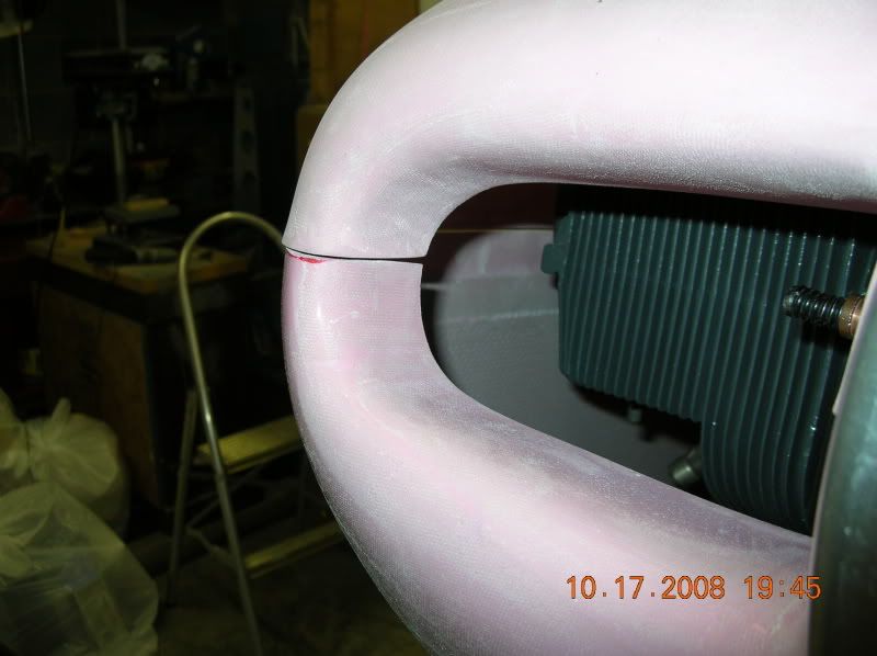

With that done, I was able to pull the bottom up into place to meet the top.
I just let the sides overlap the firewall and the top cowl all around. The front was able to be pulled into position. I used a strap and a bungee to hold it in place.
The fit at the outsides of the inlets at the seam don't look too bad at this point. Should get even better once the sides are not overlapping each other....
This will take some fill work to build it out even. At this point once I set the 1/16" paint gap at the back, it has about a 5/16" gap at the top. I do not want it any closer because that makes the top hard to get on and off later. As you can see the front is not molded properly.

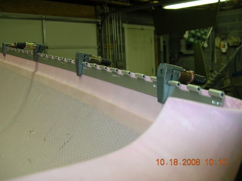

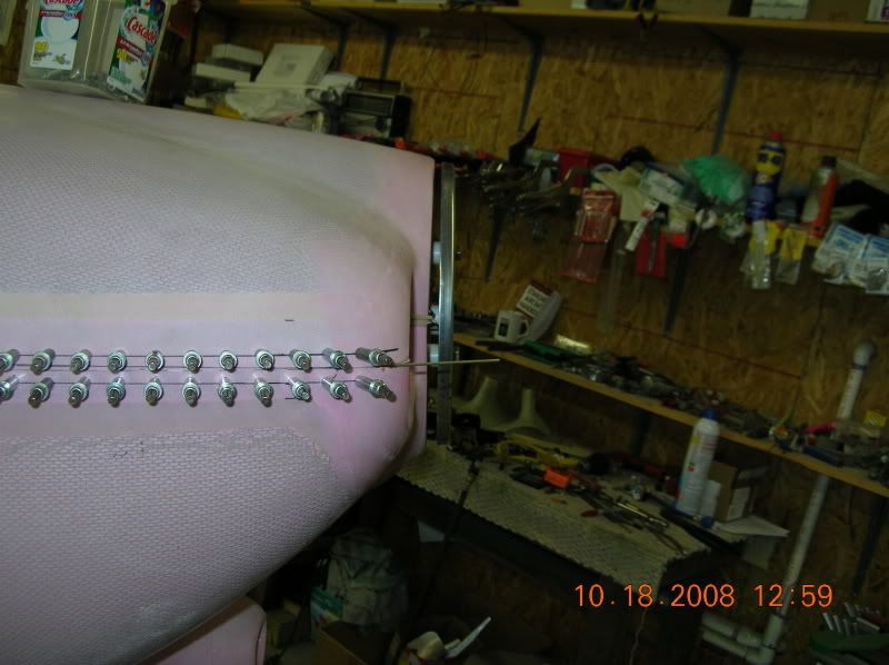

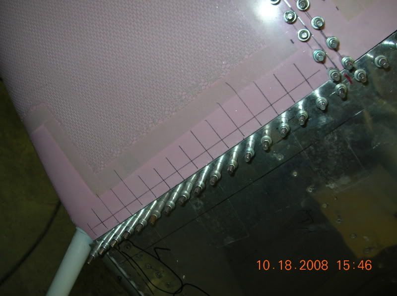

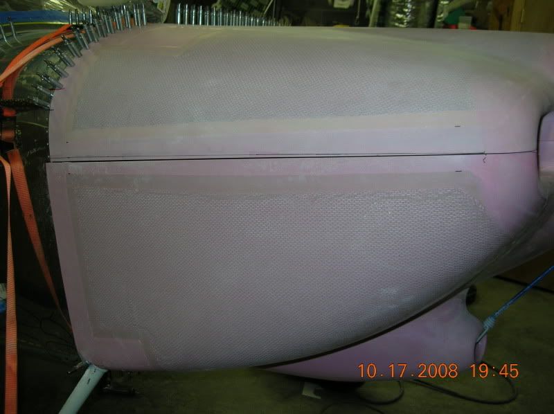

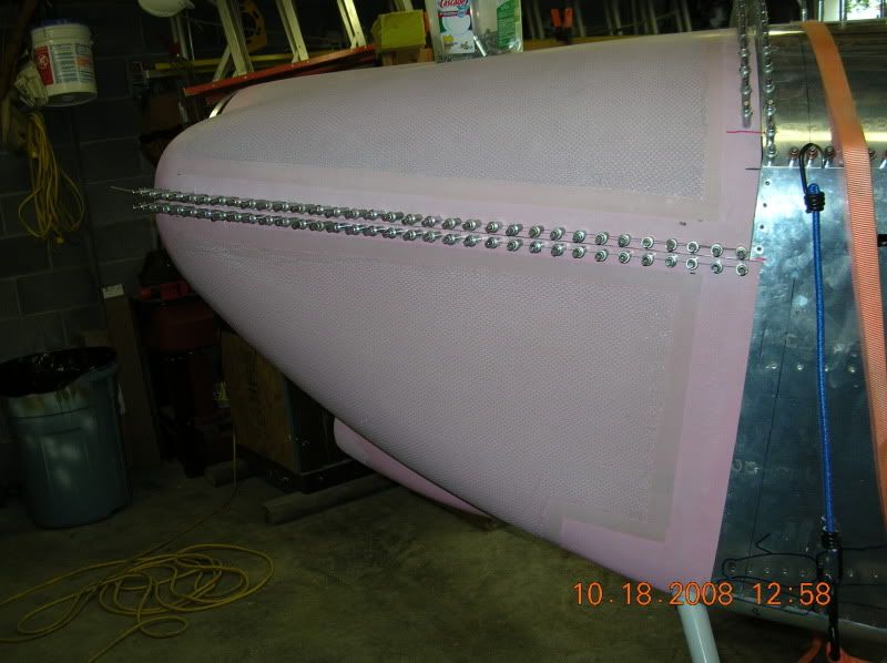

Today I worked on getting the top drilled to the hinges and worked on the fit of the bottom.
I ensured that I had the top exactly where I wanted it and proceeded to drill the top hinges. I left ~1/16 gap for paint. I started in the middle and worked down the sides.
I think when I rivet the hinges on, I will put some flat strip stock in to hide the gaps where there is no hinge material. I think this will loook better and camouflage those areas once it is painted.

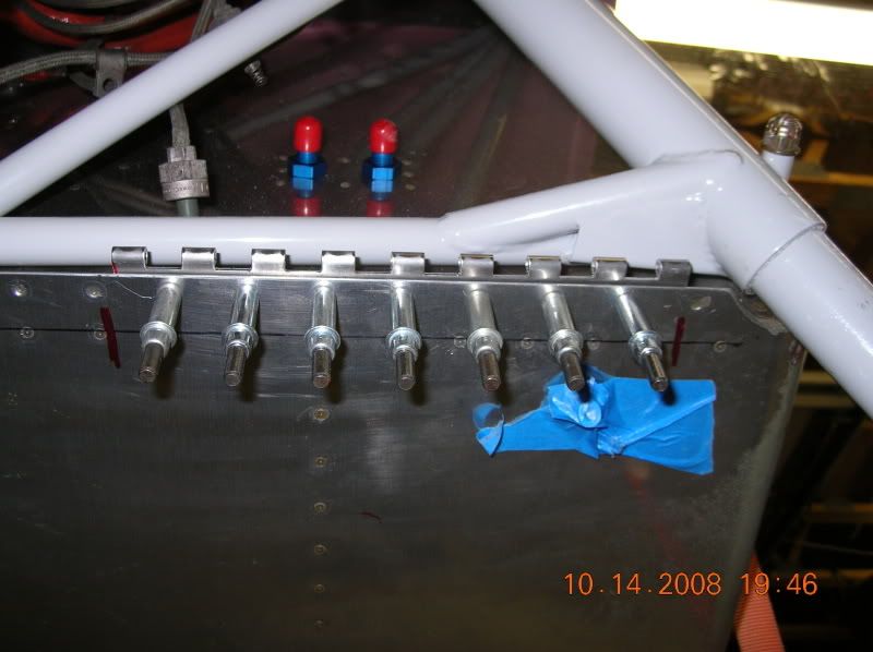

I then lifted the bottom up into place and ensured a nice fit to the top and then marked for the bottom trim line and the bottom hinges.
I cut the bottom from the sides just up to the radius of the exhaust outlet area. I will leave that part long till later.
I then drilled and clecoed the bottom hinges. Put the bottom back on and drilled and clecoed the hinge to the bottom cowl.
Like all the other hinges I have drilled, I am going to the limit on edge distance on the holes in an effort to hide the eylets of the hinge behind the glass. This little stickout seems to do that quite well.
Next session I will work on the horizontal fit between the two halves. I will not cut the overlap off of the bottom sides where they overlap the fuse till I have the horizontal hinge installed.

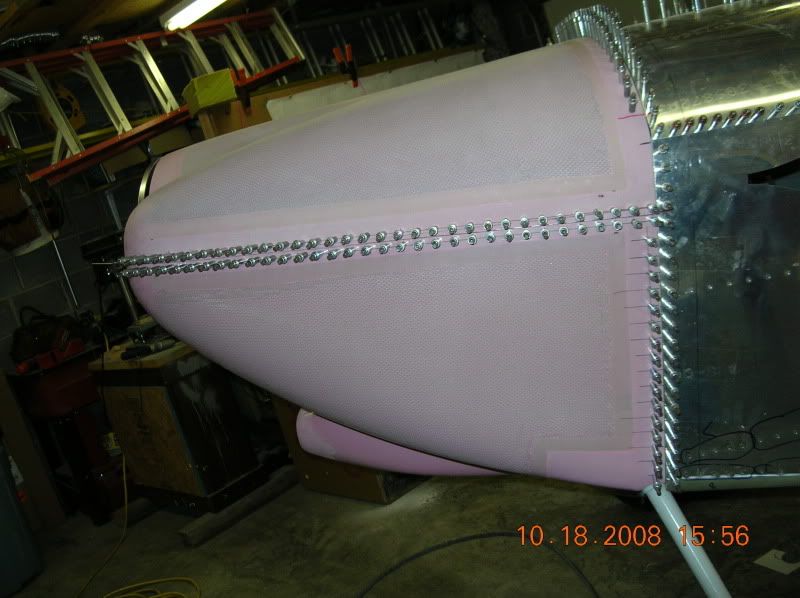

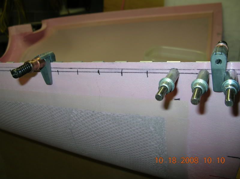

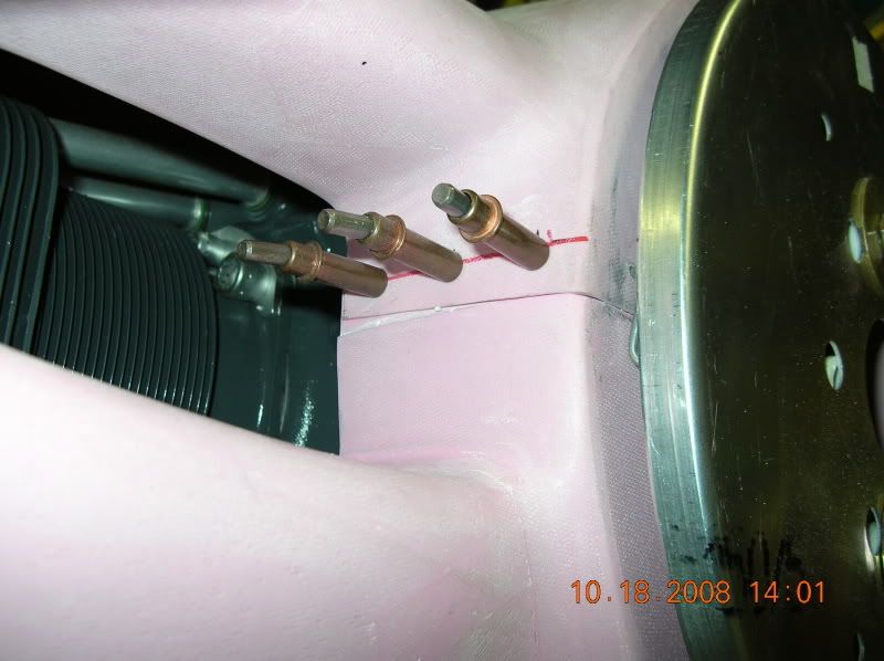

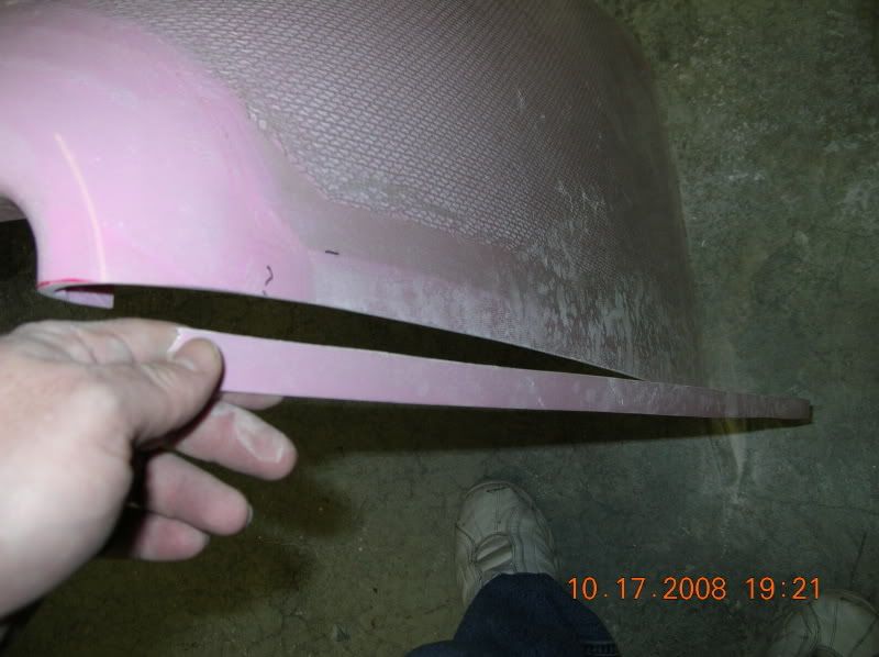

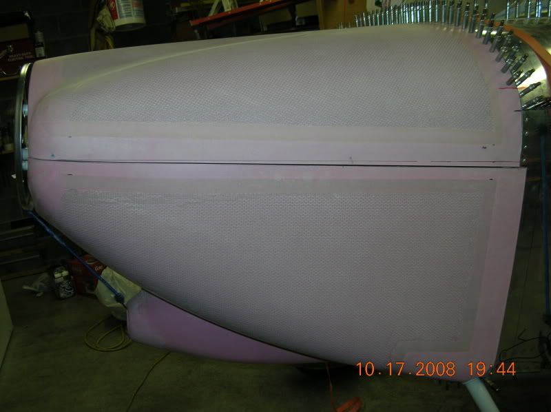

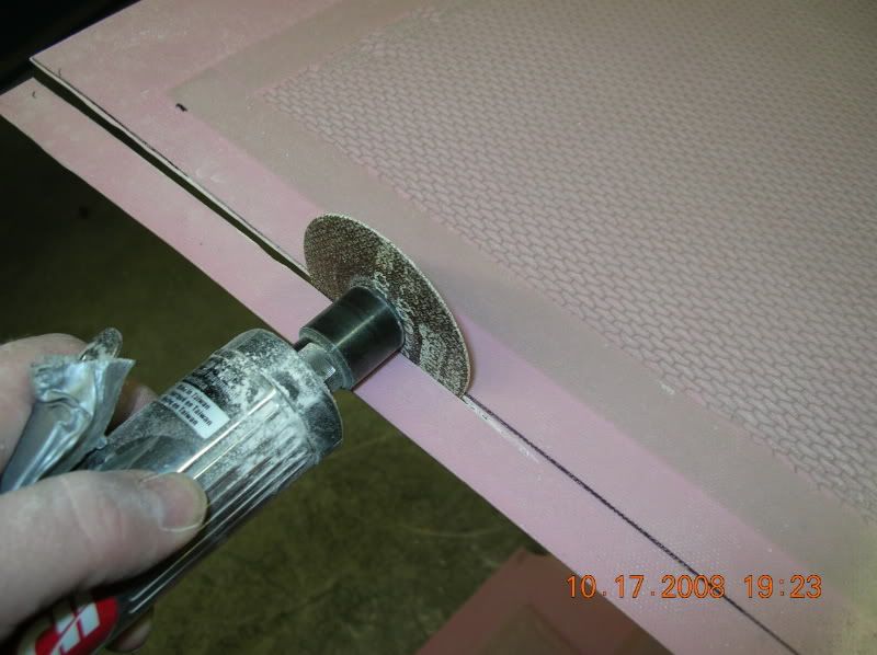

Yesturday I got started trimming the lower cowl to fit the upper one. Out of the box, the upper cowl's outer lower edge seems to be where they intended the split line to be.

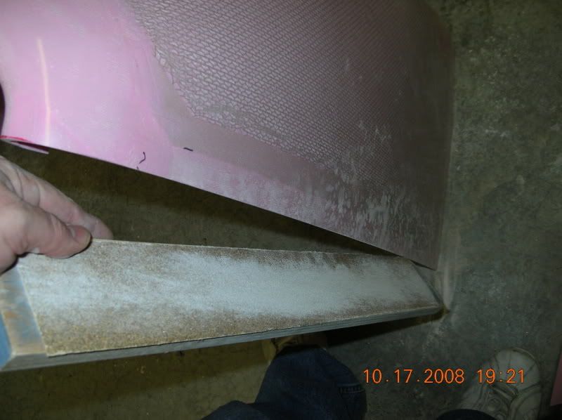

I sanded the upper cowl's edge straight using a very long sanding block.
Then I put it all back on the plane and marked the cut line on the bottom cowl that was underlapped by the top.
Put it all back together to check the fit. I sanded the bottoms edge straight with the long block.
Now you can finally see how the areas around the outsides of the inlets are going to fit. These are pretty good. Just a small amount of filler will make them nice.

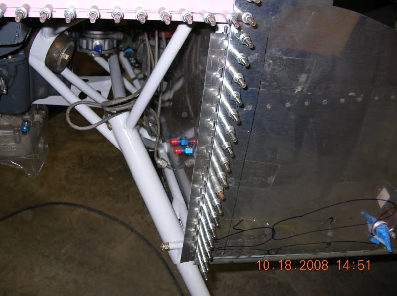

Then I marked, cut, and sanded the aft sides of the bottom to the firewall. Used packing tape to hold the hinge straight for drilling.
Once the side was cut and I had a paint line relief sanded in, I marked and drilled the aft side hinges on the bottom.
And thats about it! I call the fitting complete on this cowl!
Just a little more cosmetic work to do and after riveting on the hinges, I get to do several hours of pinhole filling!
I started on this a couple hours Monday night and worked on it a couple hours each Tuesday and Friday evening and about 5 hours today to get to this point.
If your following this, good luck with yours and your results may vary :roll:

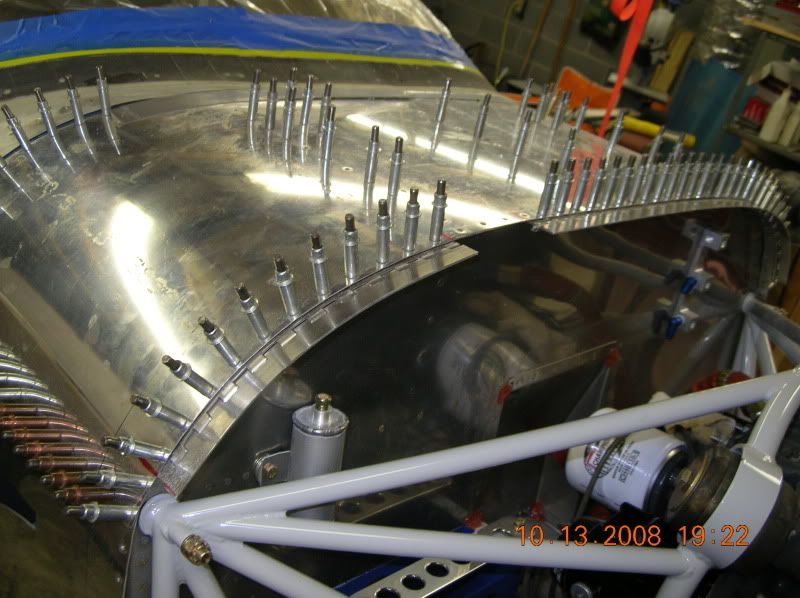

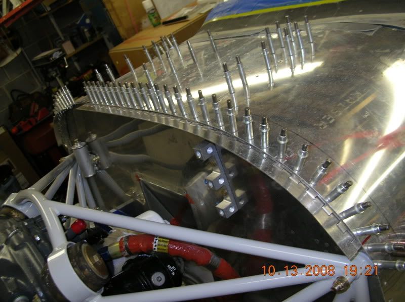

Last evening, I riveted the hinges to the firewall on the sides and bottoms. Top will be staying clecoed till I am ready to rivet the top forward skin on for good. Had to use a few blind rivets because of the engine mount. I made a special extension die for the 4" no hole yoke I had by cutting the head off of a hex head bolt. Tapped it to the no hole for clearance around the eyes of the hinges. The bottom three on the sides and the outboard one on the bottom had to have blinds. I used MK319-BS on all but the bottom hole on the sides. Here I used a CS4-4 because of the extra grip length needed. Most say rivet these on before the engine mount goes on but I don't know how you can do this without fitting the cowl first to know where to end the hinges on the side.
Next is countersinking about a million holes in the cowl and epoxy/flox/rivet the hinges on the fiberglass parts.
