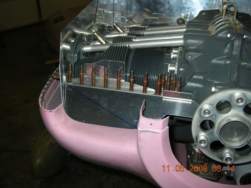

Been working on baffles lately.....

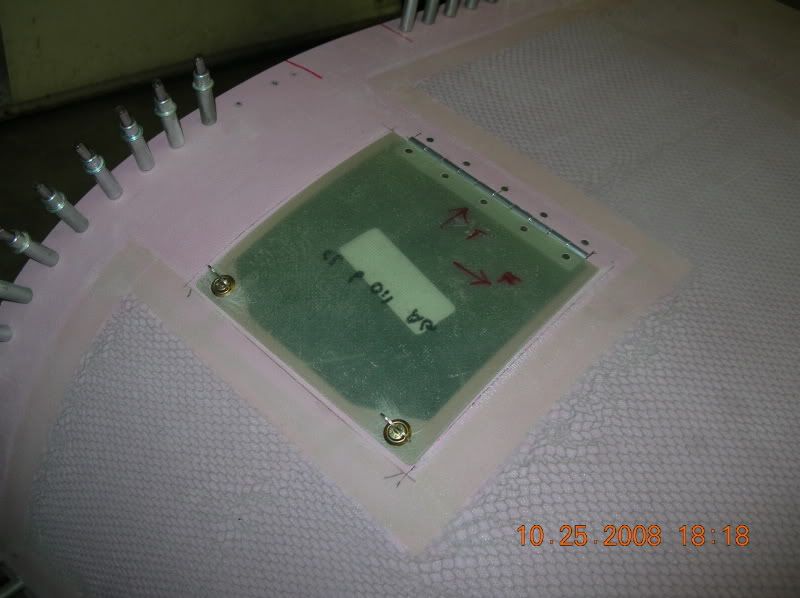

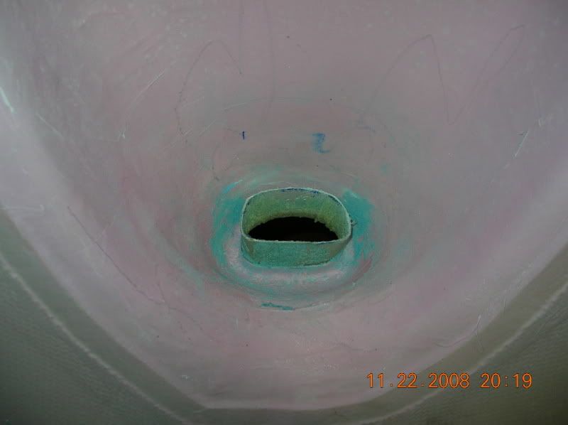

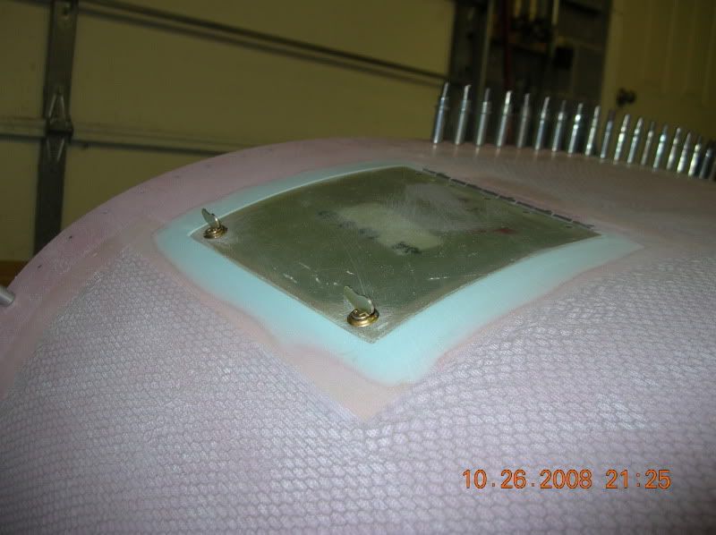

A few days ago I completed the oil door install. Since I am poor and trying to save for avionics, I went standard Vans on the hinge and the fasteners. Cheap, works and does not look that bad!
I cut the door undersize to get it down on the flat part of the molded in recess and then used packing tape and Superfill to fill and fair in the door. Looks pretty good.
This gave me a square edge around the door opening which looks much better. Not sure why Van's does not mold the recess with square edges instead of radiused ones.
If I had it to do over, I would not cut the hole in the cowl until after I had the door sized. I still have a nice flange around under the door but it was close on the camlocks.

looks just like mine less the stffeners i put on the back of mine. i hear they door will bulge in flight w/o them.

Brantel wrote: This gave me a square edge around the door opening which looks much better. Not sure why Van's does not mold the recess with square edges instead of radiused ones.
I dont know if this relates, but when I was going to aircraft structural/sheetmetal training, we were taught to radius everything. They told us that sharp corners is a concentration point for stresses leading to stress corrosion cracking.

this is a fiberglass part that is radiused in its original design and only cosmetically made with sharp edges. the component that is sharp edged is a non structural component and will not likely change the stress risers if there is any...

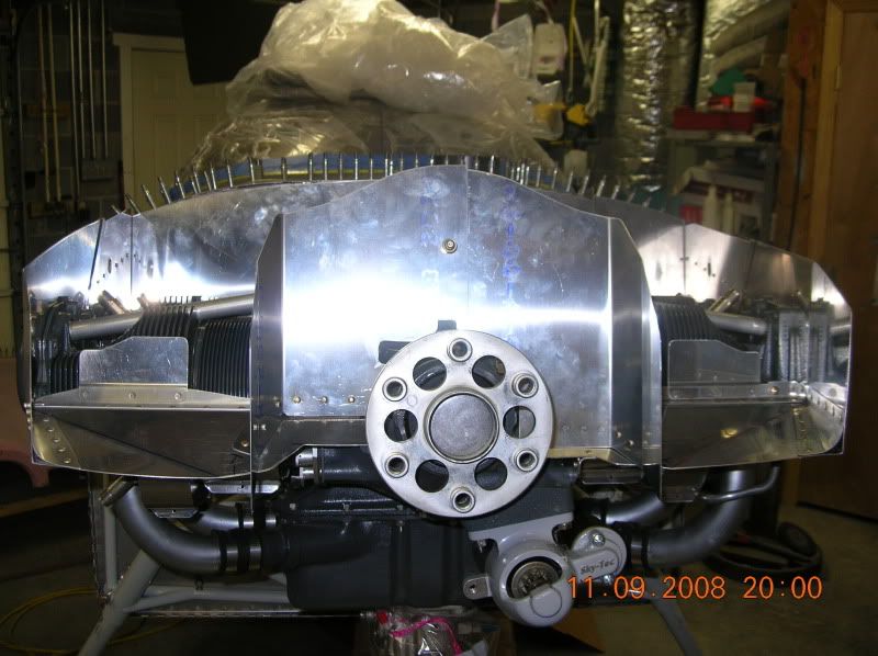

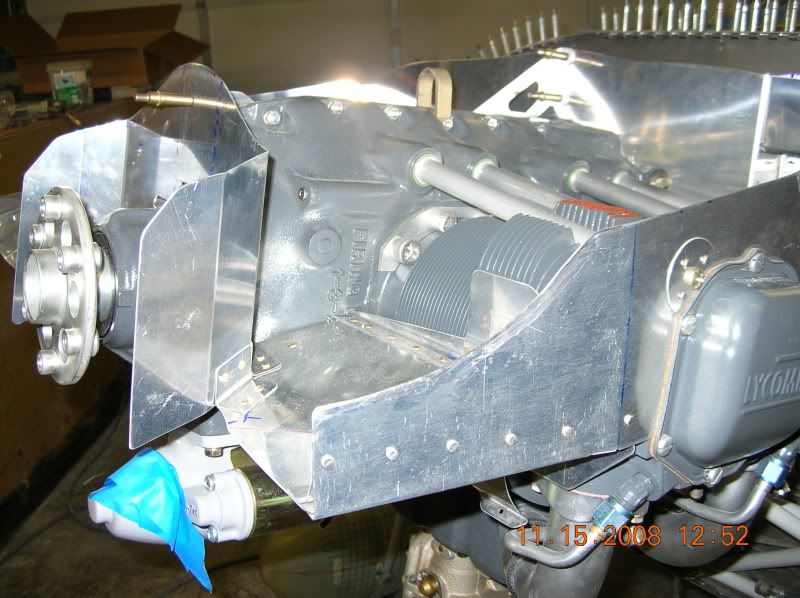

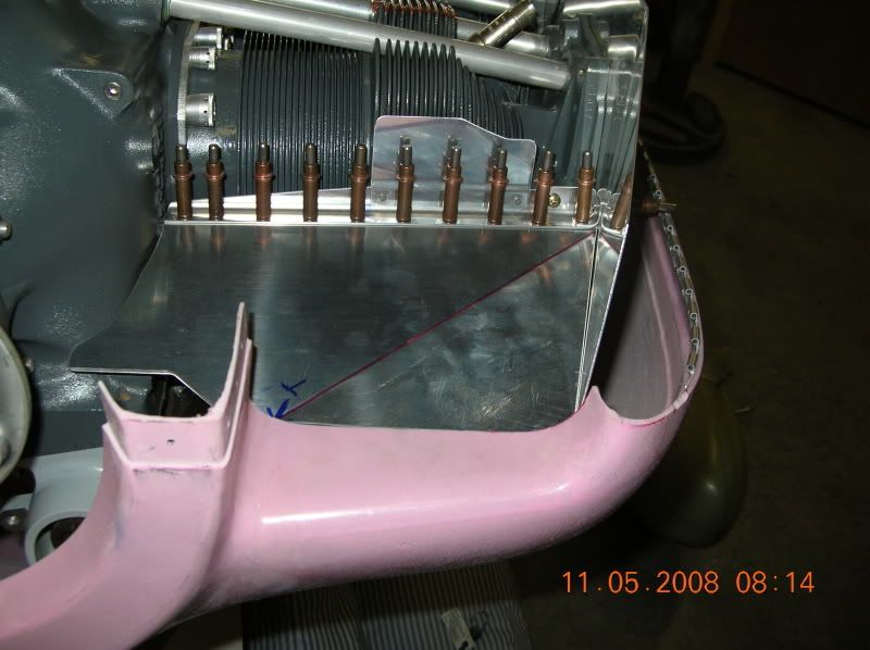

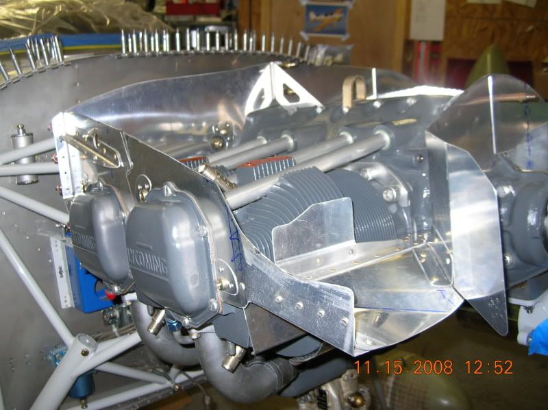

Been working on baffles. I have the new latest and greatest redesigned baffle kit from Vans... It has been some work trimming it to fit my narrow deck engine. There are more fillets, bosses and areas of reinforcement on the narrow deck which interfear with the cutouts for the engine.
Anyway, I have most of it on there at this point and the lower cowl fitting up to the intake areas. Lots more work to do before these are finished. I am just taking my time and making small trims here and there to get it to fit.

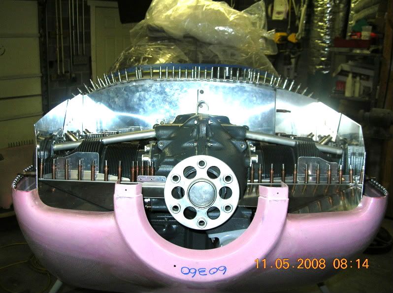

Here is the time eating details that I have been working on the past few weeks.
I finished up the baffles less the seal at the top:

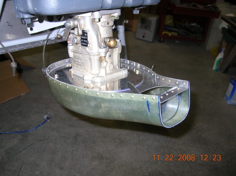

Built this little pain in the rear, those that have not made this yet and are using a vertical induction, just go ahead and order you some stock to make the carb mount plate out of because you will need to shift the airbox over to the co-pilot side to prevent the box from hitting the cowl scoop when it shakes.....:
Finished epoxying and riveting the hinges to the top cowl and made this little extension to the inlet. This does not look like much but it is a ton of work!

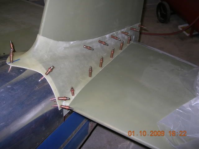

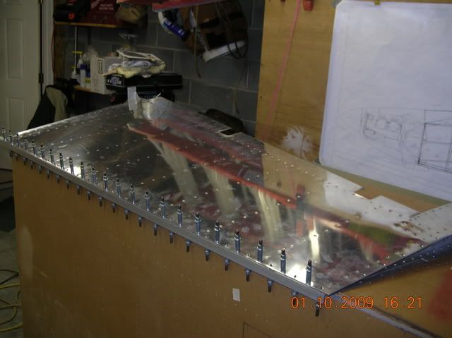

About to wrap up the replacement larger rudder project. It seems so long ago since I built the original (about 10 years ago!). Learn something new everyday. This newer trailing edge design is greek to me.
I pro-sealed it up and cleco'd it to a piece of angle. I will wait a few days before trying my hand at double flush rivets.....

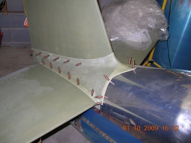

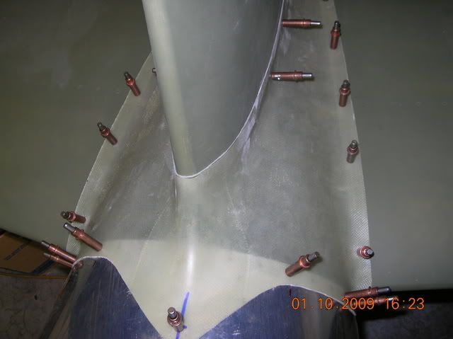

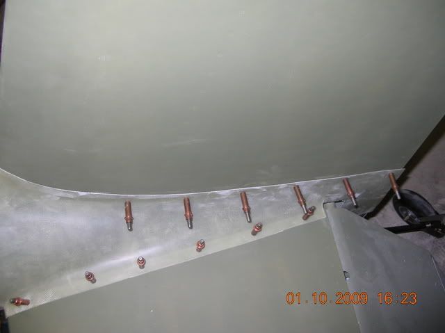

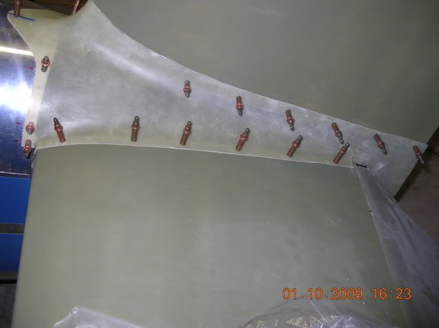

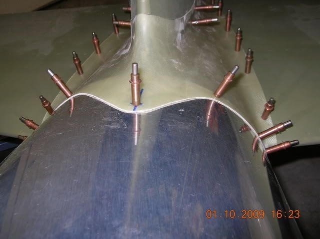

Anyway, today I worked on fitting the emp fairing. This is the stock fairing and I must be the luckiest person on Earth because this thing actually fits! All I did was cut it at the scribe line and drill it to the emp!
I was shocked since most people hate this thing!

I noticed you clecoed on some angle to keep your rudder trailing edge straight. Good! When I went to my builders workshop, Tom Emery recommended after the proseal dries to open up every other hole on the angle to at least the size of a squeezer die. The idea is to leave the angle clecoed to the trailing edge and squeeze every other rivet (i.e set it before you backrivet it). From what Tom said, even prosealed the trailing edge can still walk a little. Leaving the angle on as long as possible and setting half of the rivets will guarantee it being straight.
