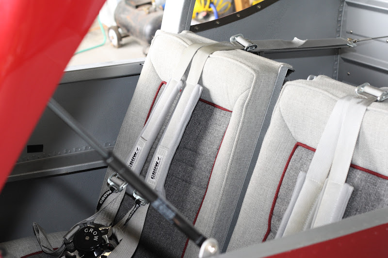

I took some interior shots today and will post em up this evening.
