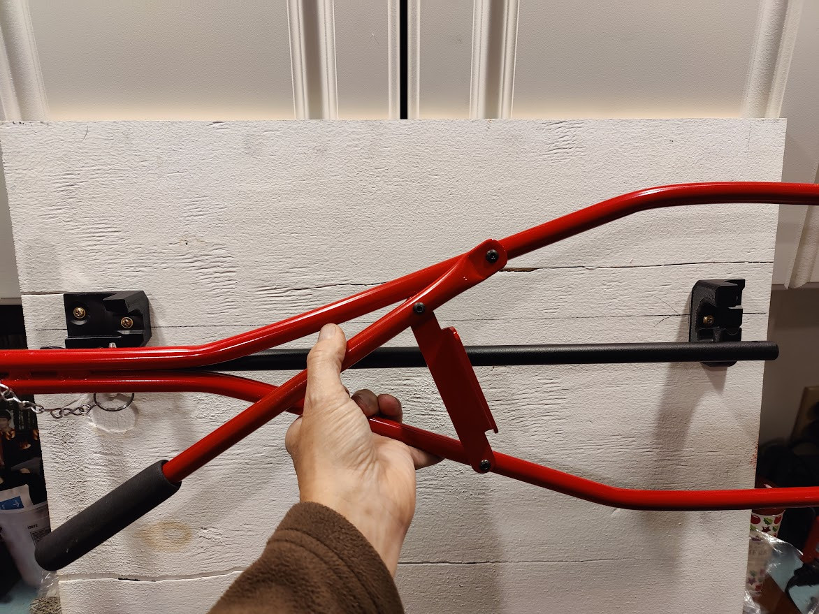

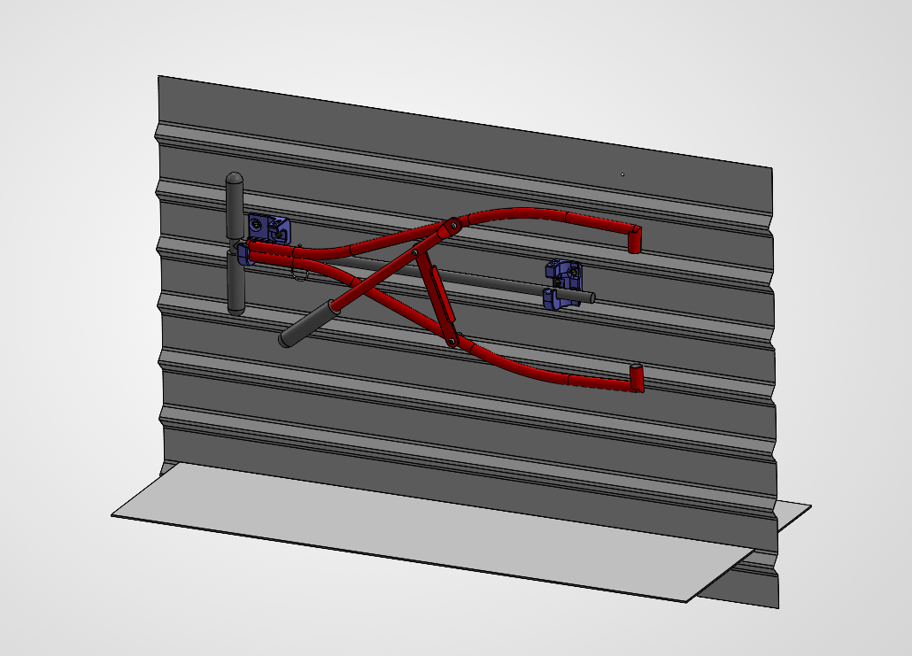

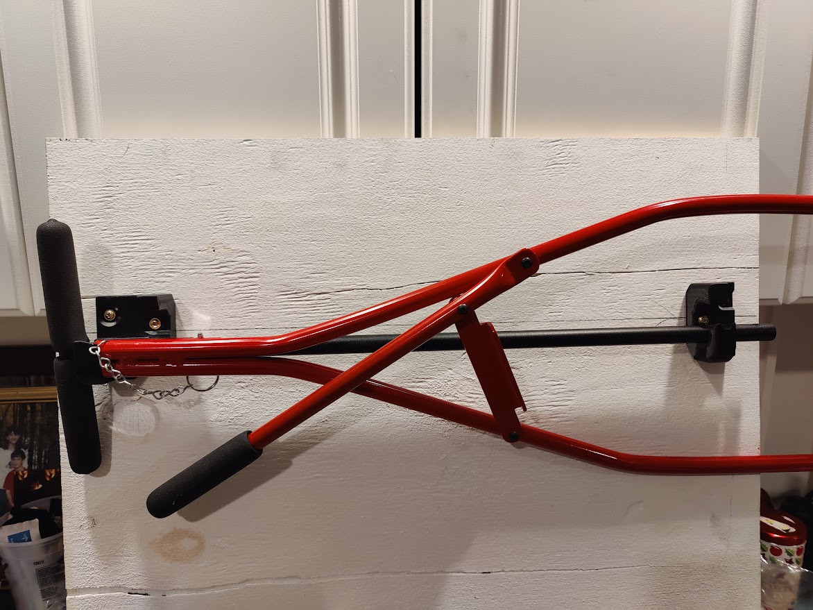

RV10 Bogi tow bar brackets testing. This tow bar mount requires to pins or clamps as it has self-retaining features...
This is coming along nicely. Overall, the shake test was good. At a -10-degree pitch with vigorous shaking, I was able to dislodge it. I'm adding some small feature adjustments (less than 0.1 inch) to hopefully improve that. Also, I'm modifying a cutout for better screw installation. The second print is underway, and so far, I am very happy with this as it is very easy to insert the tow bar.
Posts: 2196
Re: A couple printed widgets
The RV10 Bogi tow bar mount now meets the -10 degree pitch self-retaining feature with the latest enhancements. The tow bar can still be removed easily when positioned perfectly horizontal. This design is especially handy for the RV10, where access is tight and often requires coming through the door at an angle.
