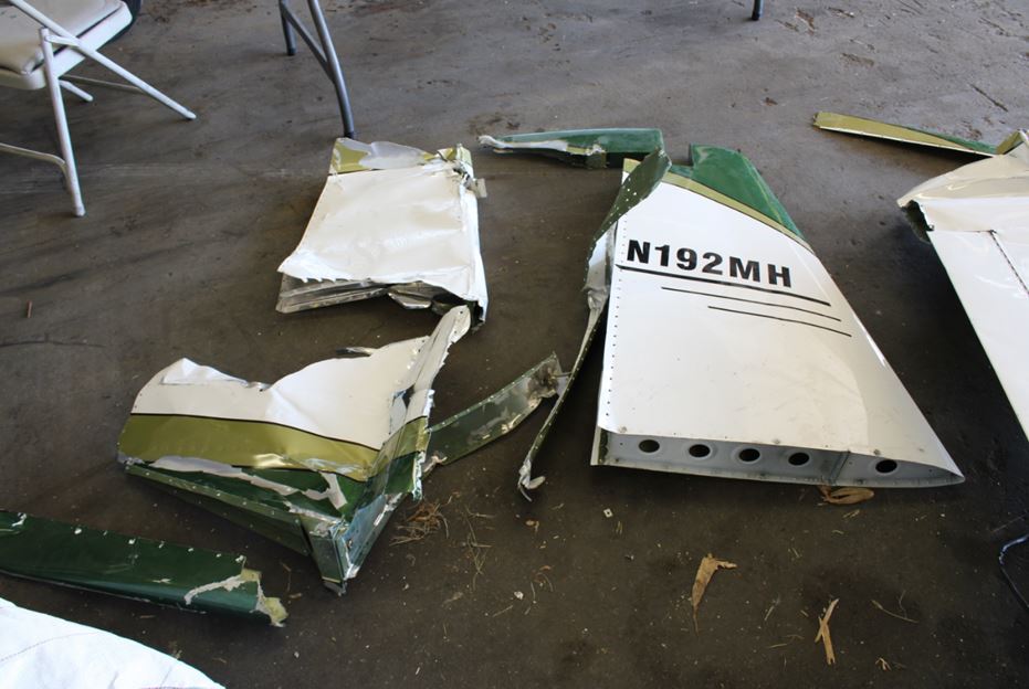

preliminary - in-flight breakup
preliminary report. in-flight breakup. I believe this is the 2nd RV9A to go down in a thunderstorm. possible overspeed, rudder and vertical stab separation found first, then horizontal stab and wing, then the rest of the aircraft. that is the typical pattern of an RV in-flight breakup. in an RV9, it doesn't take very long to exceed Vne in a descent. pushing too hard to get to Oshkosh. message: forget the Oshkosh marketing hype - those guys get paid to hype-it-up.

The vertical stabilizer and rudder were found 0.61 to 0.63 nautical miles southwest of the main wreckage, respectively, and exhibited overload signatures consistent with an in-flight breakup.

N192MH; it appears this aircraft was using the heavy wheelen tail strobe and had glassed in both the upper and lower fiberglass fairing. both of these actions add weight to the rudder in the worse possible places and will lower the rudder flutter speed.
wheelen tail strobe installation assembly = +1/3 lb
glassed-in tip fairings = +1/4 lb (maybe more, how do you know?)
I believe Van's should issue a SB about the rudder to avoid adding unnecessary weights that will adversely affect rudder flutter speed. folks may think they are making it better, when they are making it worse. they just don't know the fundamentals. this is serious business.

well, this is a classic example of spatial disorientation, losing control and exceeding Vne and breaking up in-flight. RV aircraft are especially susceptible to this because they are relatively clean airframes and delicate machines. the pilot must maintain control. this occurred on the way to Oshkosh and perhaps some "get-there-itis" was in play. the wing spar cap failed too and amazing that some people on the ground actually heard a snap sound. it is a long and detailed good report.

The non-instrument-rated pilot’s decision to continue visual flight into instrument meteorological conditions, which resulted in spatial disorientation, a loss of control, exceedance of the airplane’s design limitations, and in-flight breakup of the airplane due to rudder flutter.
full blown flutter is a violent event.
