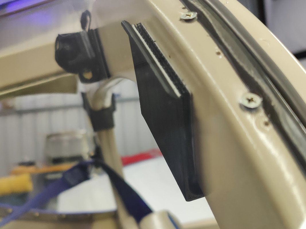

Re: a couple printed widgets

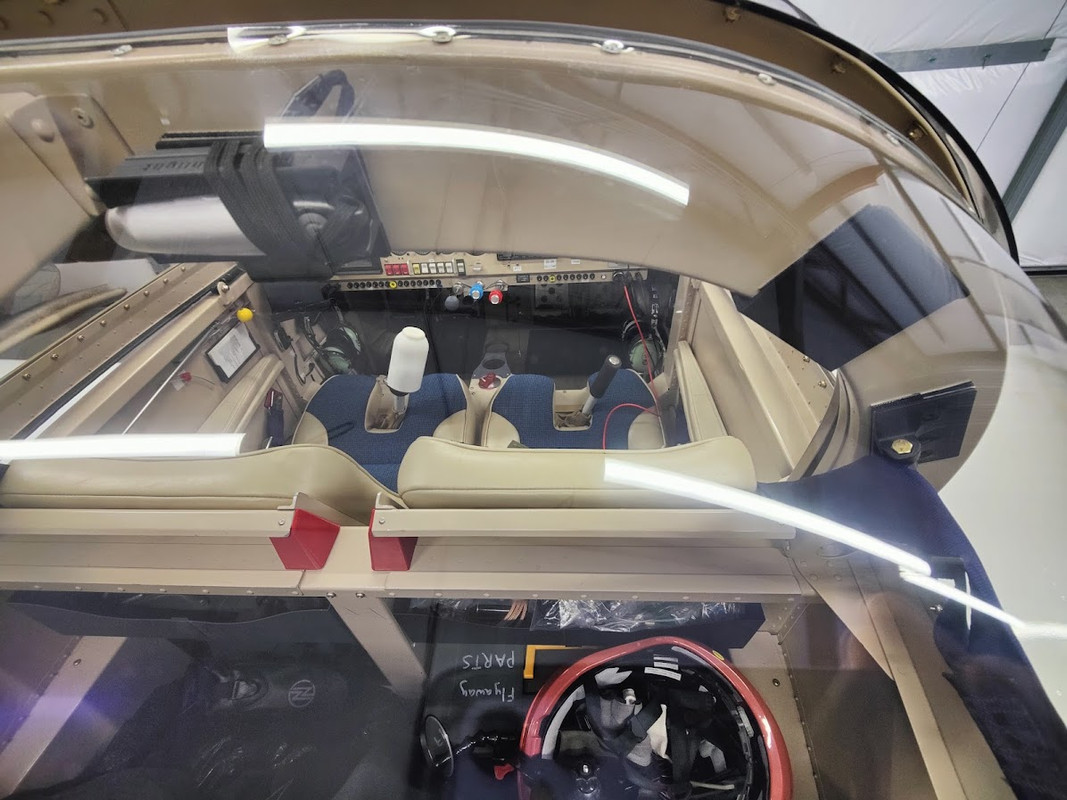

hand grip for my wife's side. fits to the roll bar. I like the one on my side. I need to remember to lift my ass over it, but I'm getting better. the benefit of a secure grip is worth it. sometimes it is wet, or I have a bike on my shoulder, or both. this is how I print it. you may notice the designed slight inward bending. the inside fits the curved inner surface of the roll bar perfectly when installed at 45 degrees or close to that. this is an easy one to print at home. the recess is for any protruding rivets. material is ASA so it can take the heat and UV. 3M dual lock to the backside. if she doesn't like it, take it off, no harm done, but I think she will like it.

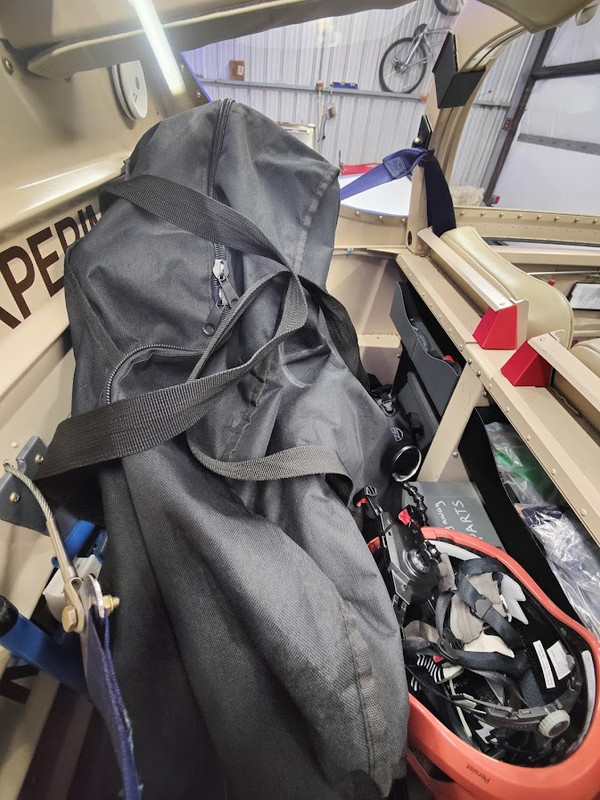

passenger side hand grip installed to the roll bar. I have a lot of stuff attached to the backside or the roll bar. I use all of it. the baggage area is also fully used. the grip fit was perfect. 15-minute install time. plastic weight = 43 grams.

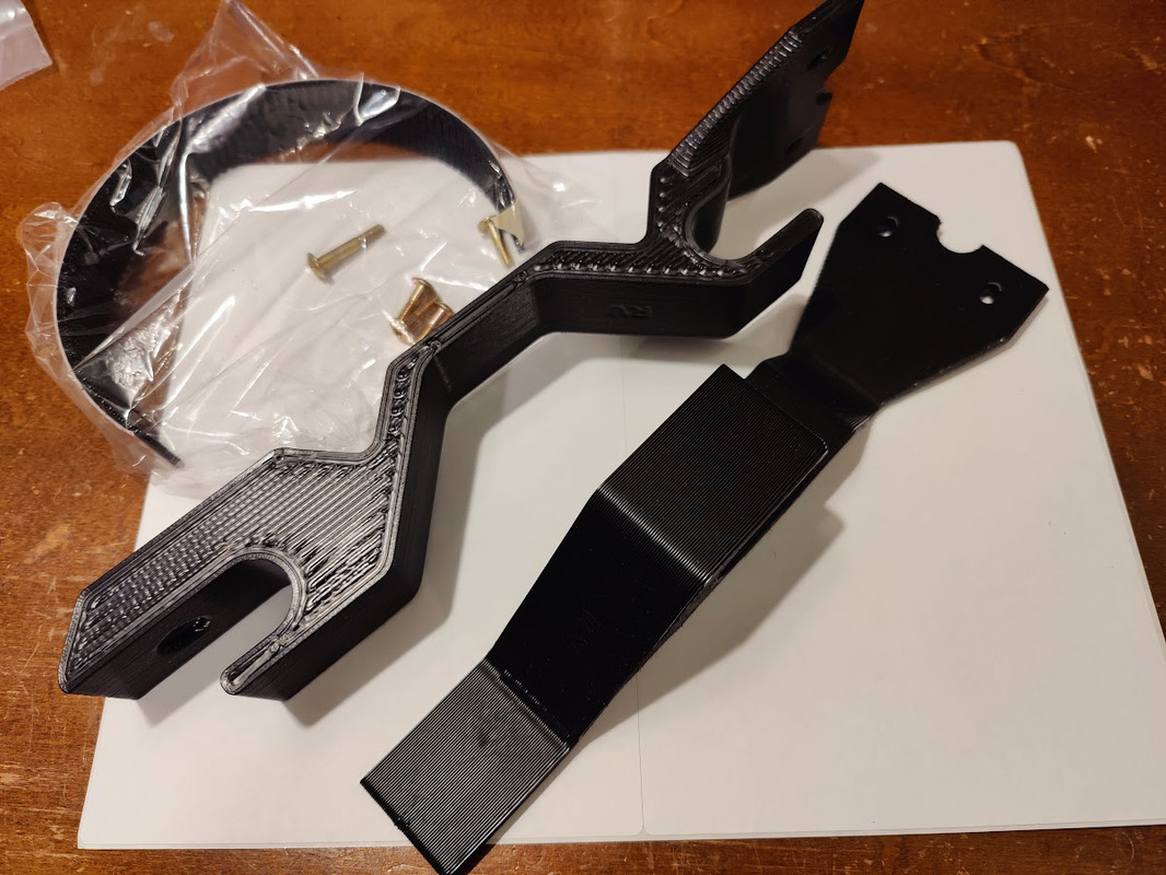

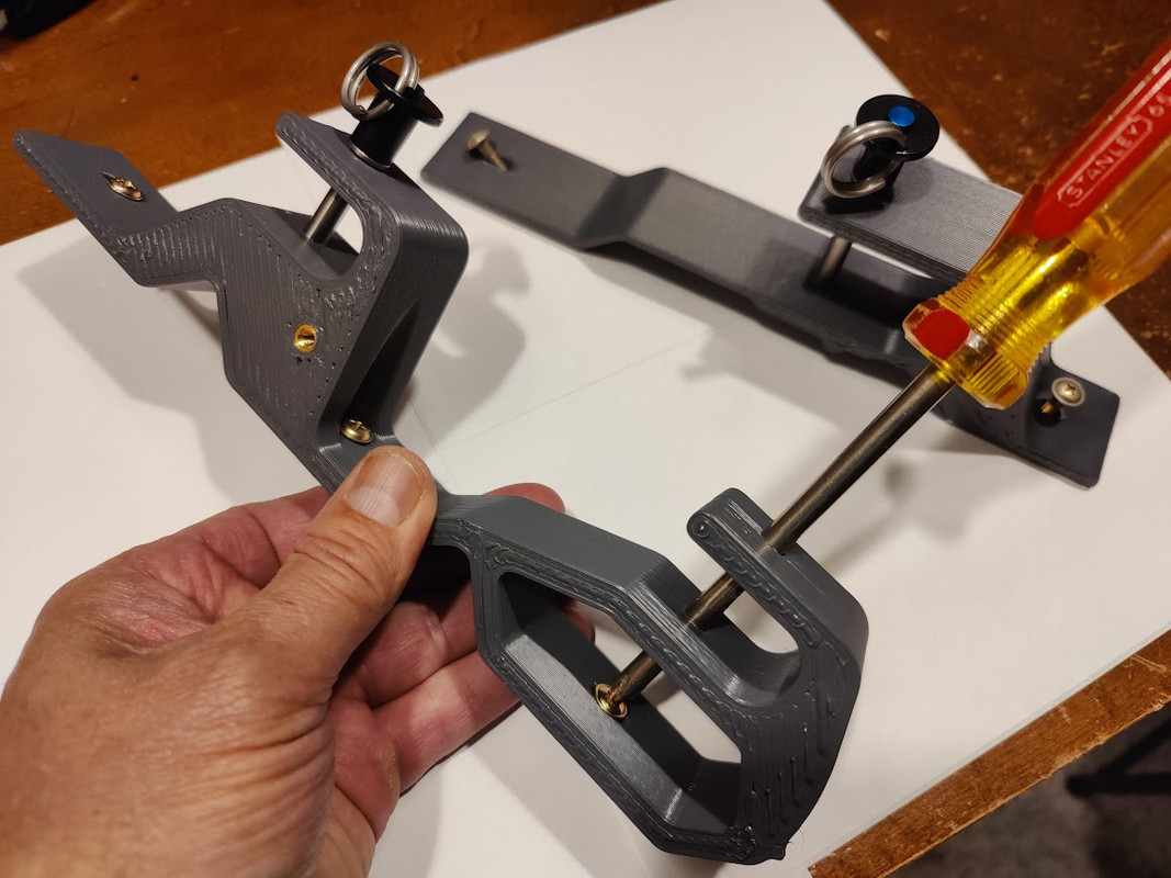

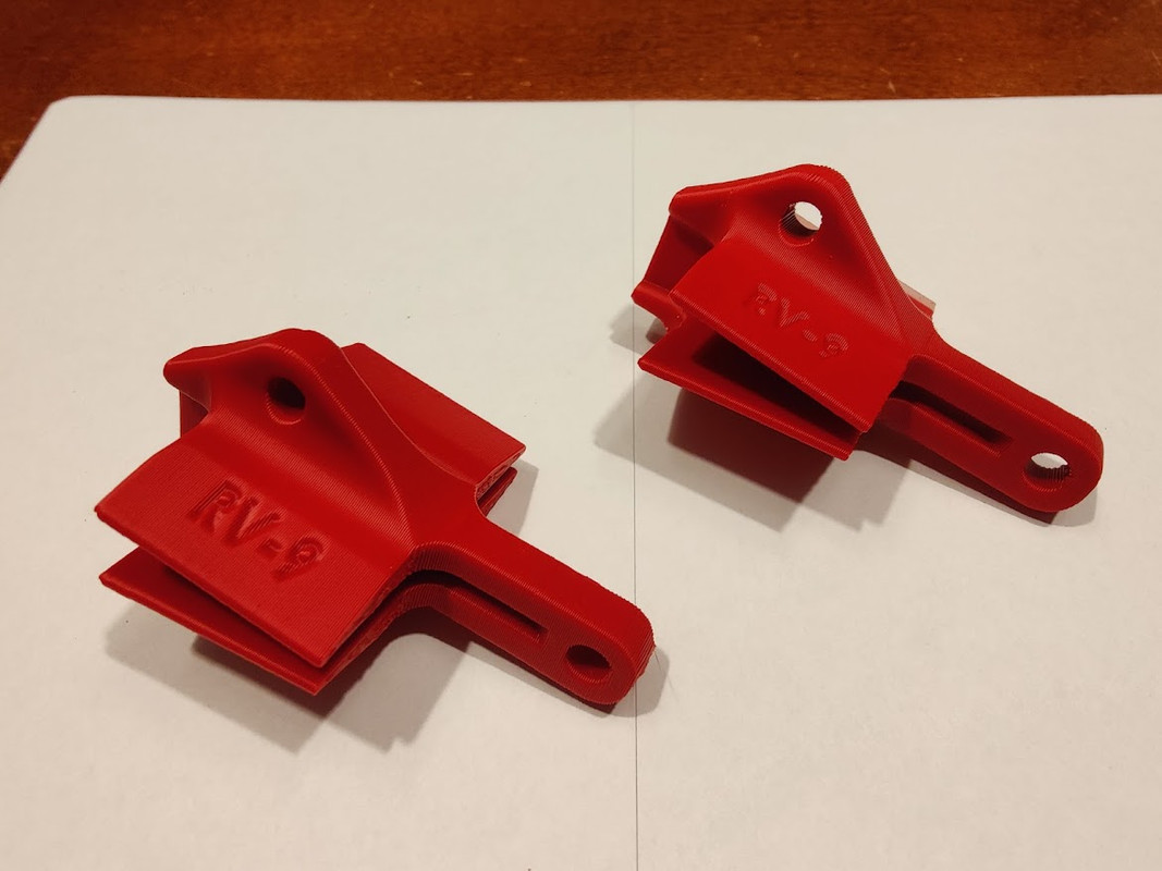

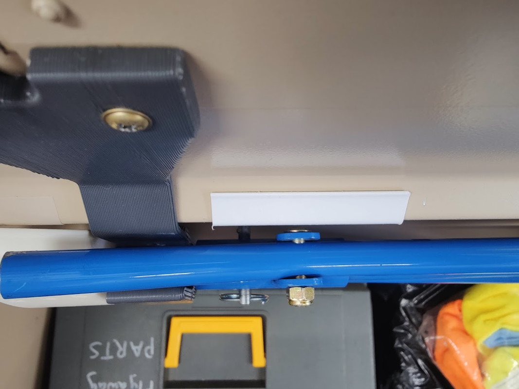

Wag-Aero tow bar brackets. sometimes I look back at a design and think about my thought process for the part. I think I got this one correct, even though it is a half-pound of plastic. it tucks the tow bar in tightly to the aft baggage bulkhead and leaves room for other stuff, like a folding bike. this buyer didn't request securing pins. I used pins for awhile but over the years I found I just didn't need them, but I am not falling out of loops with a 9. these take longer to print because of the flange taper, but it keeps the load path straight. for load paths, straight is good.
for Wag-Aero tow bar brackets, I use the posilock wedge for a secure lock for pushing. it works and works well with the brackets. the white piece on the left-hand side. years of service and going strong for both the brackets and the posilock. our FBO uses posilocks on their RV tow bar.
https://www.rvplasticparts.com/product- ... el-tow-bar
the Wag-Aero tow bar will not fail at the weld like my Bogi-Bar did because it is hinged. if you are good, you can install the Wag-Aero bar and lock it with one hand. no bending over.

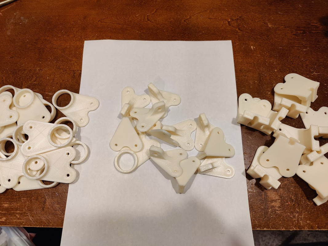

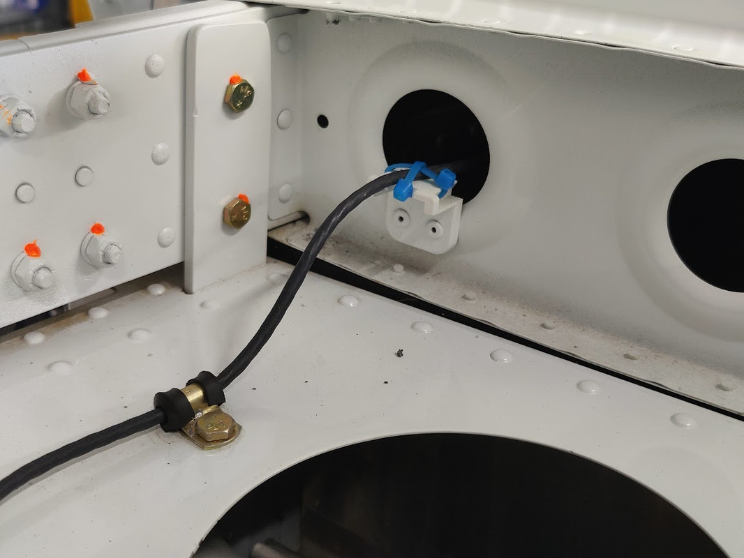

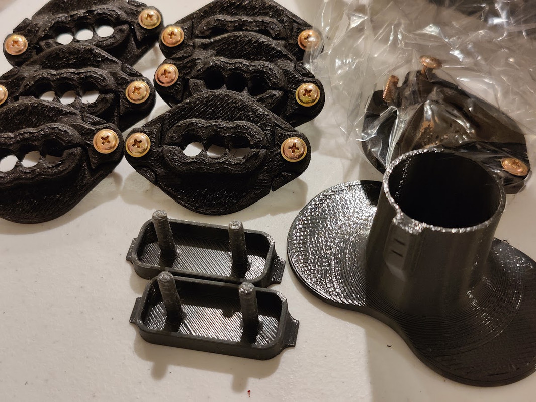

a busy printing day..... I don't print many of the 8 mm triple hole spark plug wire grommets, but I printed some today and a lot of other stuff.
basically, I come home, print some parts to make money to buy fuel and takeoff again.

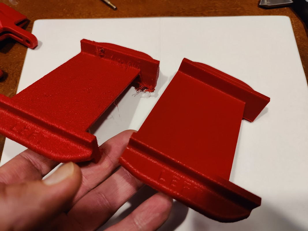

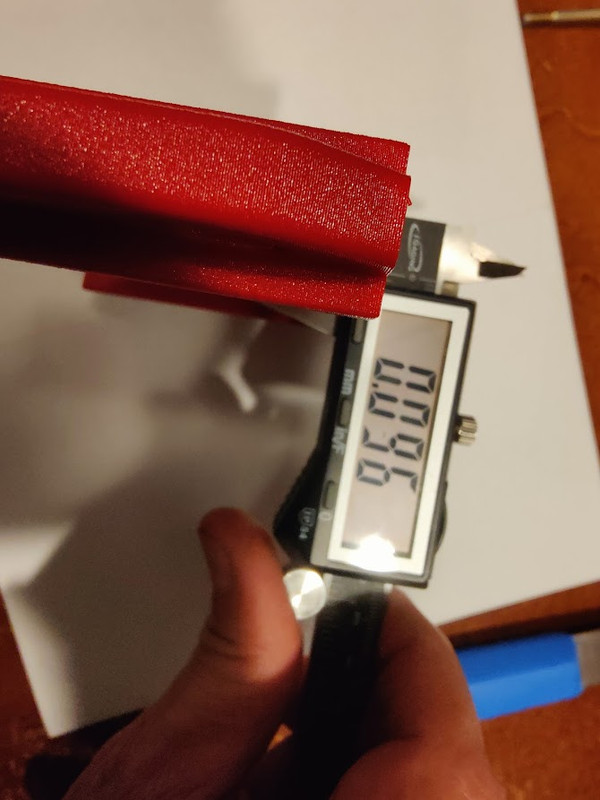

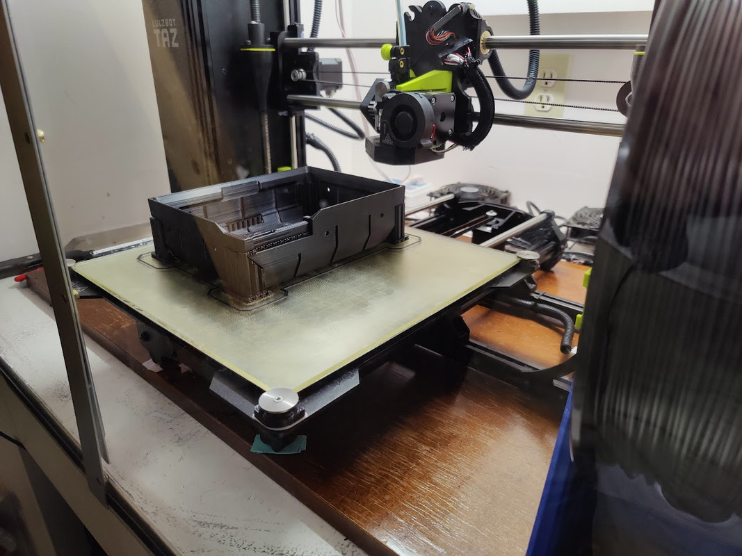

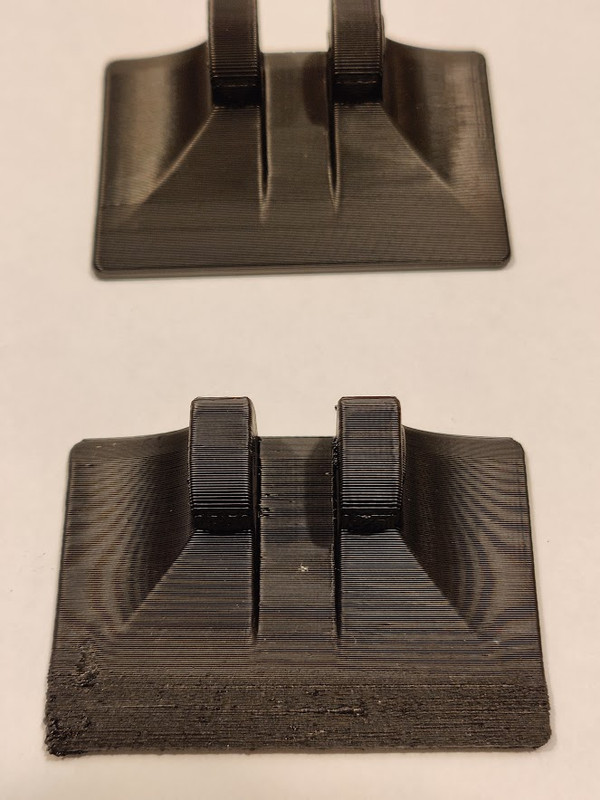

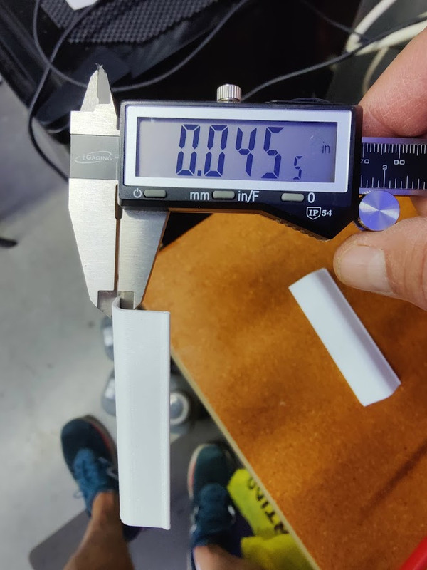

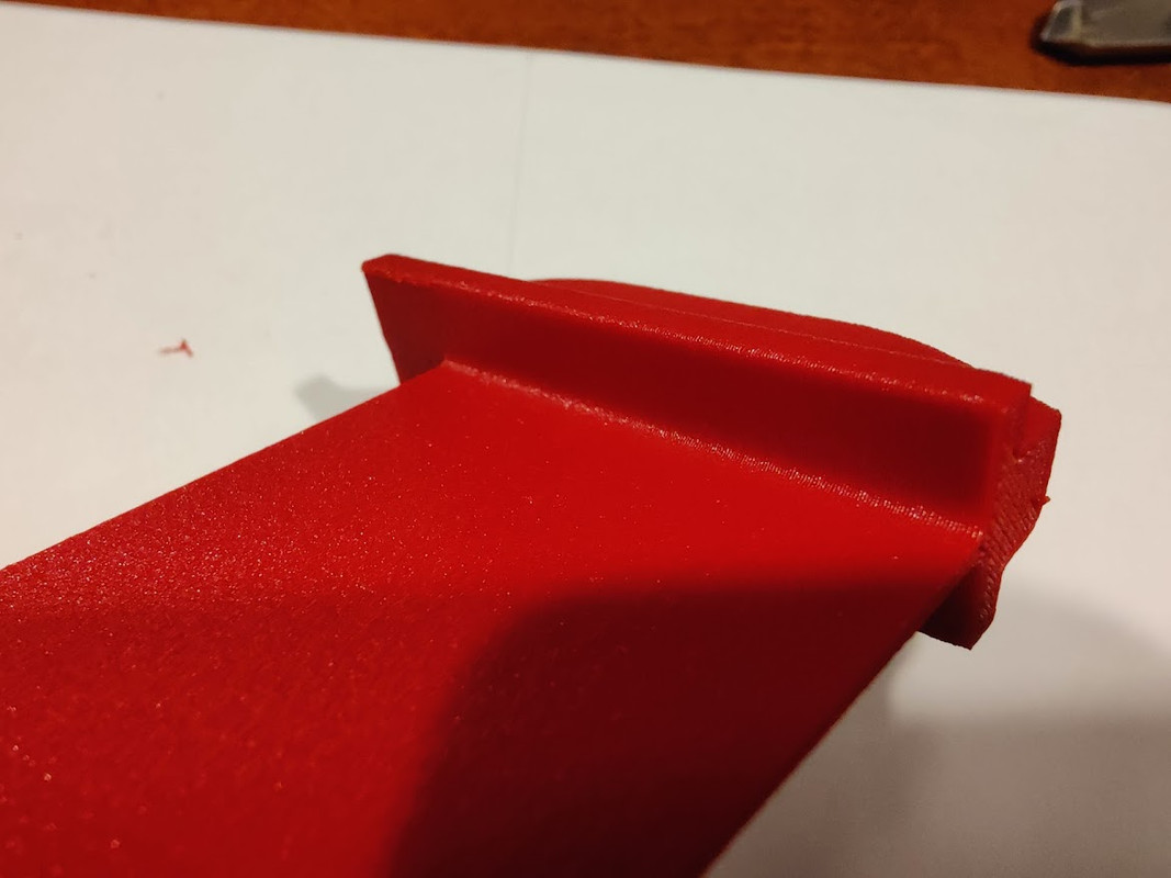

printing some gust locks and I had this bright idea to harmonize my printers so that I don't need to modify the extruder setting when I load a different tool head, but rather adjust the extruder setting in the print g-code. well, I missed this one (LHS) by 5% and what a mess. it shows how sensitive this parameter is. I corrected the number, and it is back to normal printing now. I made the web thickness dimension within .002 inch. material is nylon fiberglass.

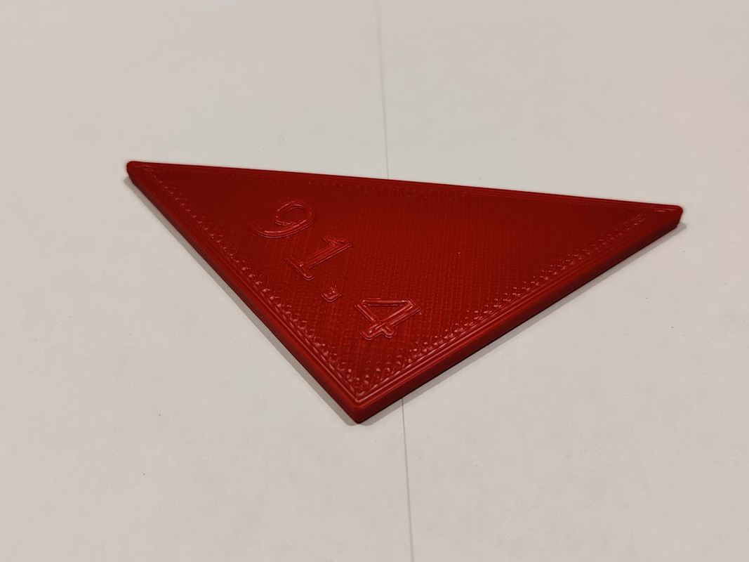

a quick little angle measurement tool for a guy.... maybe it is for the RV10 elevator? I made a new sketch.
link to guy on thingivers... https://www.thingiverse.com/thing:2980263

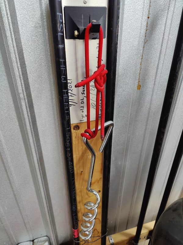

headset holder, mounted with 3M Dual Lock, going on 2 1/2 years. dog stake weight = 1.1 lb. scuffing the plastic seems to have made a huge difference.

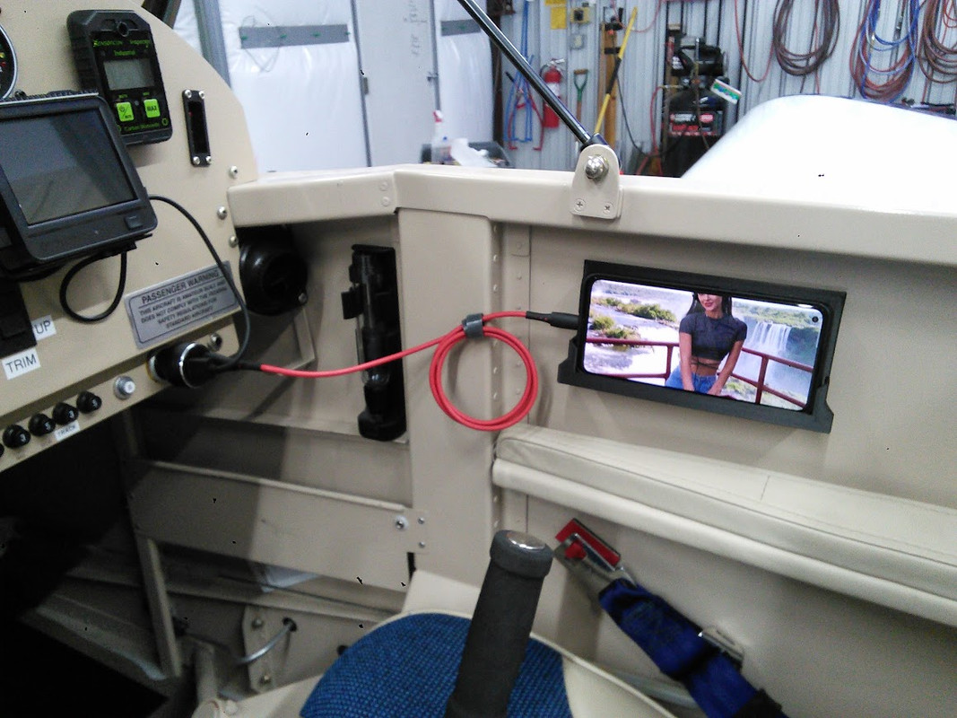

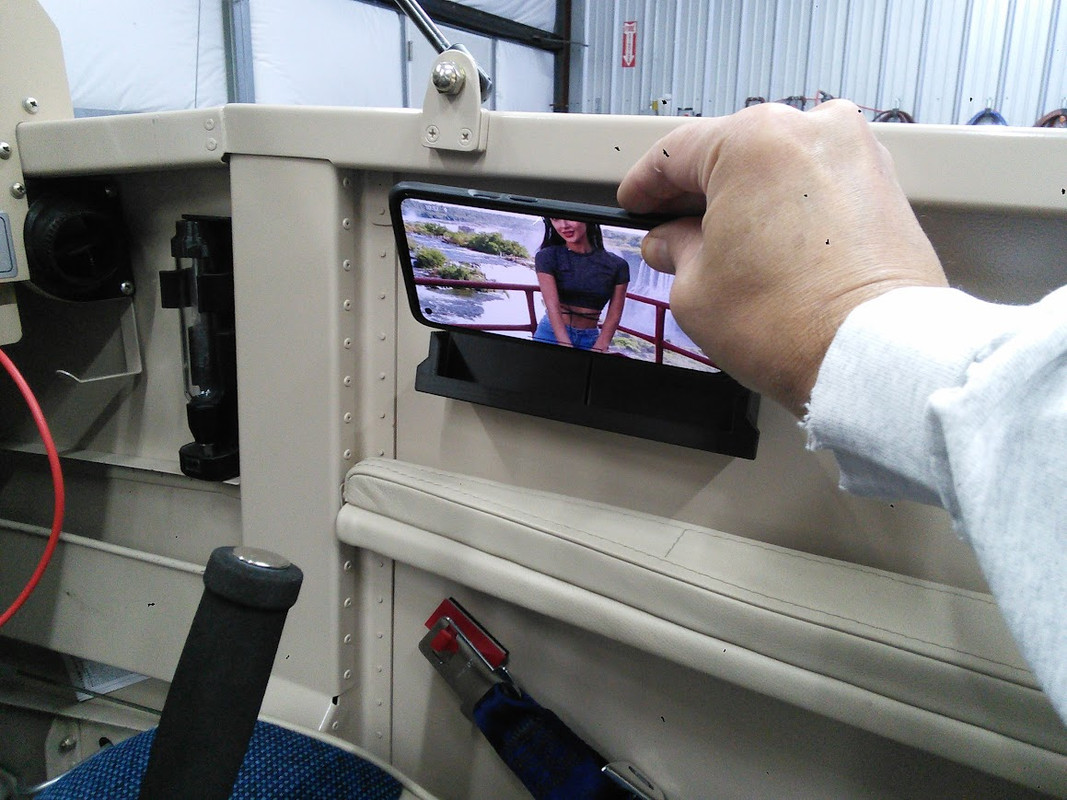

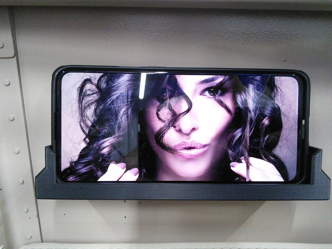

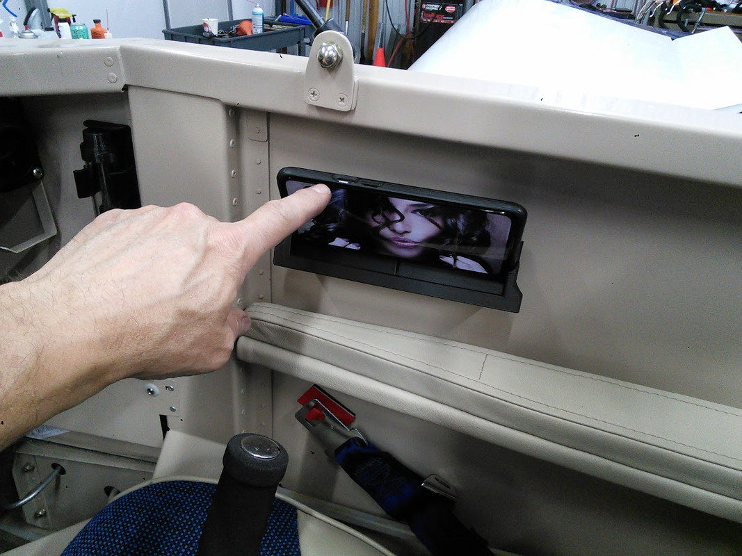

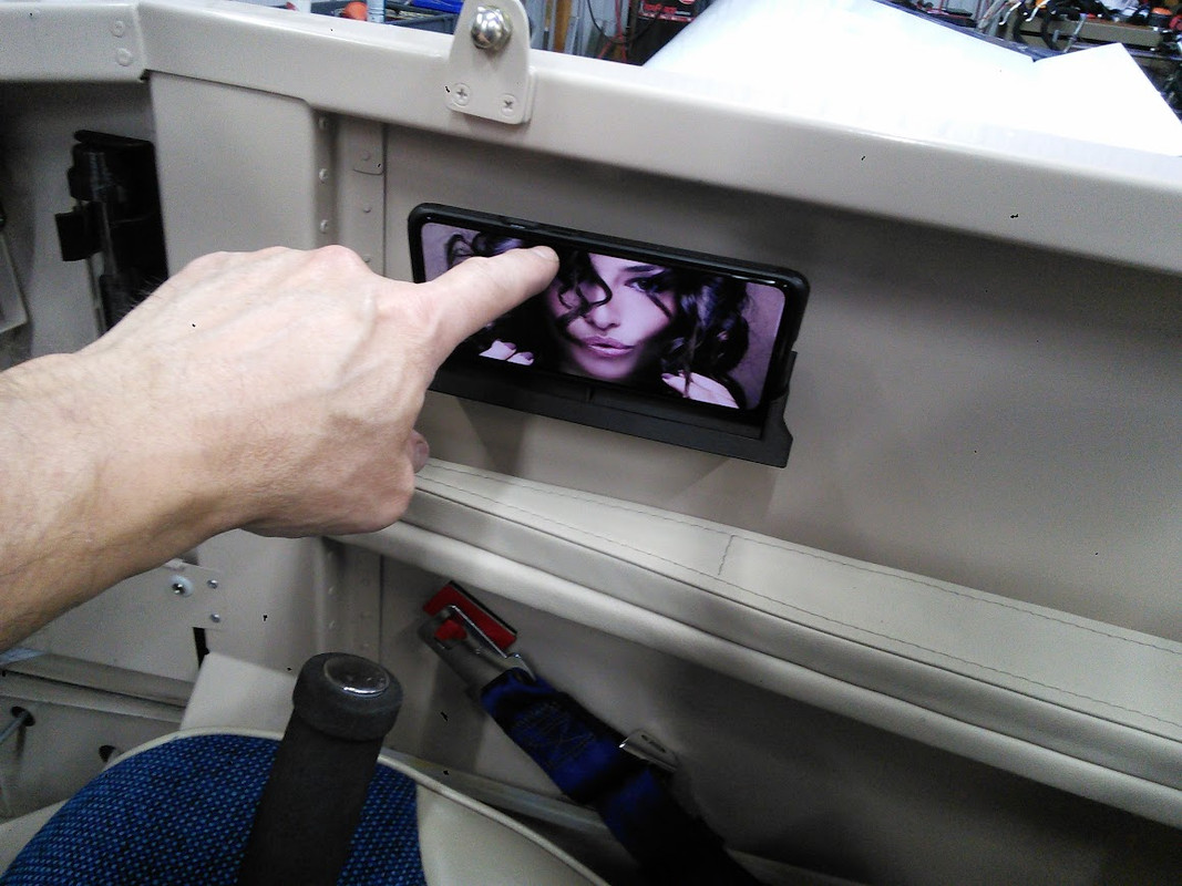

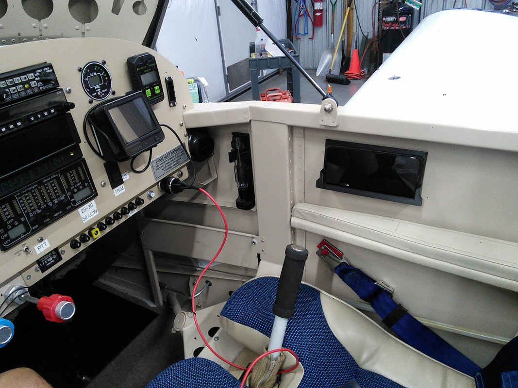

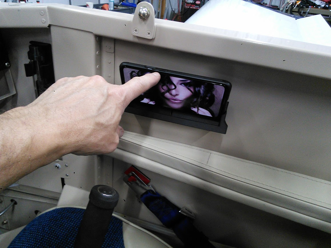

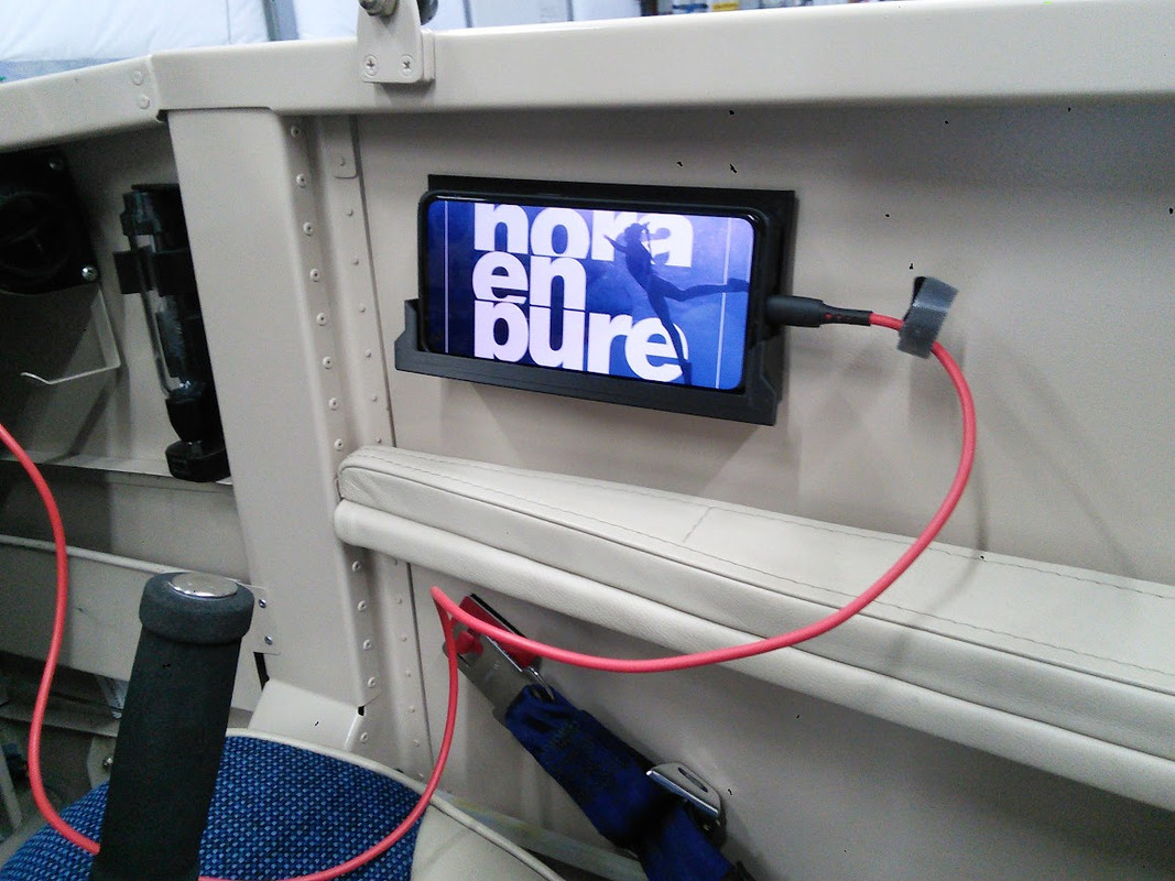

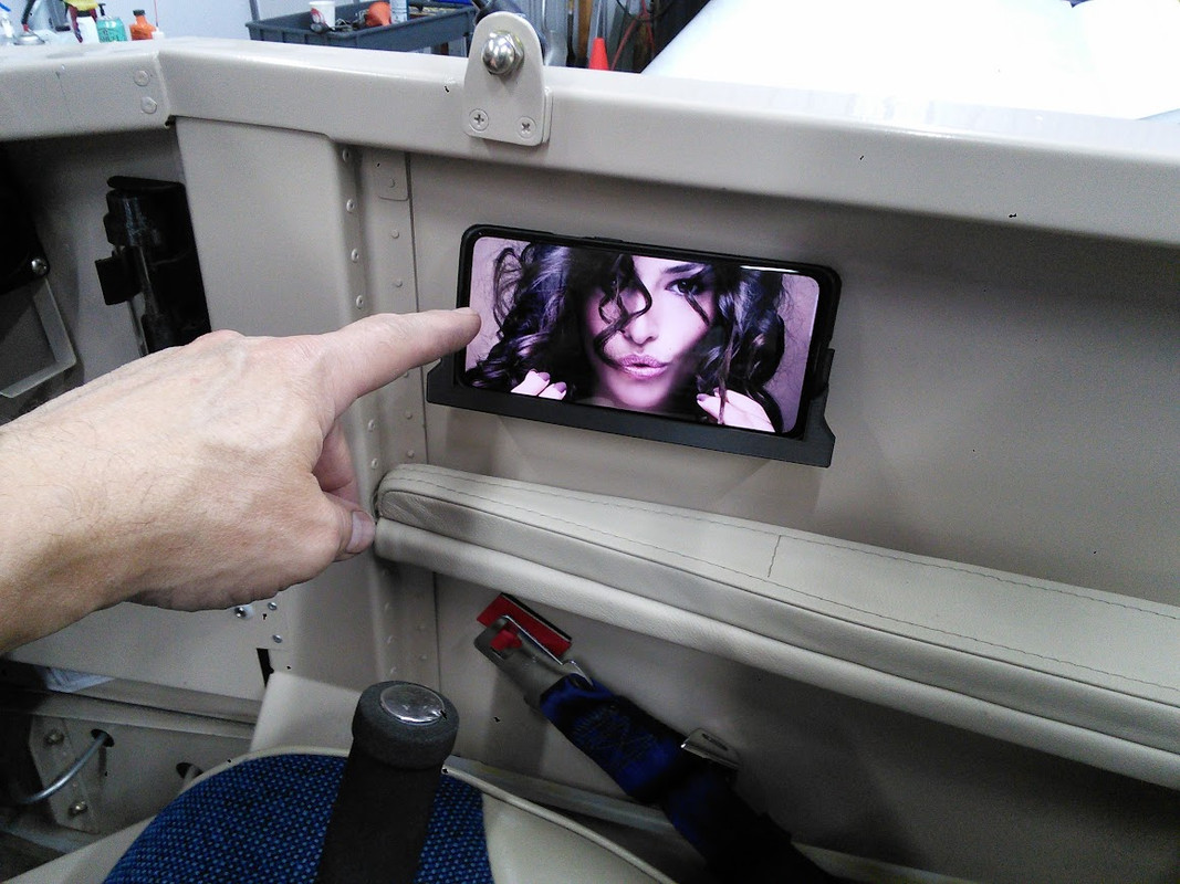

custom phone holder.... I've been printing a few of these lately, so I thought I should have one. I think this is the best location for me. it has some tilt back so I can actually see it. drop it in and go.
what about dancing girls as you fly? nah, that's too distracting. could I navigate my way home with this? sure, just take a left at the waterfall and then over the hill. :)
the question is: can this mount be smaller? I think so. I'll try something.

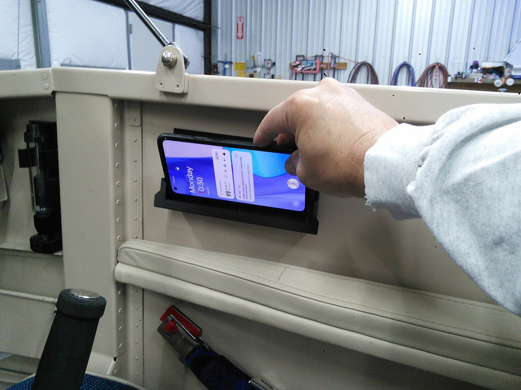

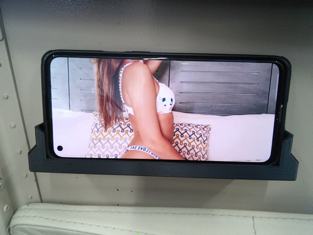

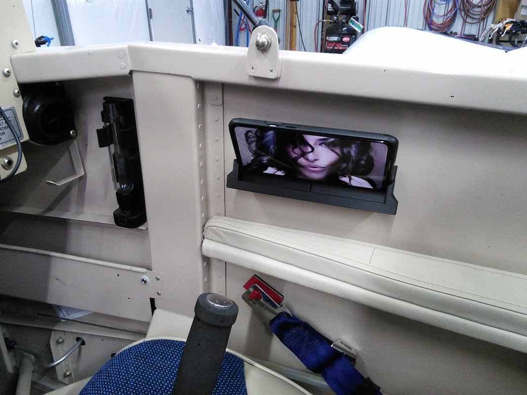

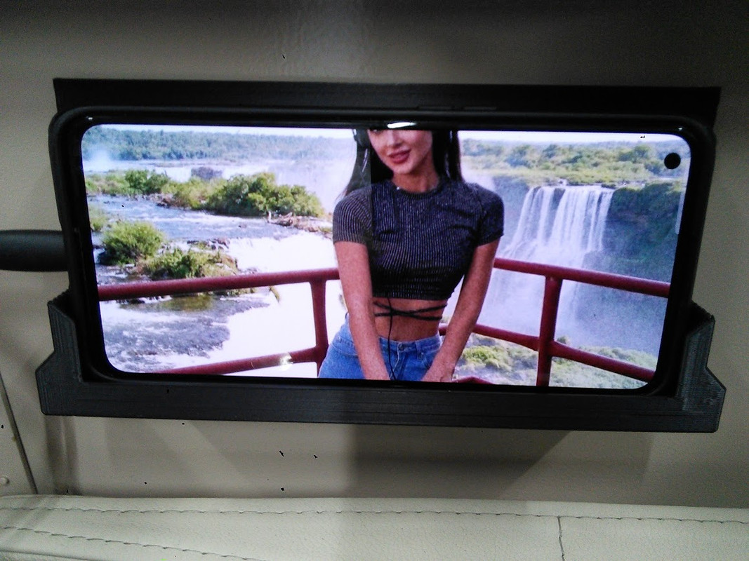

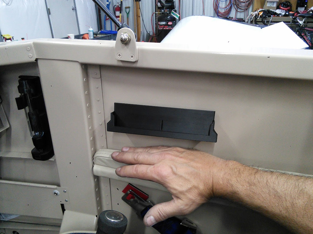

the battle of the custom phone mount design. this one is half the height but could be good. it has the same lean back or more. so, I don't believe turbulence will be able to dislodge the phone easily. the lean back causes some amount of phone capture for a vertical gust. recessed area for buttons, so no inadvertent button press.
Posts: 2028
I like the half height. more lean back of the phone with the 3M dual lock installed. yeah, I will probably be flying over your head with a hot chick by my side. :)

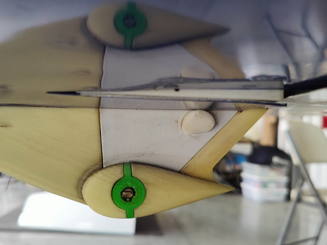

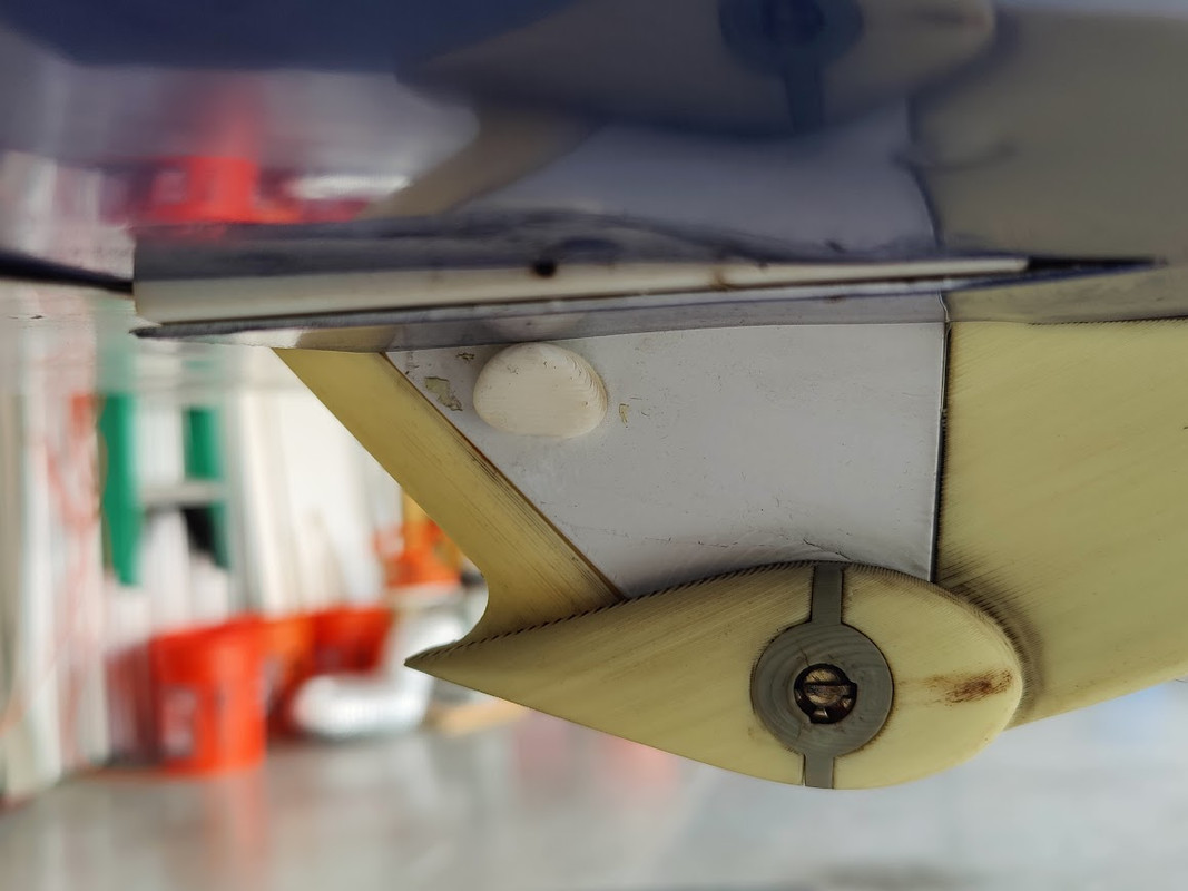

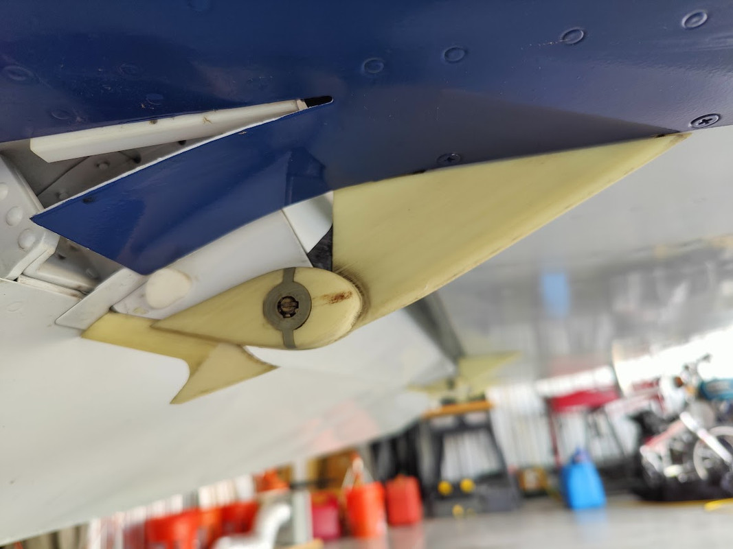

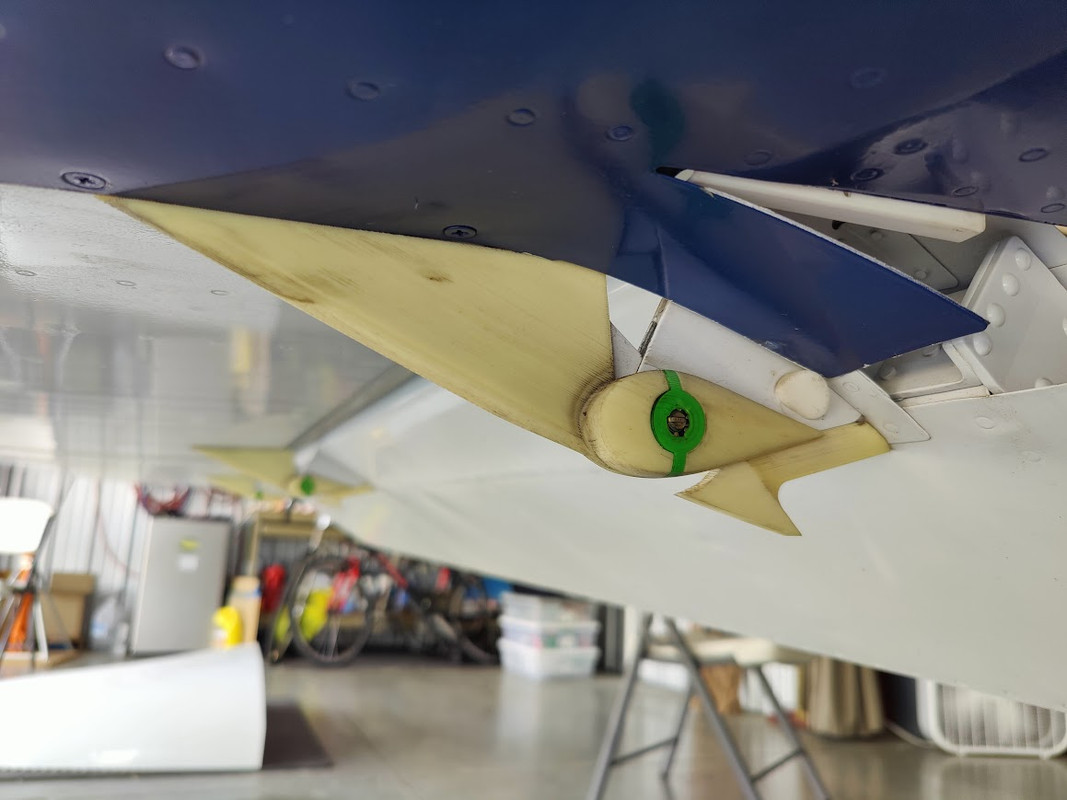

I have to admit, I haven't inspected these flap bracket fairings or the little button that pushes the flap cover closed in a year. they seem to be doing well. I think these flap bracket fairings are going on 5 or 6 years. I feel the need for speed.... :)

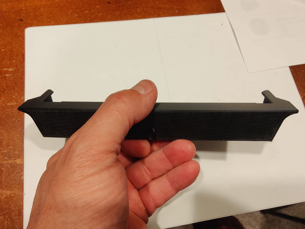

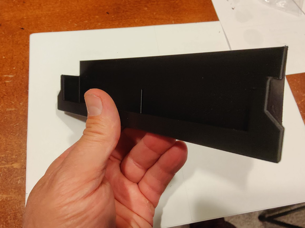

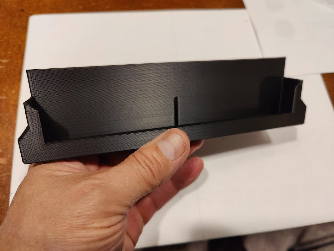

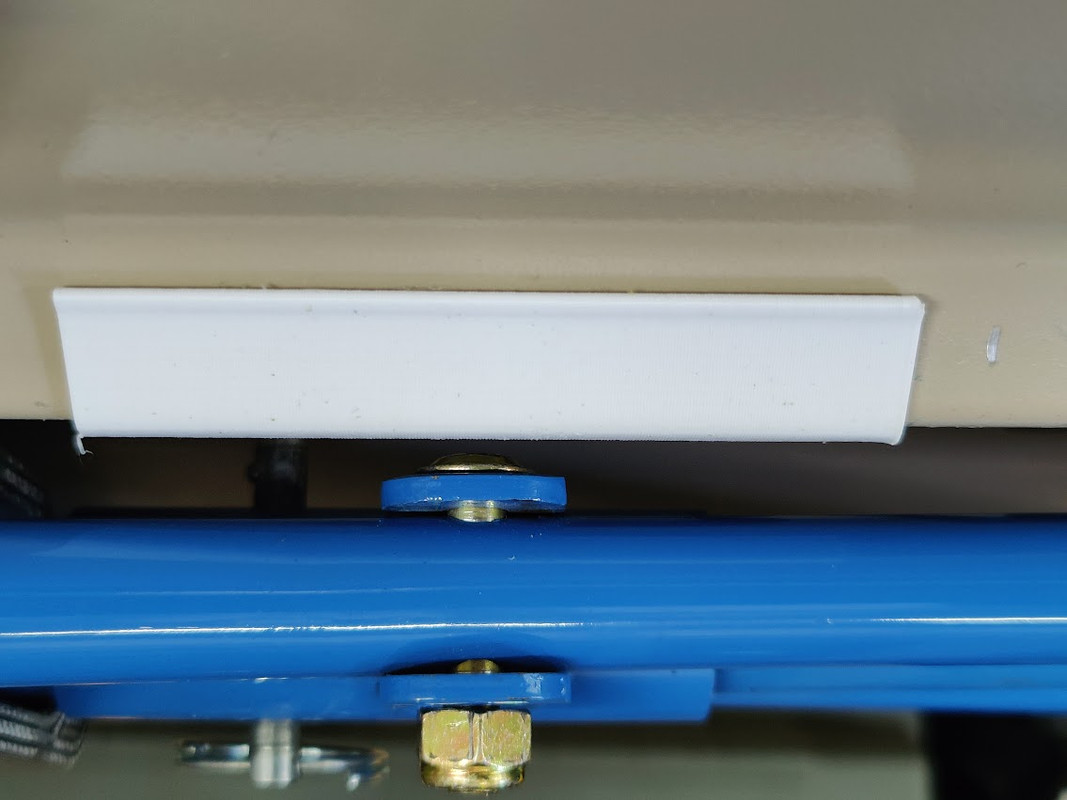

a couple of folks asked for these, so I made them available. a bulkhead ridge protector.
