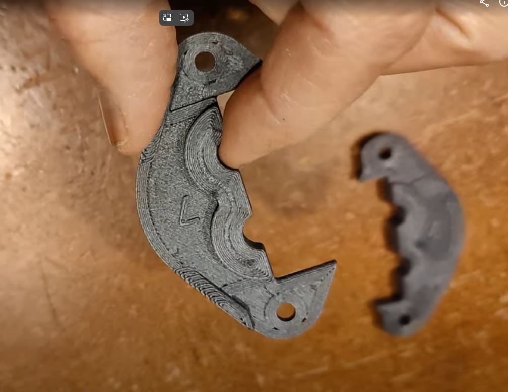

see and hear the part drop video.... sounds like metal

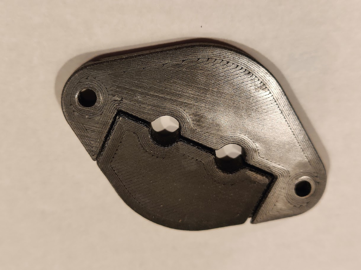

For no particular reason, I decided to turn the hose baffle mount into a wire seal. I was going to name it the El Grande Suprimo Wire Seal, but ended up calling it the 4-Screw Wire Seal instead. :) This one is polyphenylene sulfide material, rated for up to 350°F. Just another option.
Strong like Bull
For my aircraft, I use the El Cheapo nylon wire seals, and they’ve worked well, rated for temperatures up to 300°F.

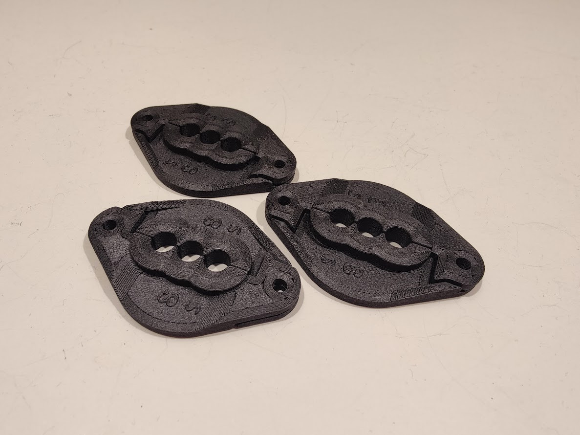

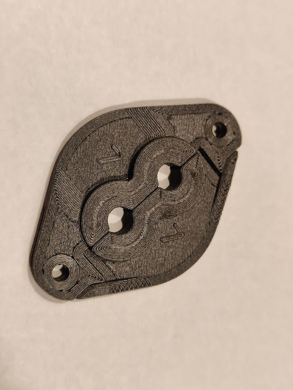

more baffle wire seals printed yesterday.... these are 8mm S (for Sulfide), three holes. very popular. turn up the heat!

I had run short of the polyphenylene sulfide 8mm, 2-hole baffle ignition wire seals, so I printed some more today. You can turn up the heat on these as they are capable, 350F. The "S" marking on these is for sulfide.

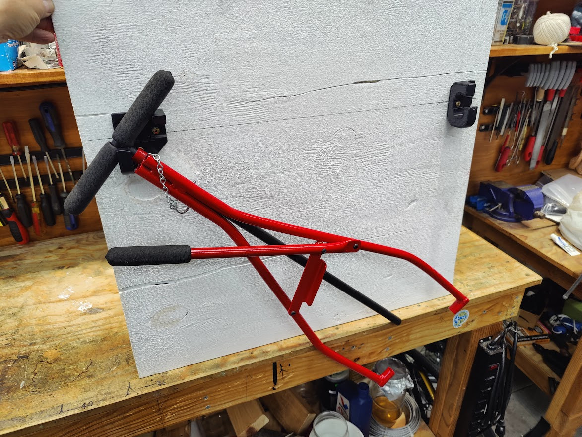

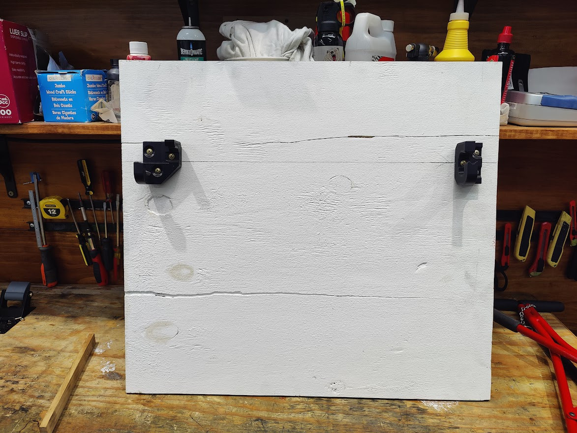

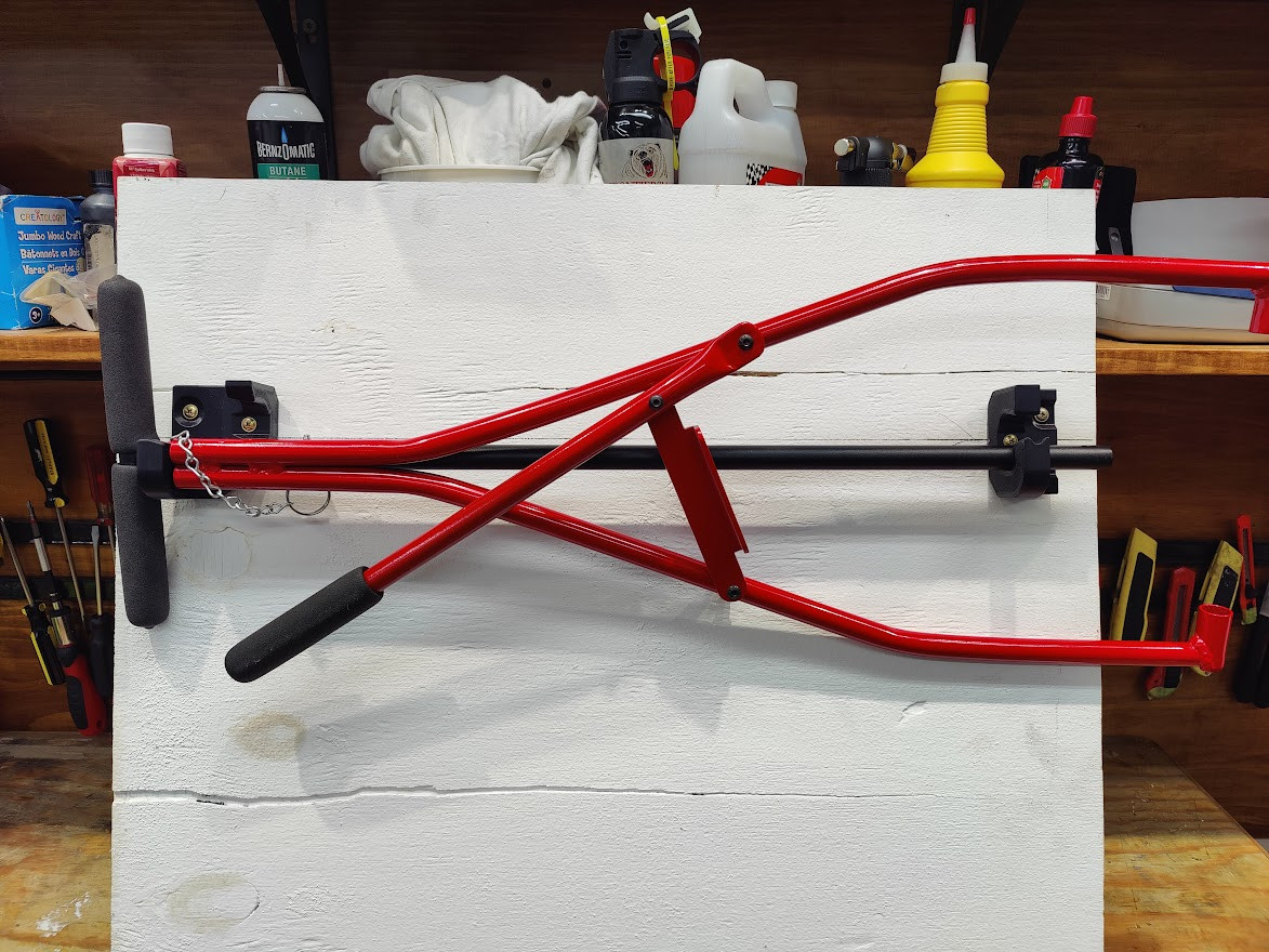

RV10 Bogi tow bar brackets testing. This tow bar mount requires to pins or clamps as it has self-retaining features...
This is coming along nicely. Overall, the shake test was good. At a -10-degree pitch with vigorous shaking, I was able to dislodge it. I'm adding some small feature adjustments (less than 0.1 inch) to hopefully improve that. Also, I'm modifying a cutout for better screw installation. The second print is underway, and so far, I am very happy with this as it is very easy to insert the tow bar.
Posts: 2242
Re: A couple printed widgets
The RV10 Bogi tow bar mount now meets the -10 degree pitch self-retaining feature with the latest enhancements. The tow bar can still be removed easily when positioned perfectly horizontal. This design is especially handy for the RV10, where access is tight and often requires coming through the door at an angle.

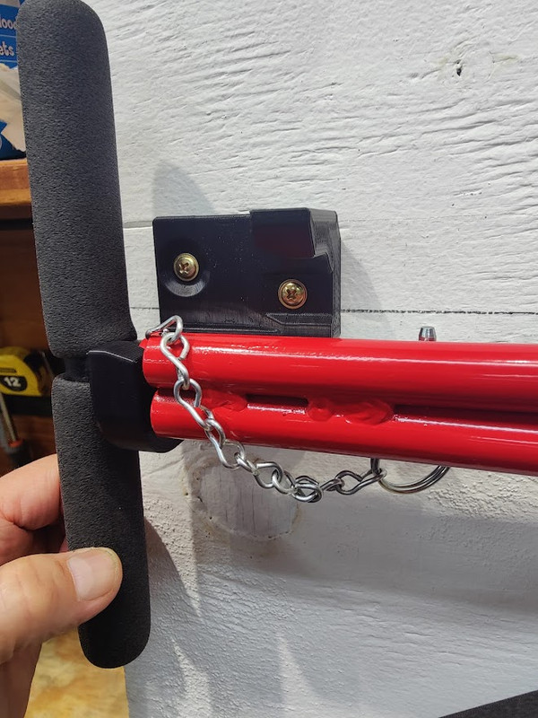

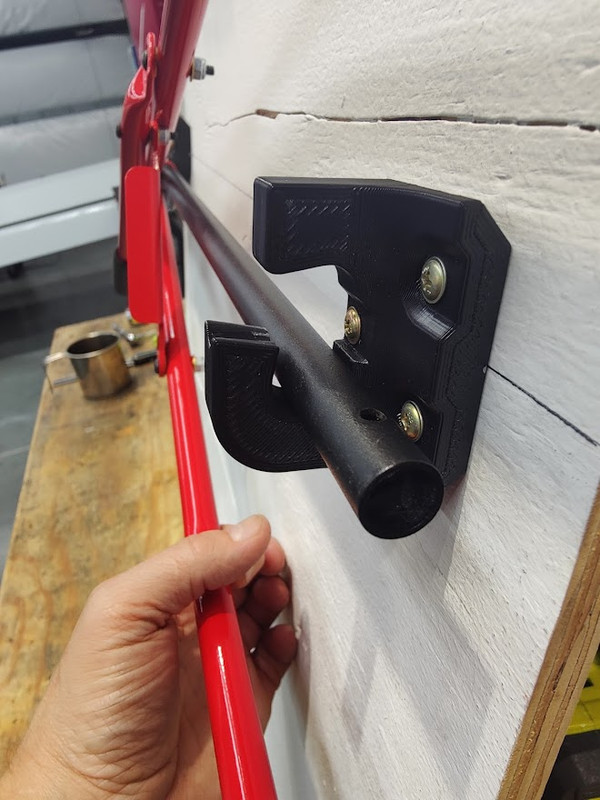

Posts: 2242
After shake testing, I could not reliably constrain the tow bar in the mounted position, so I took a different approach and trapped it. The tow bar cannot be removed in the horizontal position but can be removed at an angle. It is pinned on the right side. In the mounted position, the tow bar is secure. A bulkhead ridge protector may be beneficial at the lower right side. I also made a couple drill jigs for easy and accurate hole drilling. 3 holes per bracket. The quick release pin hole does not extend thru the bulk head but is trapped in the bracket.
The tow bar needs to be lowered 7 inches on the right side to remove it from the left-hand bracket.

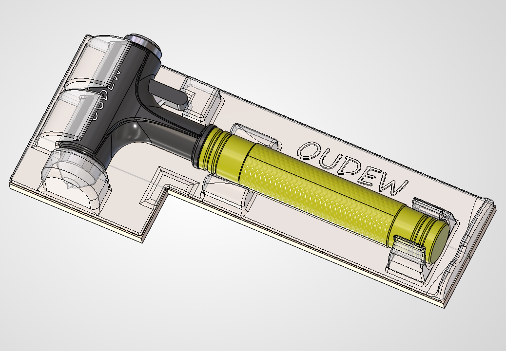

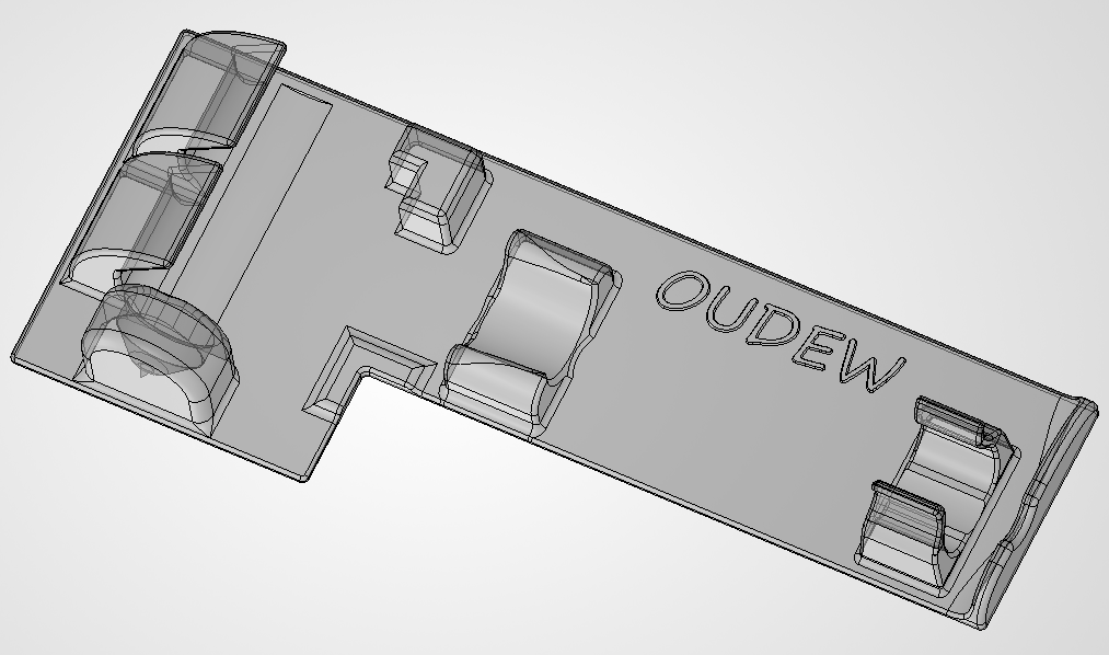

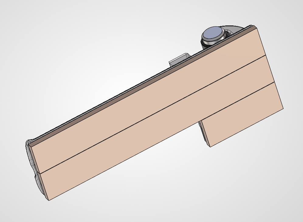

thinking about a canopy breaker mount. I still need to add the seat belt blade to this model.
Posts: 2242
OUDEW canopy breaker mount bracket.... to be secured with 3M Velcro Dual Lock. I'll print a couple of prototypes and then attempt a series of angled drop tests, hopefully up to 10 ft., or just throw it around the hangar. :)
