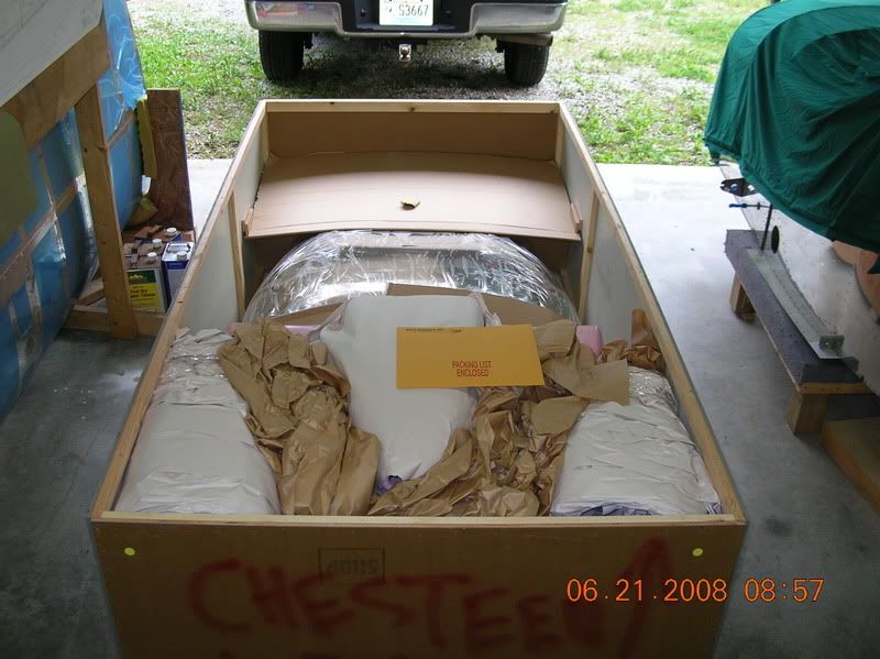

Partain's driver Bill delivered my finish kit today! He was great! Very nice person to deal with. Did exactly what he said he would do.
A good shout out for Partain and the service he gives to the RV community! The price is excellent compared to the large freight companies! The total delivery time is longer due to the fact that he must batch deliveries in a way that makes the most sense in order to make money but it is worth it!
ABF trashed my wing and fuse kits.. This time it was delivered in perfect condition and the driver said thank you!

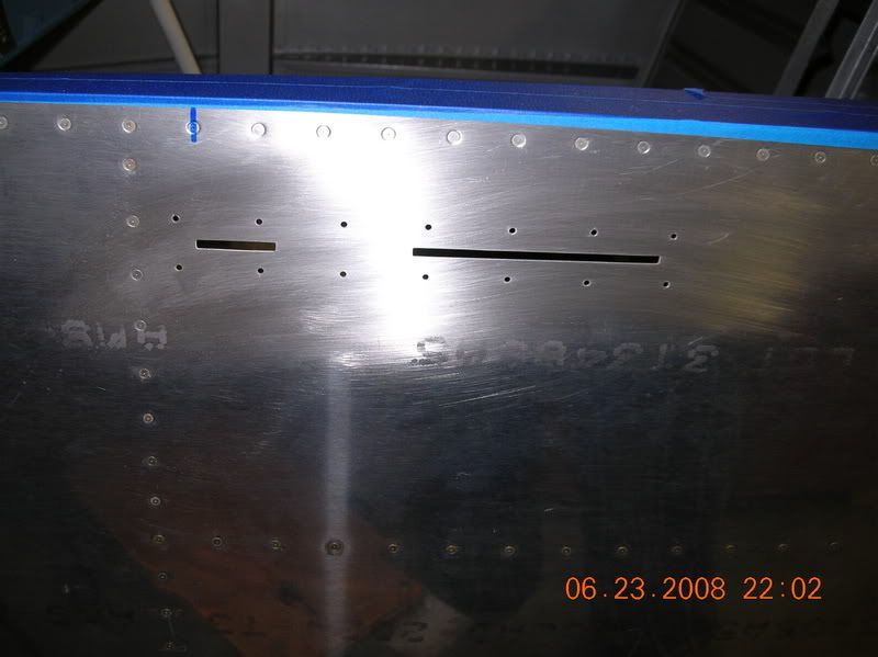

Tonight I will cut the latch mechanism slots in the sides of the fuse and get started on that stuff.

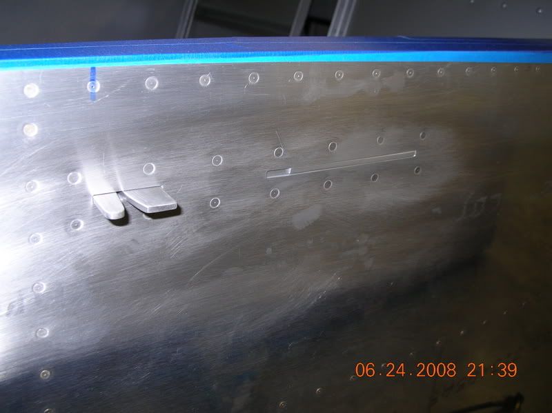

Last night I layed out and finished this little piece of the puzzle. This is a scary process because everyone will see this workmanship....

Anyone know why the little offset that sticks thru the long slot in the skin is cut back so far? Seems it would be better if it came all the way to the front of the slot.
I love how well the slot came out to match the thickness of the pivot arms.
After this pic, I installed the spring. With a little filing, it works perfectly. I think it was on Chad's site where I read that it closes and latches with a "satisfying click". Mine does as well.

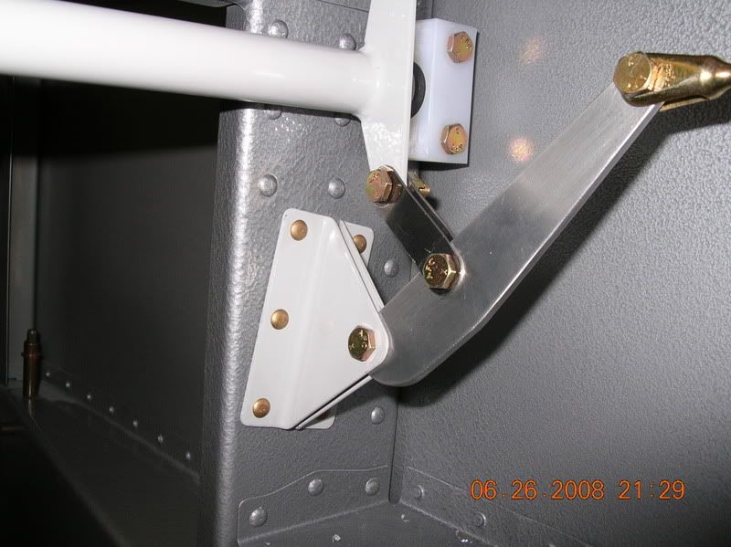

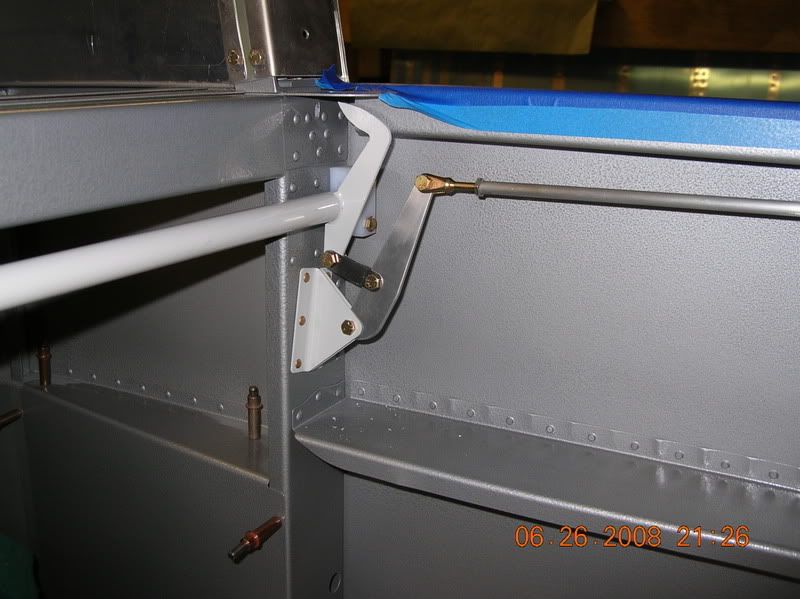

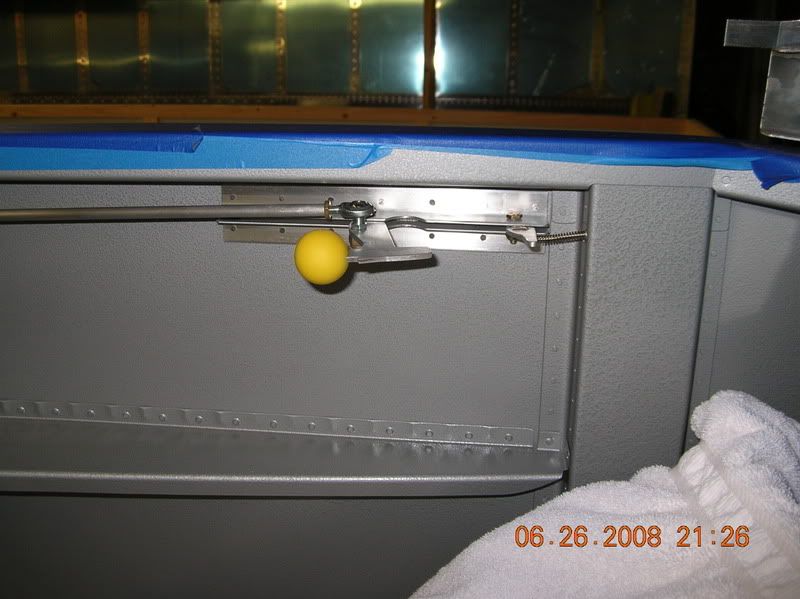

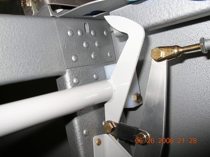

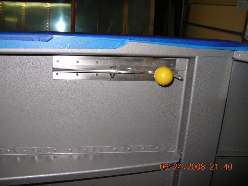

Got picture happy while working on finishing my canopy latch...
Who knows maybe this will help someone visualize how it all works. Pretty cool, simple but functional system if you ask me.
Here is the front end complete with the spring. The spring naturally wants to fall off to the bottom of the arm so I just left it that way. Still works fine so who cares.
Here is the rear business end of the latch. You will need a 1/4-28 tap for this and most simple tap kits don't have that one. The little link plates must be bent on the ends and twisted slightly. This is easy to do, just lay them against the arms and see what they need to line up
The latch in the open position..
And in the closed position..
More detail on the lower part of the mechanism..

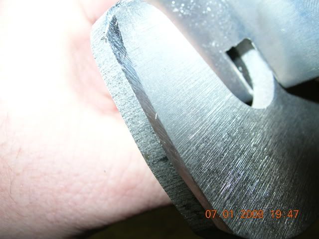

Sure wish whoever makes the steel weldments for Van's would debur them before powder coating them! The edges of the pointed parts of the latch weldment are very rough under the powder coat.
The last thing I did was take a file and file chamfers on the part of the latch handle that rotates, goes thru the two angles and sticks thru the side of the fuse. There is enough slop in this that when you rotate it, it can catch on the edges of the angle as it passes thru. If you tighten the bolt too much, it makes the rotation draggy. The chamfer helps a ton to lead the arm into the slot.

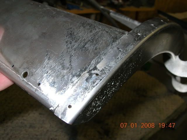

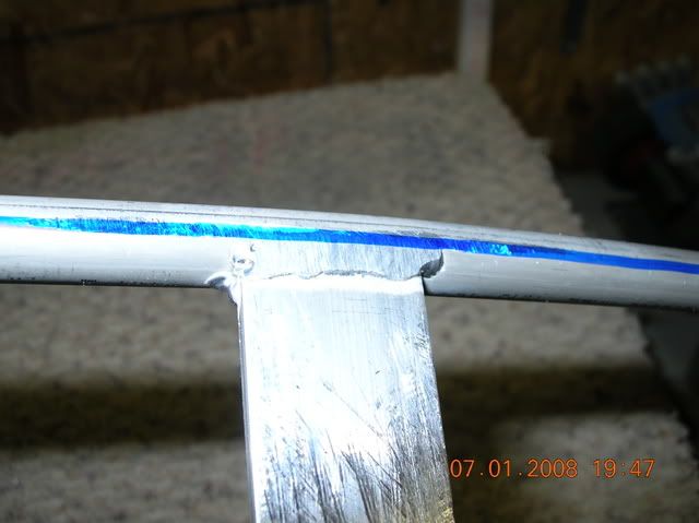

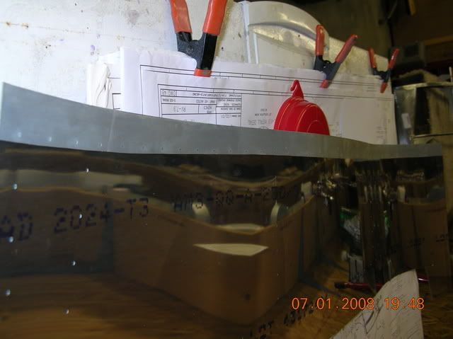

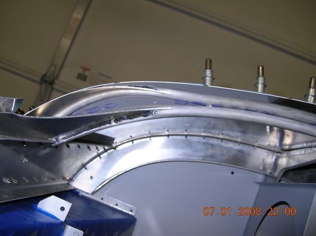

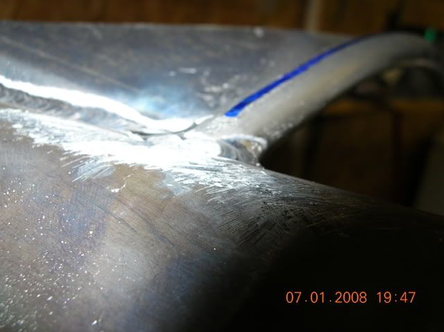

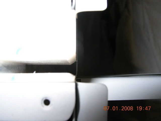

Got started on the canopy frame.

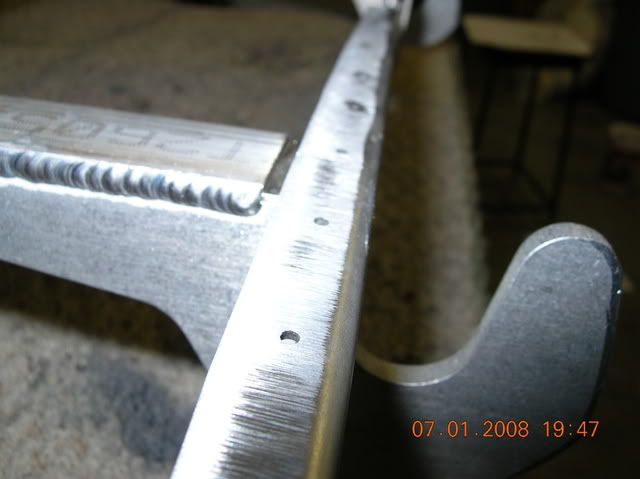

First taking the advice off several websites, I did some prep work to help with some known issues:
Chamfered the front edges of the hinge pivot spacers/bearings.
Chamfered the front edges of the hinges.
Filed down the welds on the frame weldment to the aft tube.
Squared up the frame ribs by sanding the aft edge.
Filed the bumps from the sides of the frame where they joing the front ribs. Filed another weld bump on both sides off.
Applied the UHMW tape to the front/bottom of the canopy skin. I purchased a 14' roll of this stuff from Van's and have used a ton of it for things like this and the seat back bulkhead.
Drilled the skin to the frame on all the prepunched holes except these were everyone has this problem. The left side has way more of a gap than the right. The left has a really wide gap!
And installed it for the first time to check the initial fit. Fits like crap... I can get it all the way forward but the sides at the front overlap outboard of the fuse by at least an 1/8th on both sides. The aft part is inboard of the sides by at least an 1/8th on both sides.
And the fun with the canopy frame begins!! :yay:
