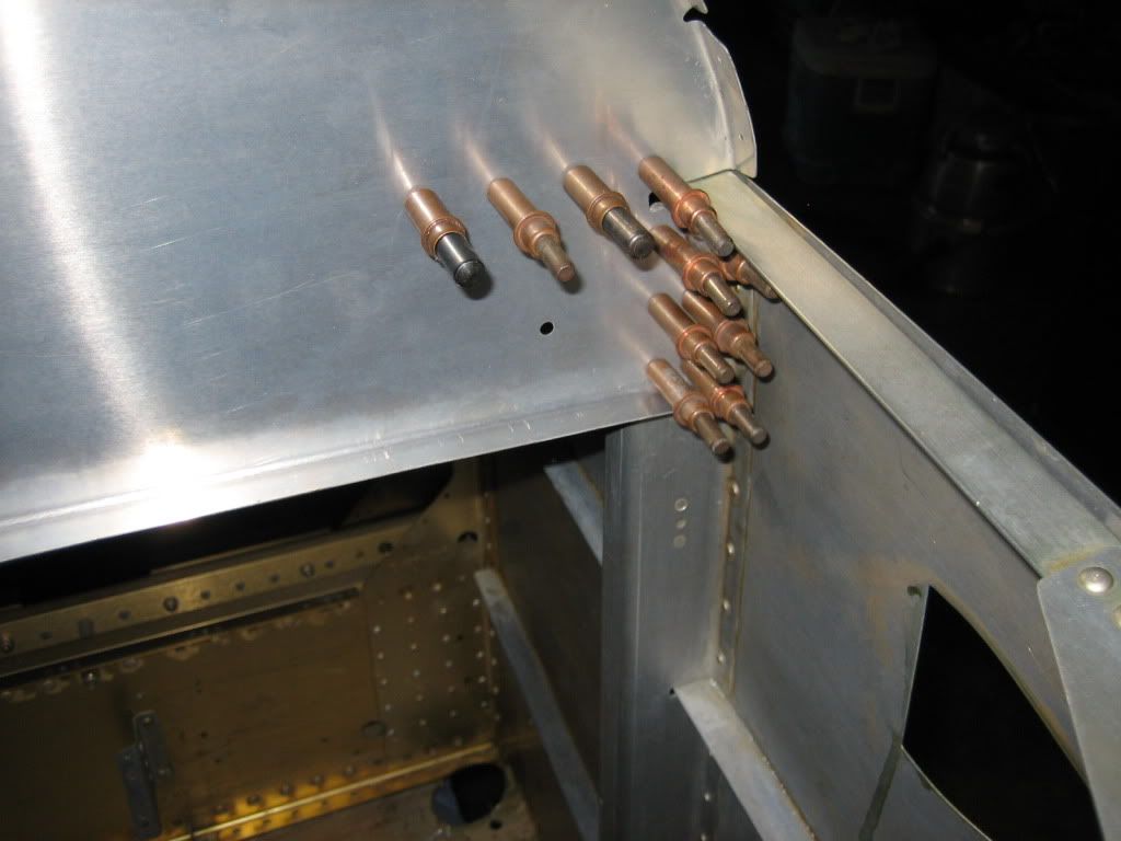

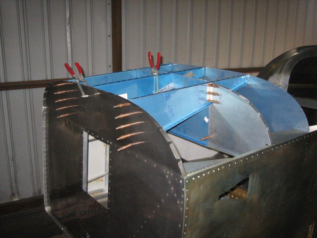

Hi All,
I am having a difficult time with this one. Trying to rivet the F-902-L/R to the F-715B-L/R panels. The inboard rivets are the particular issue. Is there possibly another way using pulled rivets or even bolts here?
http://i1137.photobucket.com/albums/n51 ... ump617.jpg
http://i1137.photobucket.com/albums/n51 ... ump616.jpg
thanks all,
Ed :bang:
Ed, I drove those with an angled rivet set and a rivet partner.
Alternatively I am sure that they could be cherry popped. I would do that before using bolts.
Try driving them the good old fashioned way! If that doesn't work drill them out and go to plan B.
TomNativeNewYorker
Posts: 439
Location: KSAV
Post by TomNativeNewYorker »
offset rivet set and another person on the bucking bar is what you need. one hand controlling the gun and the other holding the set so it doesnt spin to a less than desirable position when you blast the rivet.
http://browntool.com/Default.aspx?tabid ... ductNumber
Tom, that is exactly what I was thinking!
Thanks for posting up the link!
bruceh
Posts: 396
Location: Ramona, CA
Post by bruceh »
I was dreading this after reading the thread. Today I riveted my subpanel in and had no issues. I did have to remove the fuel vent lines. This made it easier to get the angled rivet set in there without the potential to mess up the tubing. I even had the fresh air vents and tubing in place. Started on the side rivets, then moved to the canopy deck rivets. Once the two side pieces were in I put the forward canopy ribs in place on the firewall. Finished up with the center section. Did all of the riveting solo, and for once I didn't have to drill out anything!
